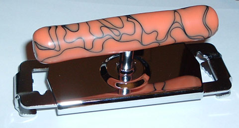

On the first one I did, I left a section of the blank on both ends and turned it between centers. After turning it to shape I left just enough at the ends to keep it turning and finishing most of the blank. I then turned off the ends and sanded and hand finished the small nubs in the end.
Trying to hold the blank in a chuck will only work if there is an area that will stabilize it in the jaws or if there are 2 areas the same diameter, such as the end and the middle. It is tricky and as you found out, dangerous too.
I modified my process and now drill from the end and use a metal rod to hole the handle on. The rod is inside the blank and I put a plug in the hole that matches the blank. I prefer to do these with plastic blanks. I'm thinking they will hold up better and they are easier to finish the ends.
On a side note, you will want to sharpen the teeth on the jar opener jaws because all of mine were too rounded to get a grip on the lids. I think they tumbled them too much and rounded over the points.
This is the last one I did.

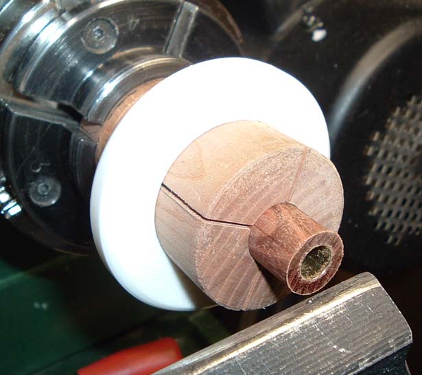

Another way to hold things like this is to make some of these wooden collets.
I have about 8 of them for large sizes from 1/2" and up.
They fit into my dovetail chuck and I have since replaced the plastic ring with a worm drive clamp. These are made from some scrap mahogony
To make these collets:
The blank is turned round and put into the chuck and turned to shape. Then drill the hole but not all the way through. Then slit the end but don't cut it all the way. Before you take it out to cut the slits, mark the wooden collet with reference marks so it will go back onto the chuck in the same position. I sometimes use a small thin piece of foam around the blank to prevent it from getting marked up but this kind of collet chuck is very gentle as it grabs a lot of the area and does not need much force to hole the blank.
This is primarily used to final finish something and not something to get harsh treatment such as turning down the blank.
