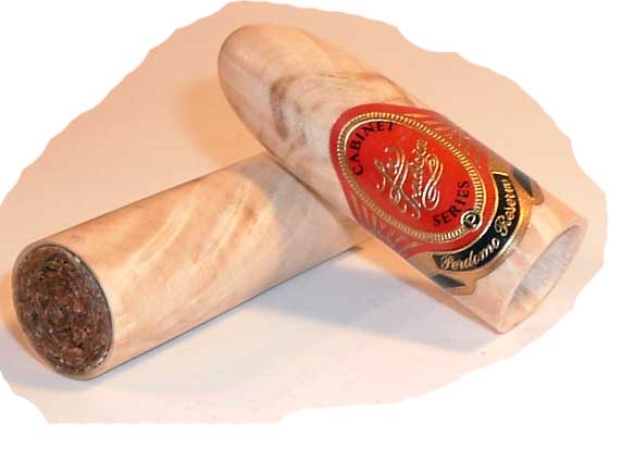

What's the OD on that thing? It has to be over an inch to accommodate the tube and some material on that surface?
I made this last week and used a 43/64 bit, turned it bigger for the sleeve and it ended up being about .812 OD. Would probably fit a 42 ring size but the length is only about 4.5" inside.
To make one for a #50 cigar, which is about the most popular size, the blank would need to be huge!
Someone once asked me if I could make one to fit a large ring size but I declined. Cigar holders on the market are typically metal but I have seem a few wooden ones. Sometimes they show up in the cigar catalogs as extra gifts with purchases.
