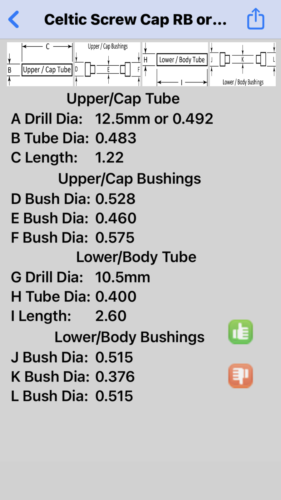

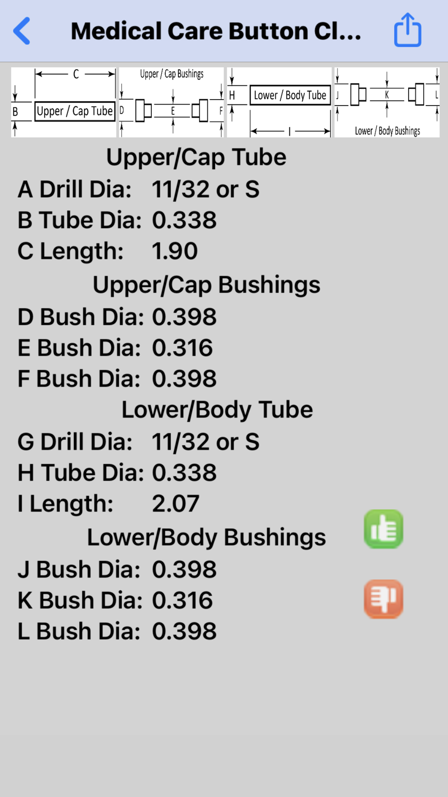

Okay, I just pulled up the specs for the Med Click and the Celtic cap. They are not the same.
The Celtic kit shows up in an app search for 73A because it uses a PSI273A bushing which is different from a Berea 73A. The app searches for any string contains the search term.
The best thing to do when doing such searches is to first search using the bushing number (73A) in this case, then tap on the Upper/Cap Bushings Header (or the Lower/Body Bushings header) to initiate a search on the bushing dimensions (0.398 0.316 in this case).
That second search will yield only one result.
