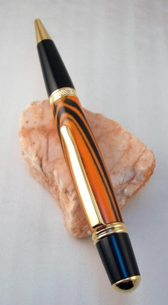

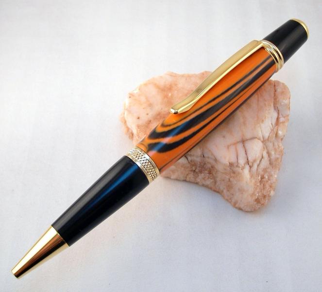

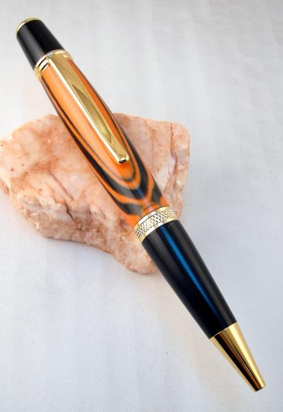

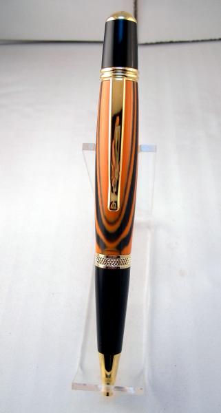

Bob, I agree with Jim; his advice is spot-on. I offer an example of a Sierra I did a while back. I followed the steps that Jim outlined and did not have a big problem with the material. My problem was that I did not have a thin-bladed saw (bandsaw), so my table saw kerf-cut took away some valuable thickness initially. I did have enough left over, though, for slimline applications.
Bill
