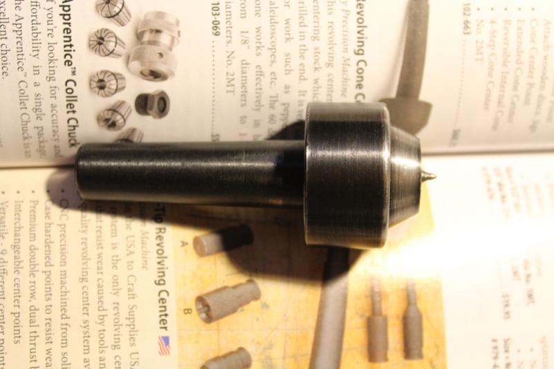

This is what I've been using in my tailstock. Pretty sure it's not 60 degrees, not to mention that it isn't capable of holding larger tubes...

No worries... that is a common mistake. Using that live center will burn out the tip in no time using a mandrel on it.

BUT, that live center you've been using is probably the main reason your mandrel is causing so many problems.
