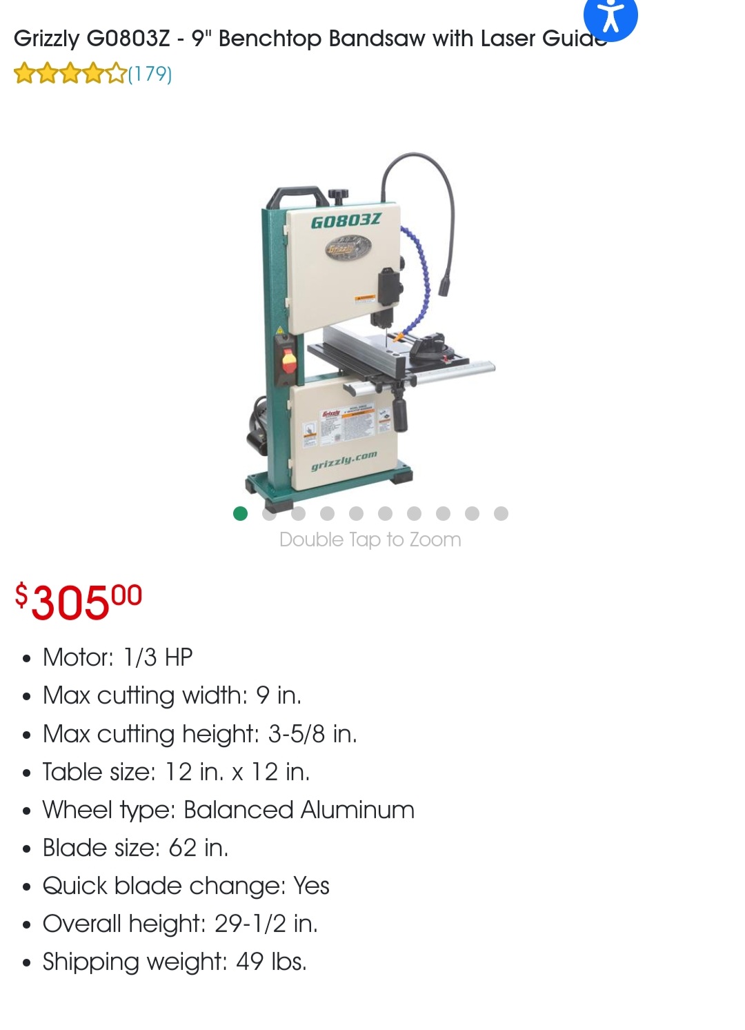

I bought this 9" from grizzly. I also was able to get a metal blade for it also as I cut bar metal for my knife guards. Works good.

I have the Grizzly G0803z 9in tabletop bandsaw. I set it up per Alex Snodgrass of Carter Tools and have never had a problem with anything I want it to do. You can view Alex's video instructions on You Tube it is a great and informative video on setup for any band saw of any size.
