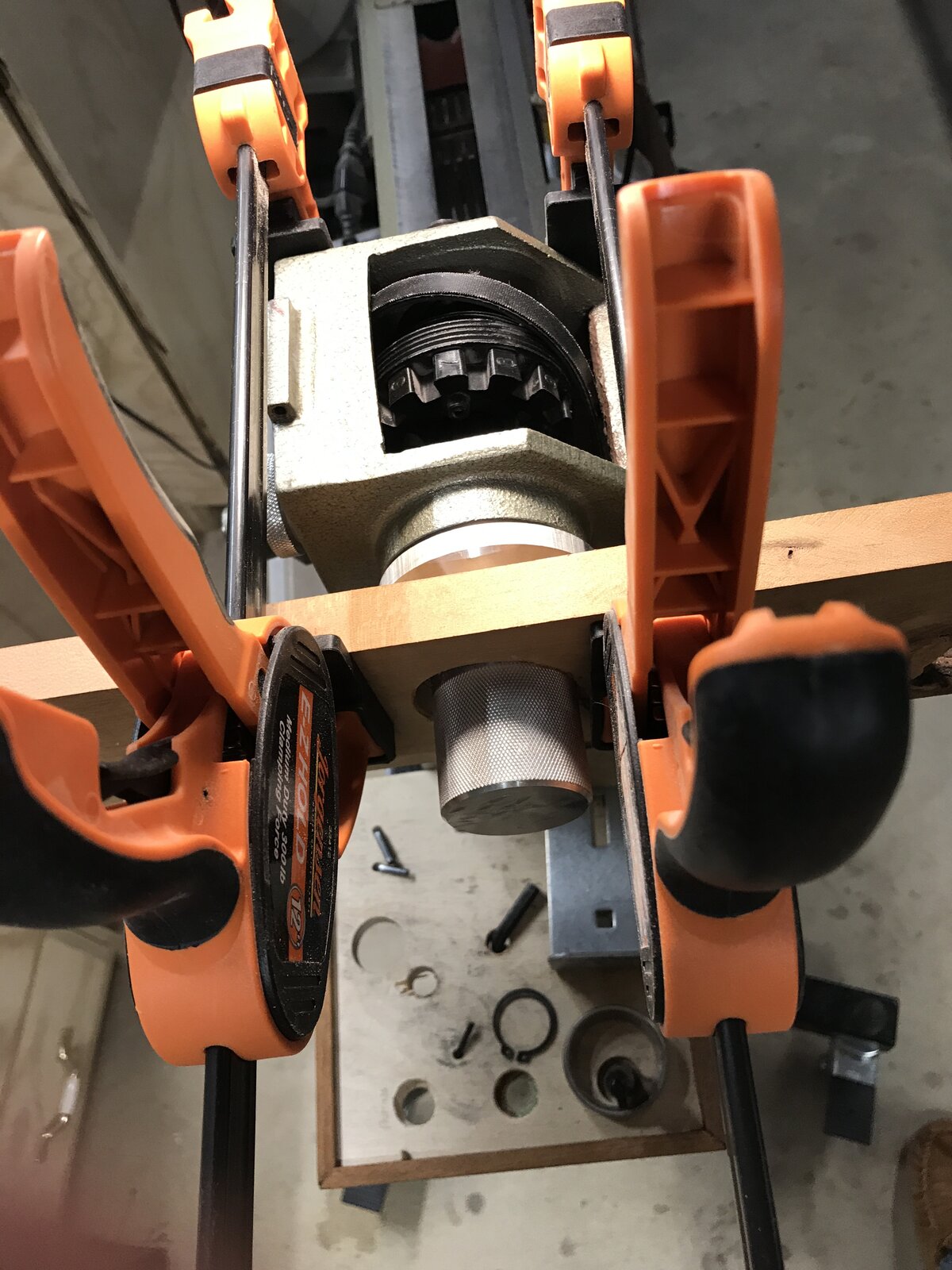

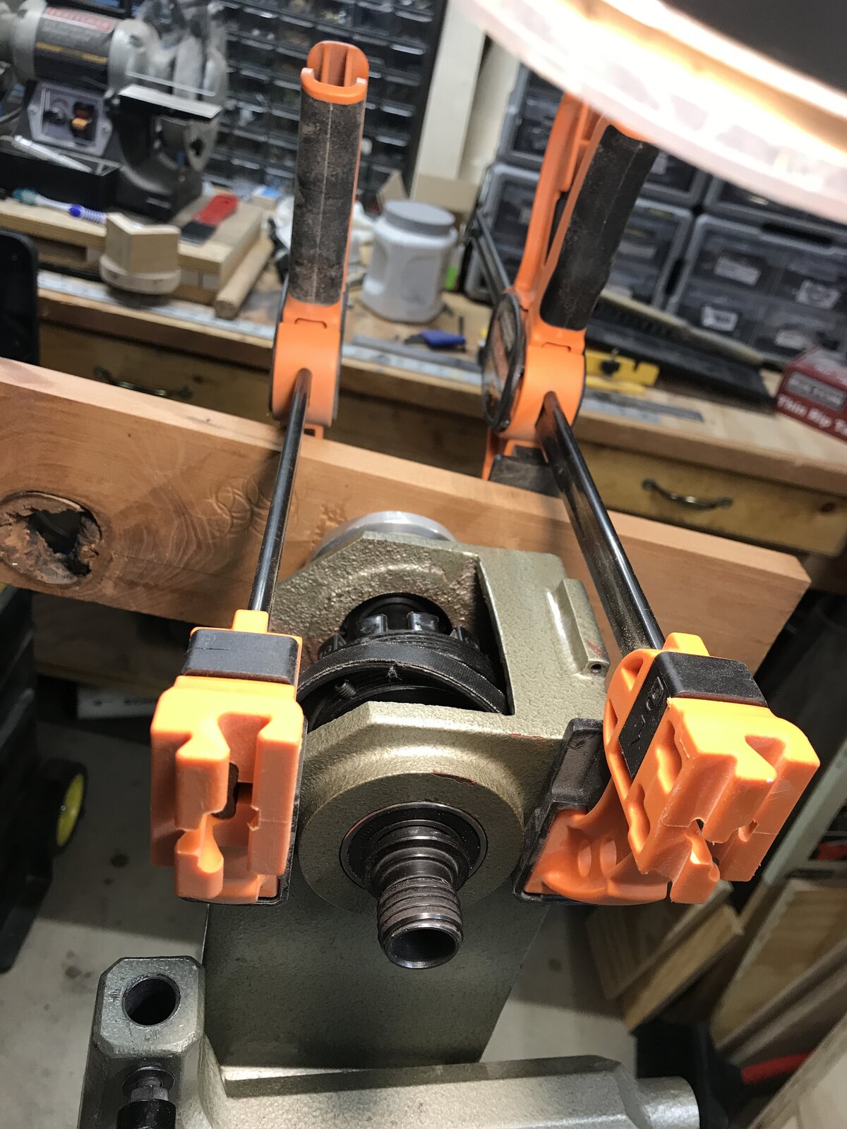

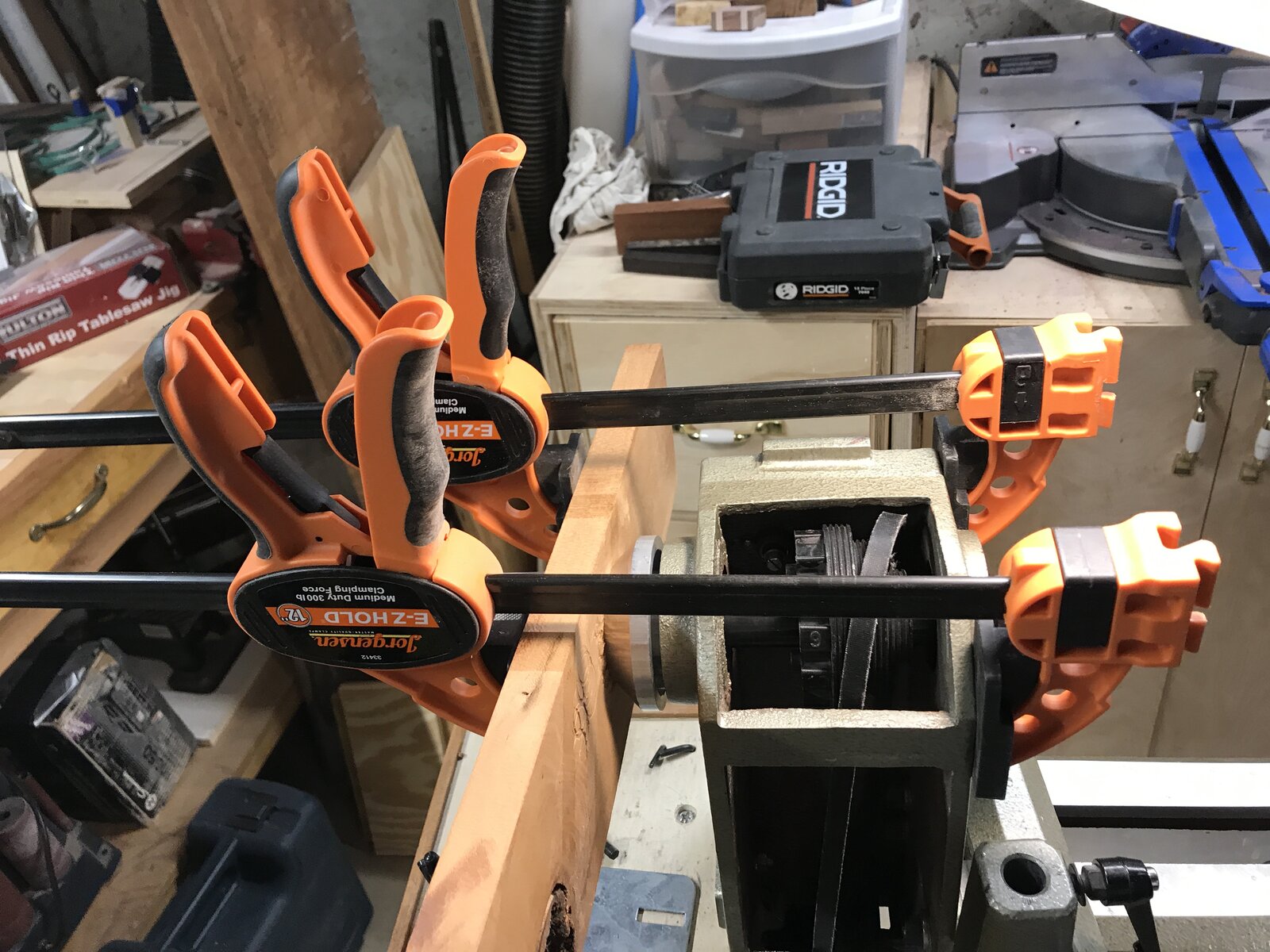

Just to close this thread, I ended up going MacGyver on my lathe. Nova Teknatool suggested I send my headstock to them and they would reseat the bearings, starting at $60, plus shipping. I decided to give it one more go.
I figured I needed to hold the left bearing in place while I tapped the spindle all the way home, so I used a hole saw to cut a hole in a board - I placed a rear-pinion seal installer (that was the same diameter as the bearing) up against the bearing, placed the board with the hole over the seal installer, and clamped the board in place. Then I was able to tap the spindle home, and the bearing stayed put. I snapped the snap-ring back on the left end of the spindle, and was back up and running. I may need to replace my bearings sometime in the not too distant future (they took a lot of "gentle" pounding with a deadblow), but now I have more confidence I can do this again. See attached photos.
