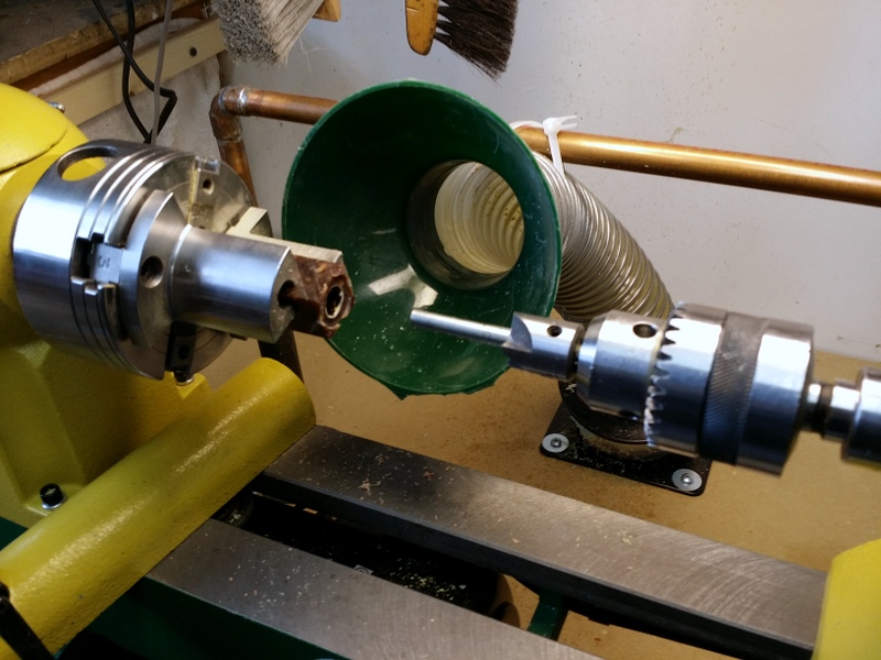

I have a similar setup to Dave's for squaring blanks.
View in Gallery
Jim,
So It appears as though you must just be getting it close initially when the blank is square, turning it down and then squaring it up at the finish. I see this doesn't eliminate the slow speed near the center but it must get the job done? what are you using to hold the blank in the chuck. Is that a drill? That may be just the short tem solution I am looking for.
How does the blank not being flush with the brass tube affect the bushings as they wouldn't have a flat surface to mate to when your first starting?
View in Gallery
Jim,
Most of the time I use a mill to square the ends before turning and then use the jig pictured to re-square them after applying finish. That is what you see pictured. However, I have a few times used the jig to square an unturned blank. I just use a coarser sandpaper. That is a drill chuck in the tailstock with a punch in it from the HF punch set going into the brass tube. It is perfectly square to the blank and has never failed me.
I use a pen mill with a 1/4" rod chucked up in my tail stock stock with the blank (wood or Acrylic) in a pen jaws. I do not use a proper sized shaft in the pen mill as everything is very stable. I usually square several blanks at a time. Quick and easy.

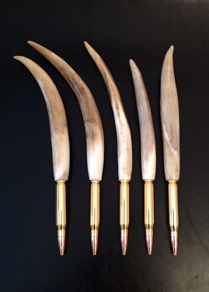

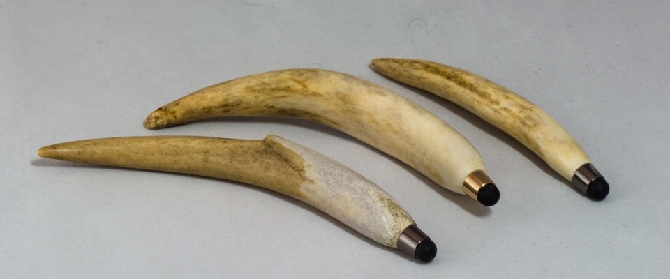

I have one of the small, inexpensive ones from eons ago (made by Delta, picked up at Home Depot for about $88)...has a 1" wide belt. I also recently added a beefier one from Jet that has a 2" wide belt (used it on some much wider pen bodies that were also antler).
I have the style of belt/disc sander you posted and I also have another style that I've found to be far more useful (the belt part is really handy for some antler pieces I've made that wouldn't work well on the lathe). Here's the style of belt/disc sander that I find much more useful for pens and a variety of other shop tasks (and it's within your budget):
Buy Rikon 1" x 30" Belt, 5" Disc Sander Model 50-151 at Woodcraft.com
That is a nice little unit as well. What do you find better about that style. On the belt portion is there a fence behind the belt to press against?
I always hate doing this because people are set in their ways. But I highly suggest skip this sander because the 1" sanding belt is very limited. You are better off with a 4" belt. More versatile. I have a Delta in that configuration and it sits under my workbench collecting dust. Been there done that. :smile:
:smile:
I have the Delta in the narrow config and use the heck out of it. The narrow belt is a non-issue since I don't use that for the ends of pens, I use it for shaping the sides when the pen style isn't something I can reasonably make on the lathe.
For squaring the ends, the disc portion of the little Delta (or the Rikon I originally posted) is plenty big enough given that pen blanks are typically 3/4" square and the disc considerably, even when sticking with only one half of it (the side headed down towards the table).
Having had both for many years, I find the little one gets used much more often. Depends of course on what kind of projects we each do.
I've enclosed a couple example of the pens I've done that are easier on the narrow vertical belt's unbacked upper portion (the curved tips make it impractical to turn these on the lathe):
