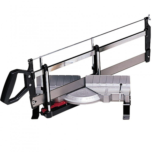

  • Nobex Proman Miter Saw is an acceptable, less expensive and more space saving option to a bandsaw. Requires elbow grease as it is manual. This is what I use, lacking space for even a small benchtop bandsaw.

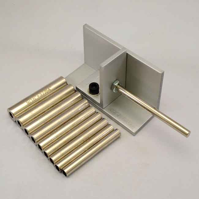

  • An option for holding blanks to be drilled is: https://www.arizonasilhouette.com/c...arch_Begin_Only=&sort=&range_low=&range_high=

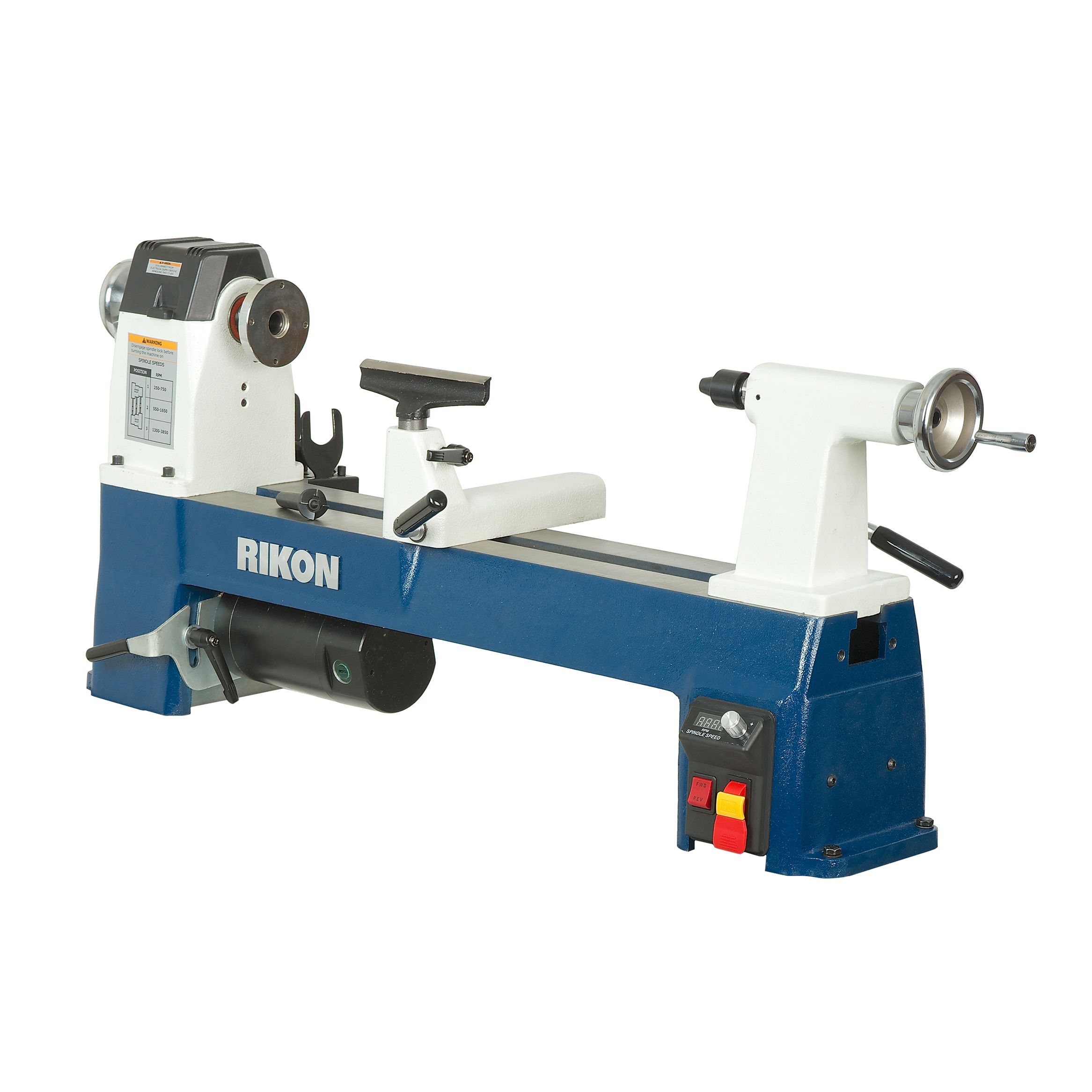

Hi there! From what you've described, I'd recommend this 70-220VSR lathe from Rikon:
I have smaller minis and full sizes, and this to me is the sweet spot for making pens. I've actually purchased four of this particular model myself (two for me, two for gifts) and have never had any problems with any of them (they get a lot of use)
But I think the really important part, as mentioned above, is to have a variable speed and the morse taper 2. This lathe satisfies those two requirements, as do many others that people will invariably suggest :)
