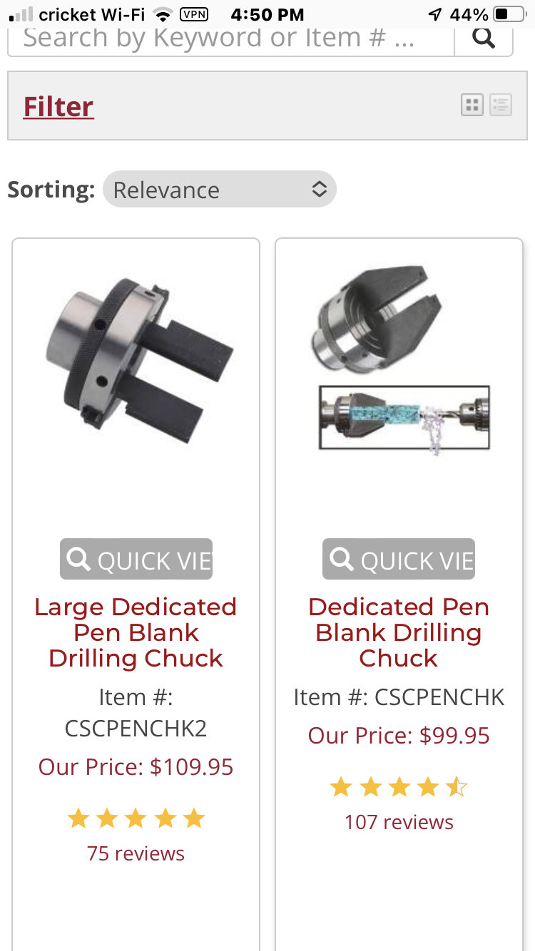

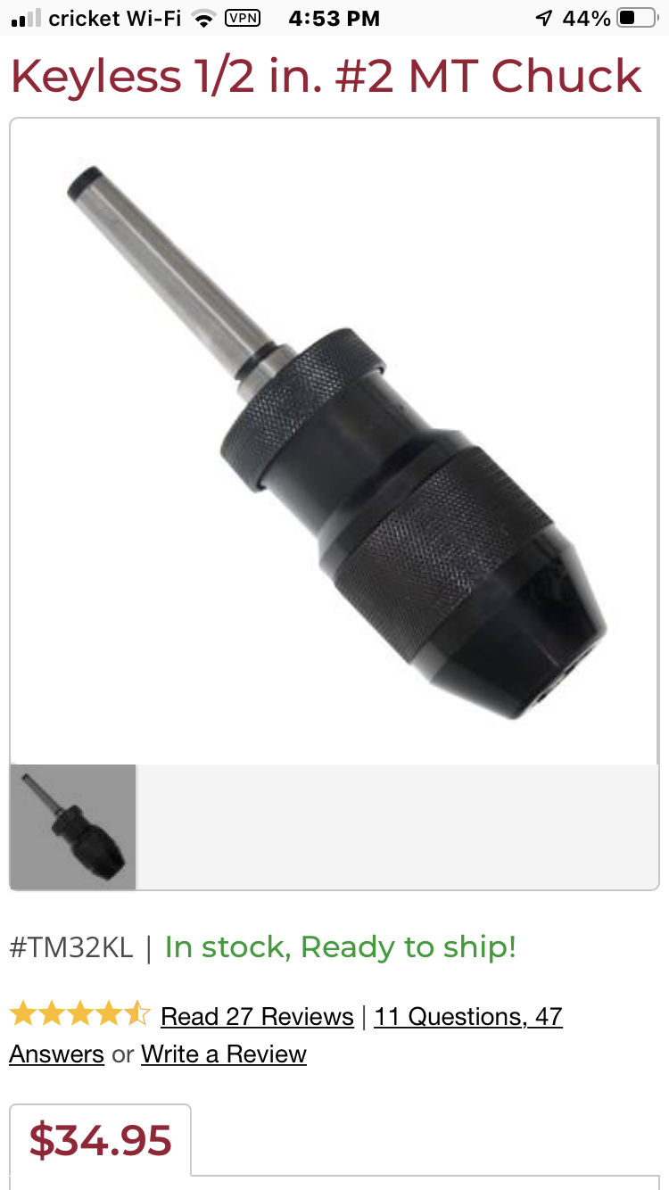

You have most everything. Instead of a drill press I'd recommend you drill blanks on the lathe. You need a chuck for the headstock and a drill chuck for tailstock. The tailstock chuck can't be live center.
I'll include links for those items.
I'd call PSI to be sure chuck isn't a live center. https://www.pennstateind.com/store/TM32KL.html
