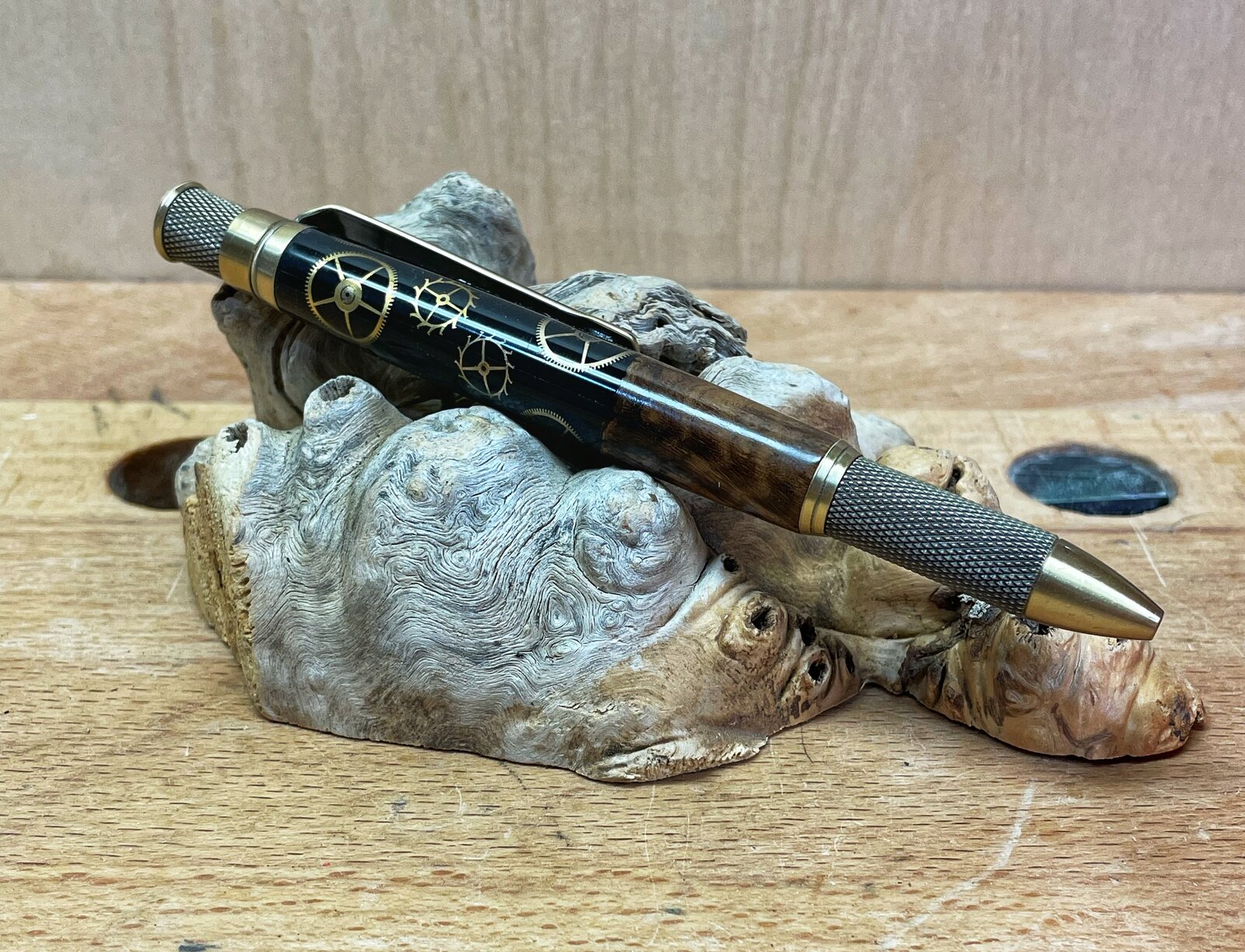

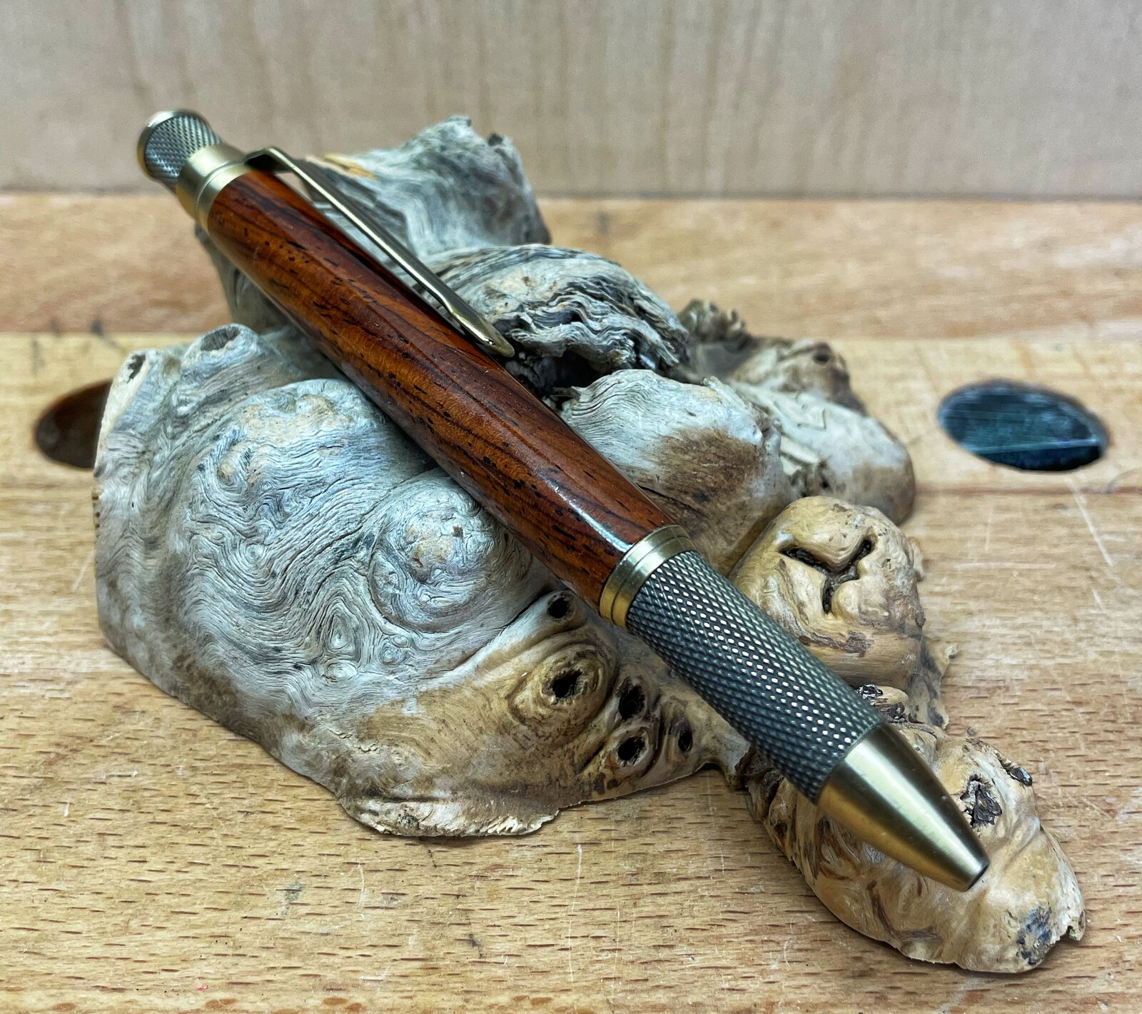

This is my everyday carry and I have used it daily at work for probably close to two years. Even though the wood is beautiful, I decided to change it up. I disassembled it and turned a new barrel. The brass gears and brass pen components match perfectly. I'm pretty happy with this one. The wood is walnut burl that I stabilized. The resin is liquid diamonds. Since the wood is stabilized, I just polished it out with micro mesh. No CA, we'll see how it wears.

I take a small piece of burl, for this pen, drilled the 3/8 hole through it. Wrapped the tube with vinyl, all but the part that would be glued into the wood. After I have the vinyl on I had to re drill just a short depth with a drill bit just few thousandths bigger so so vinyl would slide into the wood. Epoxied the tube into the wood. After that I bent the gears and glued them on. From there just put it in tube in mold and cast it with liquid diamonds. I tried a few with Alumilite clear, but it didn't adhere very well to the vinyl. I did use a pressure pot even they say you don't need to with liquid diamonds, left it under pressure for 24 hours.

Yes, the tube was glued into the wood before casting.

The original pen was nice as your daily carry, but now you have a new great looking pen Ken.
You're right, the gears match the pen metal components perfectly. Thanks for explaining your process.

That did come out beautifully, Ken. That was a nice piece of cocobolo you had to start with, but this definitely shows off those new casting skills.
