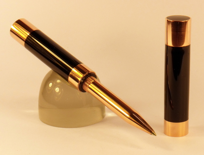

I have used copper several times but always matched it with dark green, which I reckon is a classic combination, but I decided to have a go using black pr.

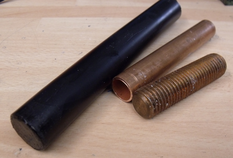

A bit of water pipe and a 16mm copper stud were harmed in the making of this pen....:biggrin:

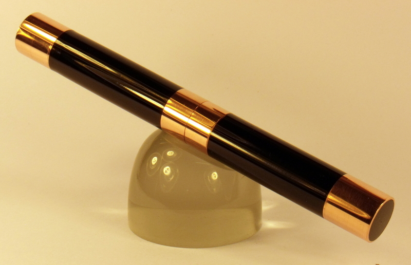

I think it turned out ok, even though the body and the cap somehow ended up being the same length...:confused:
BTW......if you haven't turned copper.......trust me, it's a pig to turn !!:frown:
Hope you like it too.:biggrin:

The dimensions of the body and cap are no distraction to me - they appear fine and look appealing with the complete pen.
The copper and black PR match well.
I think you may underestimate the finished product!
But... I've roasted a pig; barbecued pork; smoked pork; grilled pork; served it Indian; Southern US; etc... But never turned a pig... I'll trust your experience.
Oh, Nice pen
That is a very rich looking pen !!!! I like the balance of top to bottom, and often lengthen the cap myself. What did you put on the copper to keep it from oxidizing ?? Jim S

You did good. I was just reading last week, copper is too gummy to turn. So I let it go. Until now :biggrin: I think it looks nice with black. Thanks for a look at it. AND, convincing me copper can be used for pen parts. Guess I'll have to fight the pig.:biggrin:
Chuck, I find that light cuts at around 1000rpm with a nice sharp tool works. Use some lube on the cutter for the last few passes and hopefully it doesn't gum up on the tool and mark the piece.
With threading with taps and dies, don't keep backing up, just keep going. I found that backing up rips the threads.
Have a go, you'll be fine.:biggrin:
Thanks so much Steve. That's exactly what I needed to know. :wink: Got one in the works right now but, will get things in order. Sounds like fun!

Glorious Pen, Steven.
Love the Contrast between the Polished Copper, and the Black PR.
The Equal length gives the Pen the look of a Scroll Case, and when opened, the revealed Pen Profile is Fantastic.
Superb Craftsmanship throughout, Excellent Finish, and Great Photographs.
Outstanding Concept
Congratulations
