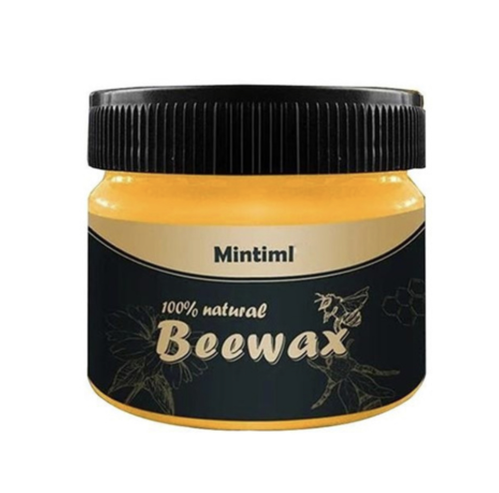

That "beeswax" product shouldn't hurt your pens, and a little gentle buffing with a soft cloth will give it a shine. If you apply it and polish it on the lathe, use very small pieces of cloth to avoid injury.
That beeswax product is not pure beeswax. I don't know what else is in it to make it a soft paste. Pure beeswax feels more like a wax candle at room temperature. I know woodturners who take a chunk of pure beeswax, apply it to their woodturning by holding the chunk against their turning, and then use a cloth to buff it out. Others do the same with carnauba wax. I have chunks of both. I use them other other things, but not pens.

I wasn't sure about the Beewax. I had it and thought it might be a way to put it to good use since I really have nothing else that I want to use it on.

Since beeswax doesn't harden, it doesn't develop layers. One coat that's rubbed in well will do ya'.I used on the one pen I made with the chip on it. I used my friction polish first and about 5 layers of the Beewax on top. I'll use the pen and see what happens. Experiment #1. Got nothing to lose.
I started to reply to this yesterday but got side tracked by travel.I used on the one pen I made with the chip on it. I used my friction polish first and about 5 layers of the Beewax on top. I'll use the pen and see what happens. Experiment #1. Got nothing to lose.
