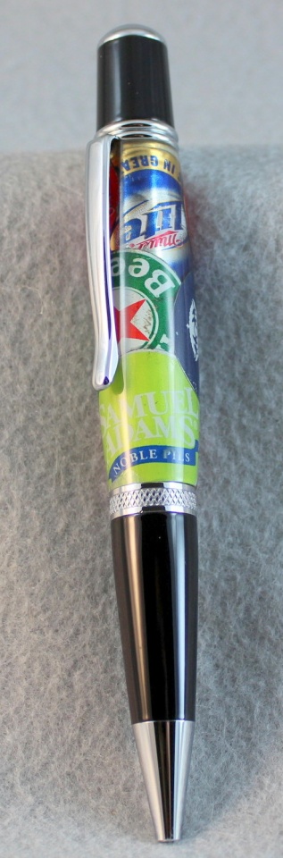

Here's my attempt at a beer cap pen.
All comments, suggestions or questions are welcome.
Mike

Joking aside, a Fantastic Blank Mike.
BTW. Are they overlapped? or are they cut and nested to fit?
Incidentally, the Pen is also Great.
Thanks for sharing, even if it was only the Caps from the Beers.

Thanks guys. The best part was drinking all the different beers :biggrin:.
Yup , they are all overlapped.That was the hard part was getting them to lay flat enough.
Mike
They are cast with poly resin in a resin saver mold.
Didn't have to feather the edges. After I cut the crimping off I scrape and sand the inner seal off. I then pick a transfer punch a few sizes small than the tube I'm using and wrap the caps around the punch and roll them on a piece of wood to shape them so they fit the tube tightly. A drop of CA under the caps will help keep them in place.
Hope this helps,
