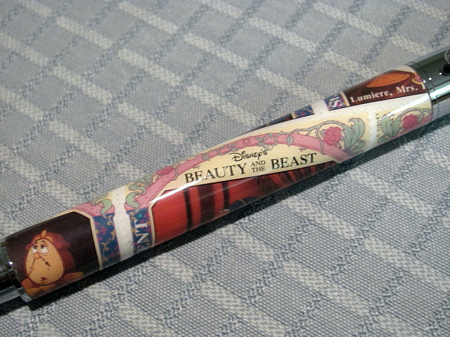

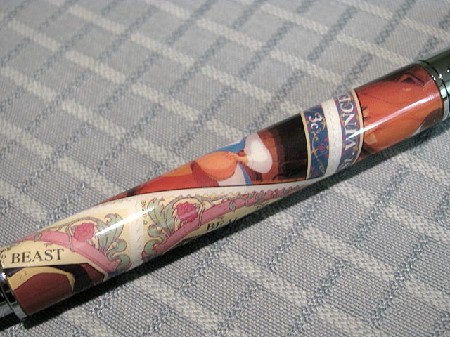

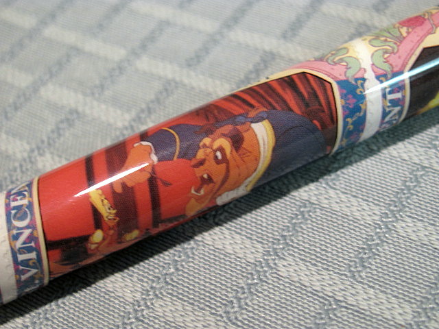

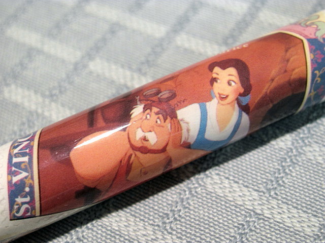

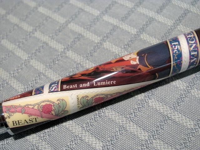

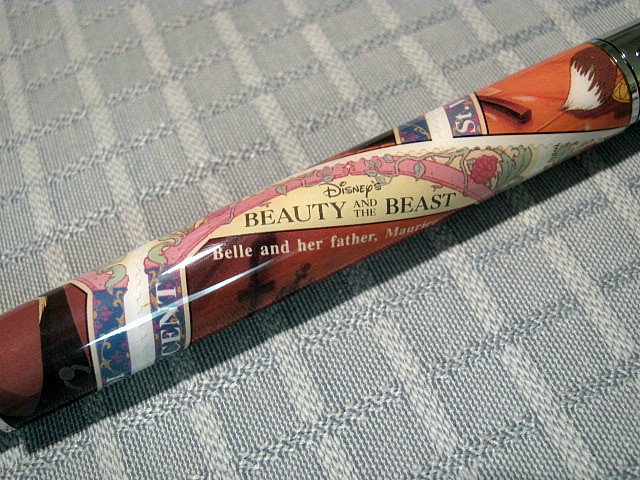

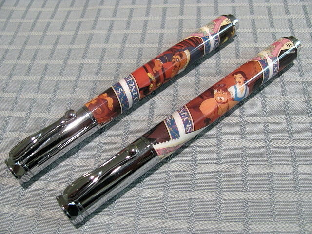

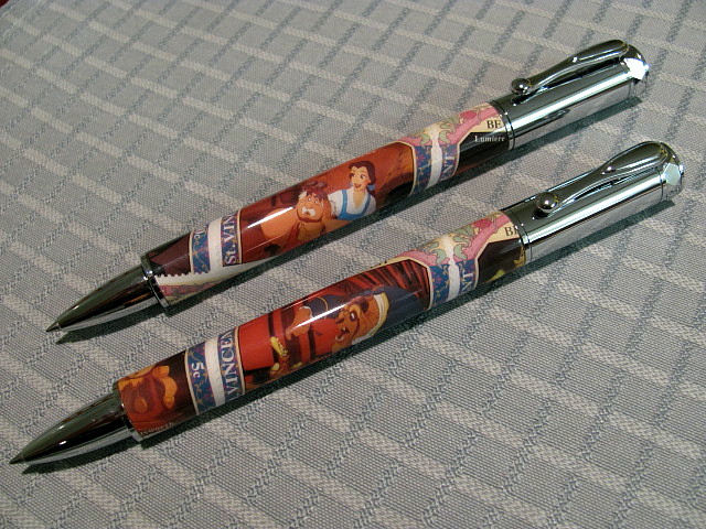

My wife really likes the Beauty and the Beast.So last month I took her downtown to see the play when it was here.We had a great time,so I thought it would be neat to make a matching pair of "Sweetheart Pens."
One for each of our collections.Beauty for her,I'm the Beast!
She picked out these jumbo-sized St.Vincent stamps of the animated version.Just one almost covers the whole tube.I did them decoupage-style on wooden blanks & ca.
Chrome plating on these Zens.
Just in time for Valentine's day.
>>>>> Here's a question for you guys.....with all the different Disney stamps out there,would I get in trouble if I wanted to sell ones like this? They are mostly from the country of St.Vincent.
Thanks for lookin',and any thoughts on the question.
Steve

Thanks for the replies.I looked up the Derivitive Work Exemption
Wow,my head hurts just reading all the legal wording! It sounds like they would not be changed enough to be original,if I read it right.
I think I'll skip that whole idea then,to be safe.Sure wouldn't want to get in legal trouble.
Too bad,they have so many available.
Thanks,
Steve
