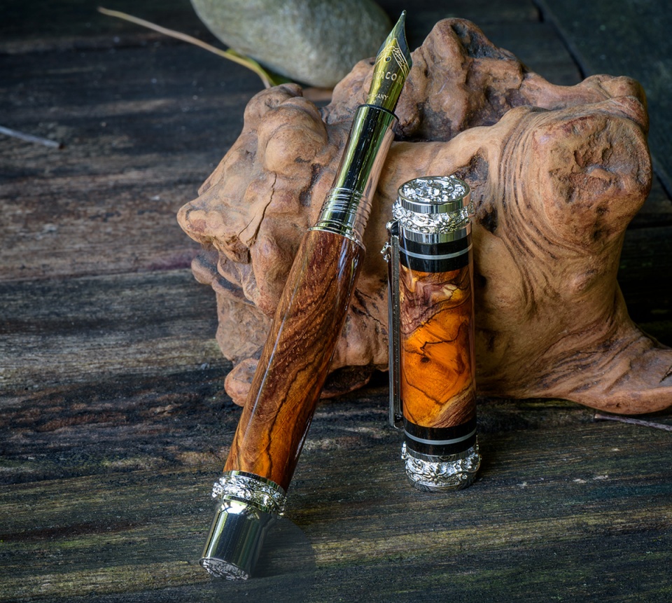

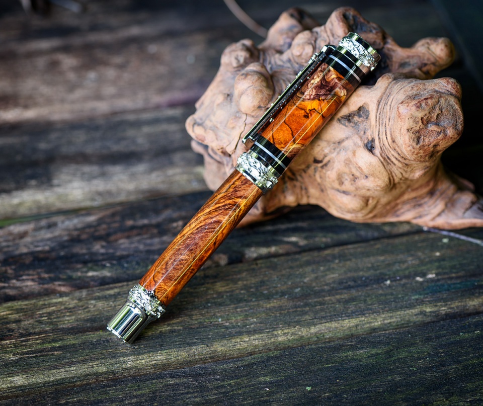

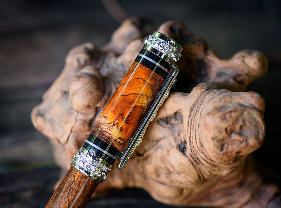

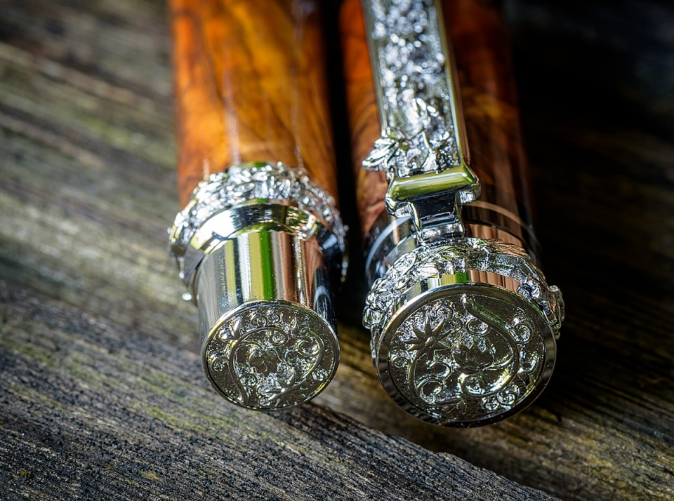

Wish I could find more of this wood! I had a blow-out on the upper barrel so I segmented with ebony and aluminum. This is another great palace vine Jr. Thanks for looking.

Ooooh Soooo tooo bad!! on the blow out.
You did a good effort on the recovery, but the blank itself cries out for the parts gone. :frown:
We all want more of that wood. You were wise to couple it with a very top end kit. I really enjoyed seeing this pen...nice work and nice post.

Yes, I think I came close to a curse word when the piece blew out but I stepped out of the shop and maintained control. I would have much rather had a solid piece on the upper barrel but that's the way it goes sometimes. Glad I was able to keep most of it!
So ... this cocobolo, is it the type that will darken up after exposure to UV/sunlight? I love the light orange play against the darker brown, but I've seen quite a bit of my cocobolo end up a stunning array of golden yellow to dark brown, with reds and oranges banded between.
That is a beautiful piece of Cocobola, shame the cap piece blew out but the segmented fix look great!
I too love the mix of colors. I am not sure how long it will take but the wood will darken with age. Hopefully the contrasting colors will still contrast as it ages.
Mike you did an outstanding job on saving that pen! If you wouldn't have said anything about the blow out I'd have figured it was all designed/segmented that way! Incredible pen Mike!
Mmmm ... nope, the stuff I have is certainly pretty, but it's not burl. Crosscut slabs that came with knots through them that were removed. I'll have to make something out of some of this, it's very nice looking stuff ... I just don't have any pen kits left! lol
Mike congrats on the front page. It probably is one of the strongest photos we had there in a long time. Really jumps out at you. I like the metal added and the timber speaks for itself. nice combo. keep up the good work. Hope to see more.

I have quite a bit of cocobolo and I was told by a cue maker a trick. When your almost done turning just before sanding wrap the cocobolo in a paper towel then soak with denatured alcohol, allow to dry and repeat a few times. it takes some of the oils out and allows it to retain the natural color variations. it will darken with time but not as much as normal.
Beautiful Pen! A well deserved front pager! I was curious on the finish you used? Mind sharing the specs? Is it CA? or some lacquer? Thanks for sharing your artwork!
