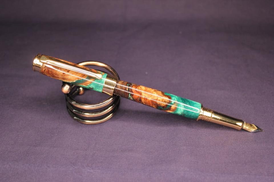

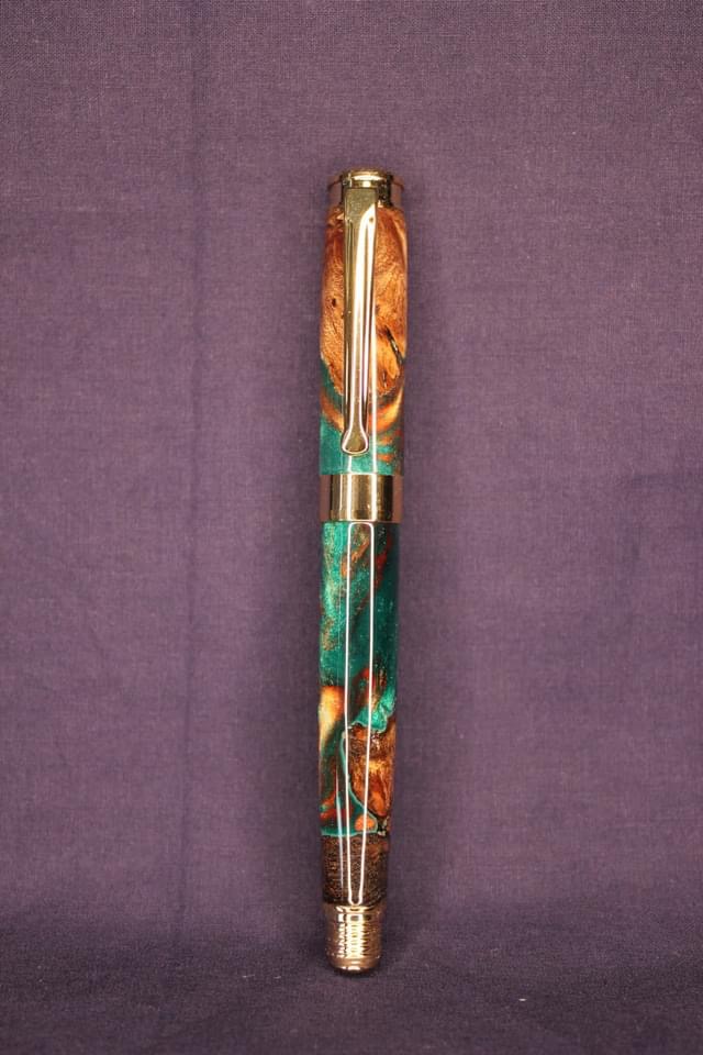

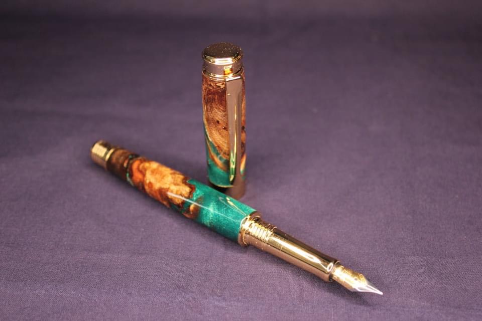

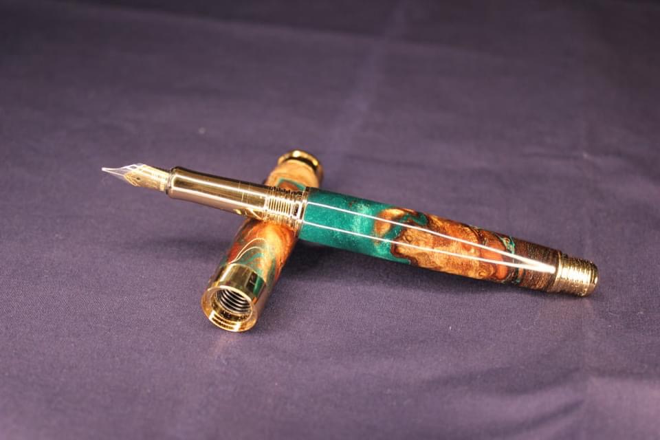

Beautiful pen. Nice job with the pearl effect. What resin did you cast it in?
Thank you! Alumilite Clear. I mixed some green mica and green dye in one, and antique copper mica powder in the other. Light swirl before putting it in the pressure pot, but if I could go back I would have used the Alumilite Clear Slow and not swirled at all. I need that extra 5 minutes of work time I think, and the colors blended a bit more than I would have liked, but I'm still pleased with the outcome. Finished with eight coats of CA.
