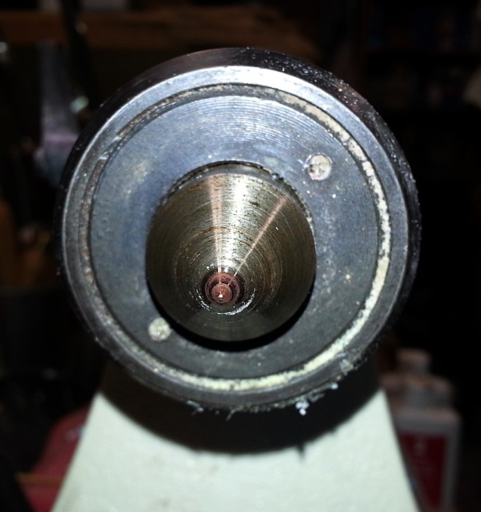

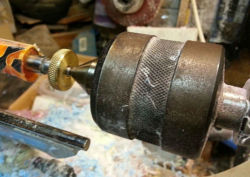

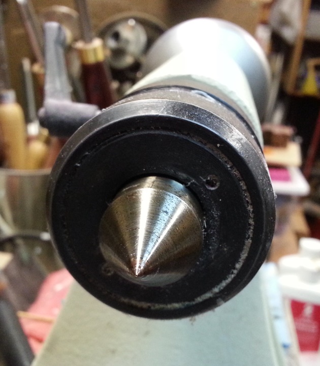

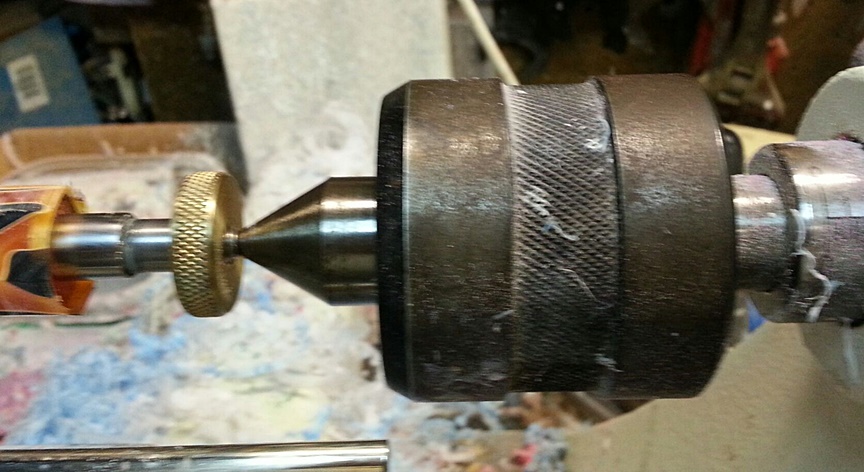

I've got one of the Harbor Freight live centers that I've had for over ten years. It's on its second lathe, and still going strong. I've often wondered if the bearings are replaceable, but it would require some sort of spanner wrench.
