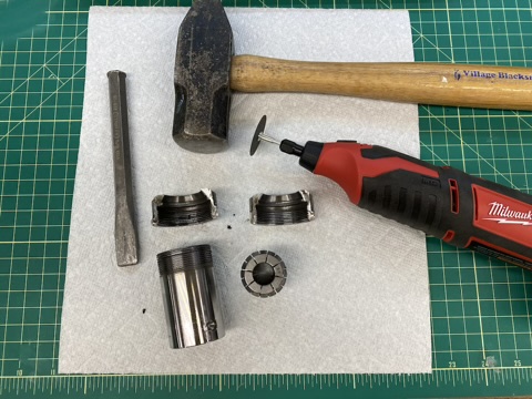

So... my beloved 1"x8TPI Beall ER32 collet chuck seized up with my 5/8" collet in it and my @rherrell made mandrels are all 5/8" :cool:.
I have heard of these collet chuck getting cross threaded, and I don't think that is what happened with this one, maybe something got in the threads, I don't know. Until this event, I have had no issues with this chuck. I tried everything, force, lubrication, penetrating oil, heat, you name it, I could not get the collet nut off. I called Lee Valley which is who I purchased the chuck from and they offered me a replacement at a 15% discount and no charge for shipping. That felt more than fair so I ordered a replacement.
BUT... I wanted my 5/8" ER32 collet back, so I had to get medieval on it. I did get the collet back and I don't think it is damaged. Tomorrow morning I'll put it in the replacement chuck and check it for runout. 🤞

Unfortunately, load order wasn't my issue, I am familiar with the proper use of the chuck.
The collet body is also now trash, the wrench/key holes are damaged from the brute force attempts to get the nut off and using the abrasive cutting wheel to cut the nut off cut deeply into the threads. I knew this going in. I have already purchased a replacement Beall from Lee Valley.
The chuck is/was a Beall, Rick made my kitless mandrels that I use in it and they are all awesome and safe and sound.

Thanks Ian. The body is trashed as well. I purchased a replacement chuck from Lee Valley and have it already. I just recently learned about the "ball raced" nuts, I'll have to look for one of those.

Thanks Hank. I had to cut and run last night so I haven't inspected the threads on the chuck and nut after cutting it off. I'll be doing this later today to try to determine the cause of failure.
