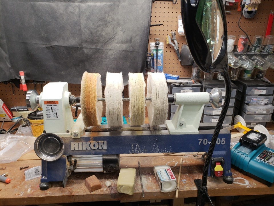

I built my own system using buffing wheels from Caswell Plating, and the compounds from Beall. I later added more buffing compounds from Caswell after Tex at Durango wrote his article about buffing.
If you have a collet chuck, you can buy 5/8" bolts about 6" long, cut off the bolt head, and with 2 nuts and 2 washers you have a mandrel for a buffing wheel.
Or you can drill and tap a blank and make wooden mandrels that screw on to the headstock of your lathe. On the end of the wood mandrel drill and tap a hole for a 2 1/2" long 5/8" bolt to hold the buffing wheel.

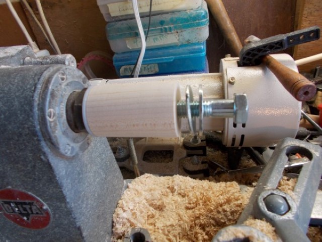

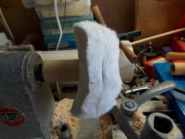

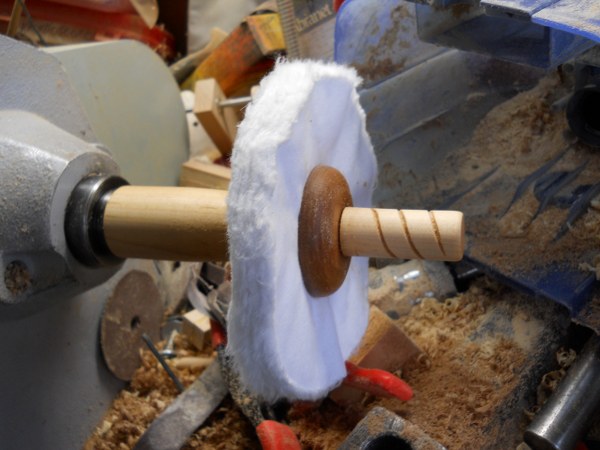

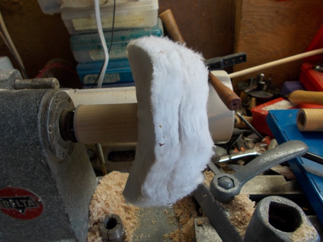

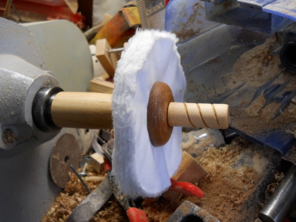

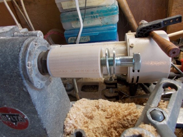

If you don't mind using your lathe, make a mandrel like this. Drill and tap a blank to fit the spindle, then drill and tap the end to fit an appropriate sized bolt. I have several of these, one for each compound, the mandrel, the compound and wheel all store in their individual plastic zip bags.
The third version is so I do not have to grab a wrench for changing the wheel.
I also made another version that screws on to a 4 1/2" Harbor Freight grinder, It was hooked up to a router speed controller so I have a variable speed buffing wheels/ Sorry no pictures, it was given to my son.

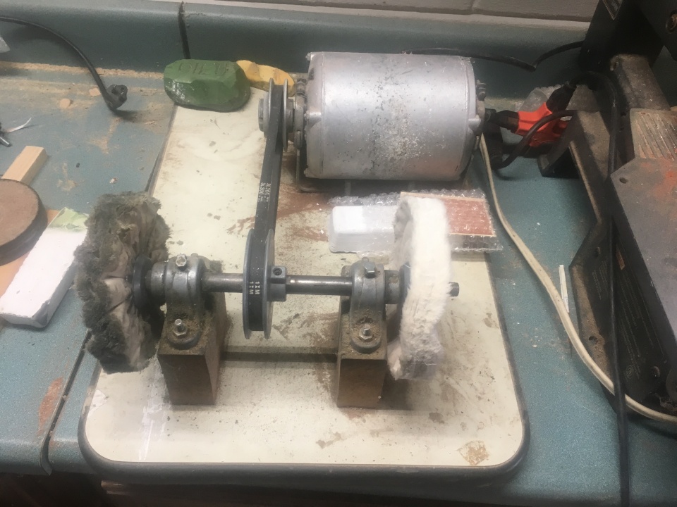

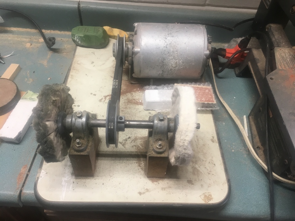

Salvaged an old washing machine motor and a cheap arbor and made my buffing station over 30 years ago to sharpen carving tools. It is still going strong.
Add a little white diamond and it makes em' shine.
It goes at 1750 which has been a good multi-purpose speed.
I have occasionally thought about something that looked better but always asked myself , why?

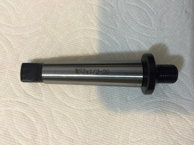

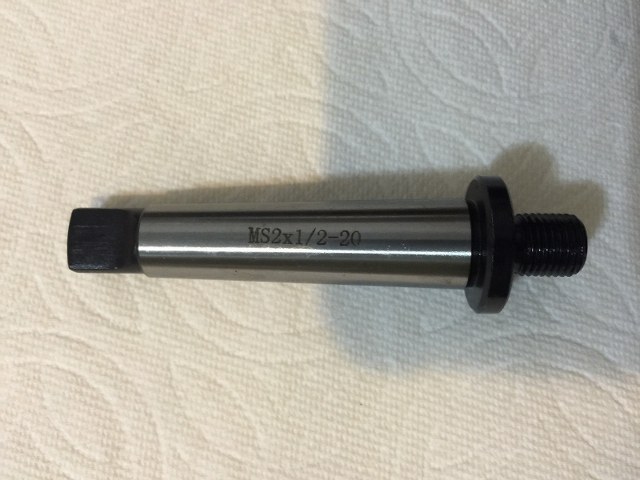

A 2mt arbor with a threaded end would be all you need. From there add a connector threaded to the 2MT that is compatible to the all thread rod of your choice. Add nuts, washers, buffing wheels and I would suggest a piece of Delrin threaded to fit the end of the all thread to save wear and tear on your live center.

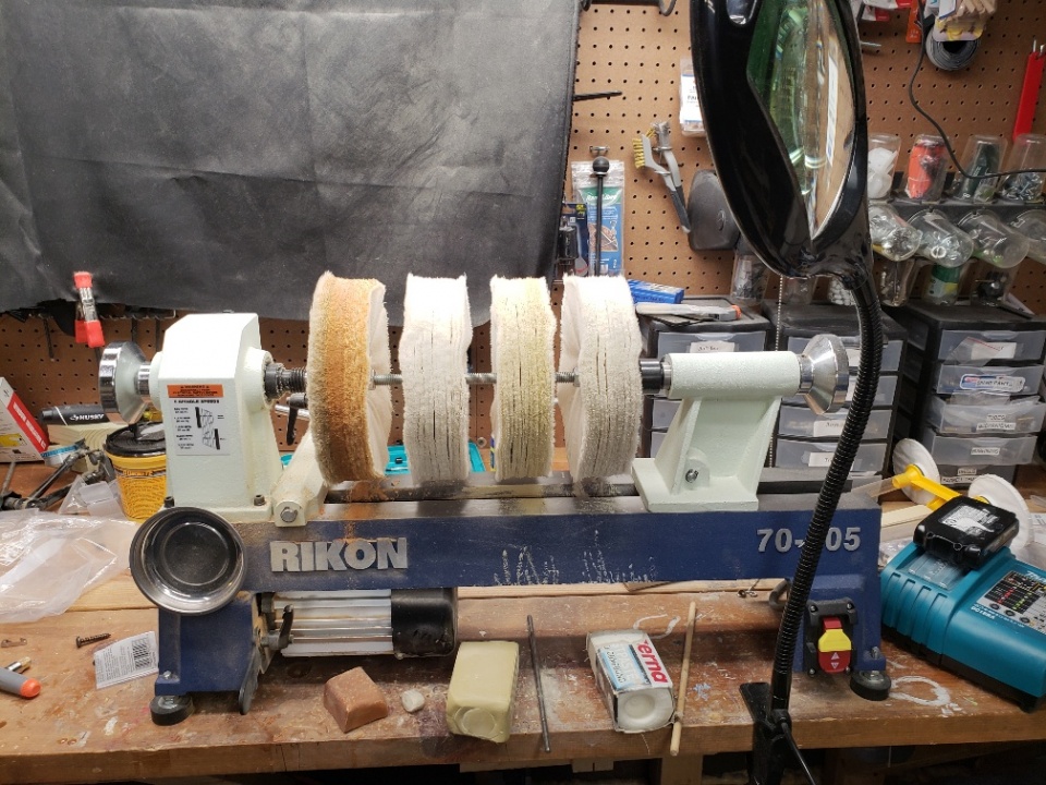

I drilled and tapped scrap wood to screw onto my headstock. Drilled the other end to accept a 3/8 T-nut. Bought the Beall buffs from CSUSA that already have the 3/8 bolt on the for $17.50 each. They go onto my headstock ina few seconds.
BTW, if you are mounting multiple wheels at a time you are contaminating them with compound from the other wheels. I mount mine one at a time and keep the buffs in separate plastic bags to prevent contamination.
