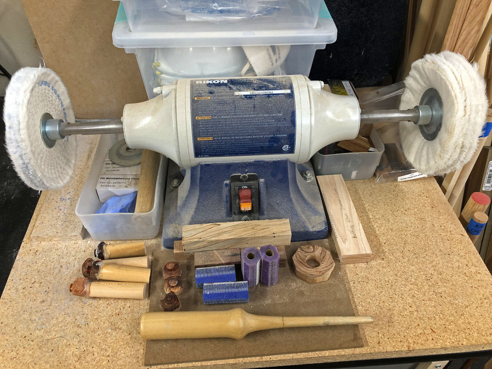

Although I don't use the Beal system, I do use a stand alone buffer based on a low speed pedestal buffer sold under the Rikon brand name. I reduced the size of the wheels to control the surface velocity to best match another commercially available pen buffing system and I use their "blue" rouge as my buffing compound on a sewn cotton wheel followed by a loosely sewn flannel wheel for the final polish.
My advice is to turn some tapered tools / dowels that can be inserted into one end of the pen parts to help hold them while buffing. I suggest wood as it has been my experience that any metal such as pen bushings or mandrels transfer some metal to the wheels which turns them kind of a dull gray color. Although many people successfully buff using these discolored wheels, I can't help but think the metal on the wheels is also transferred back onto future blanks when I am buffing them. Since using these wooden tools my wheels are as white (and blue) as the day they were new.

Here is a picture of my buffer. The tool I use most often is right in front. It fits the 10mm and larger tubes. - Dave
