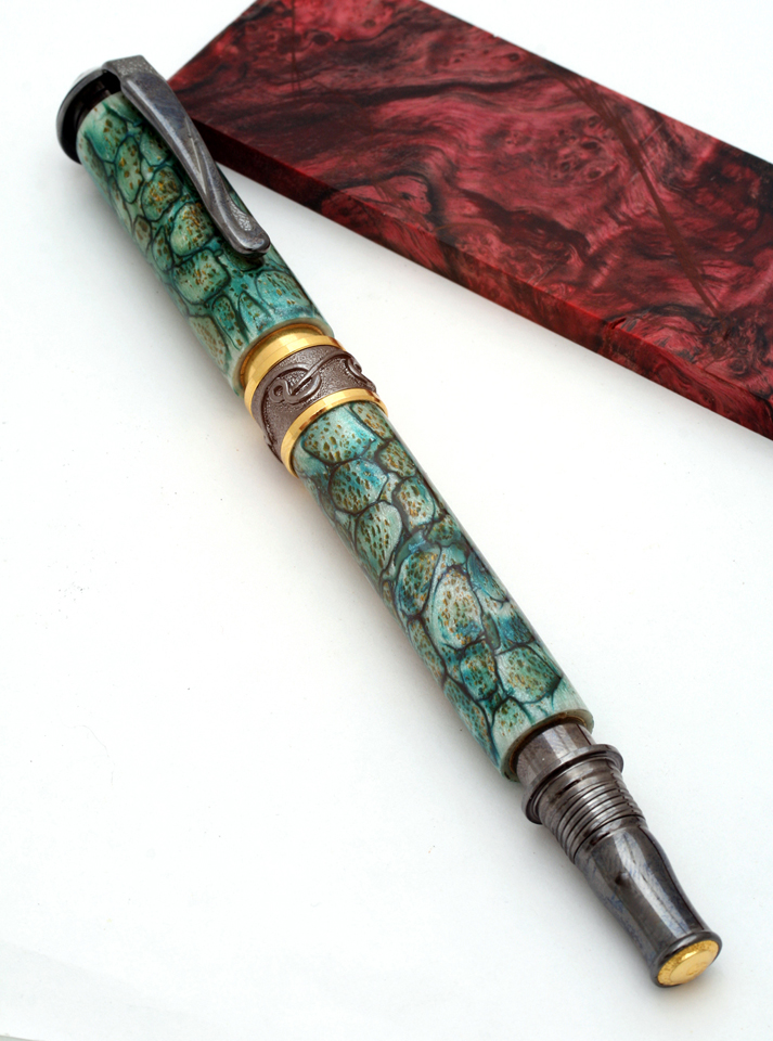

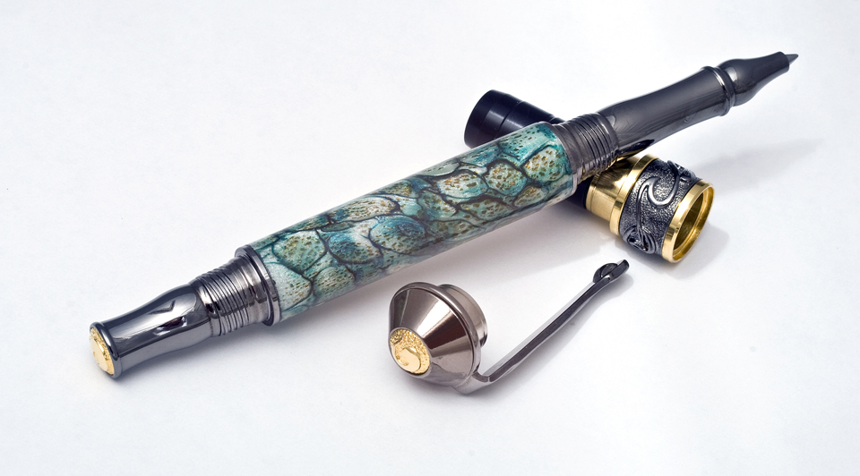

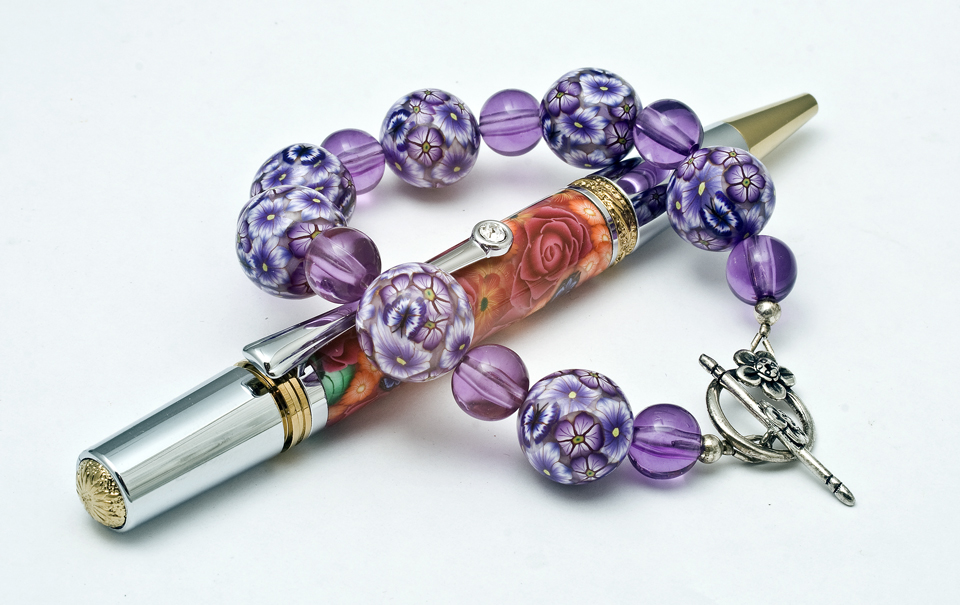

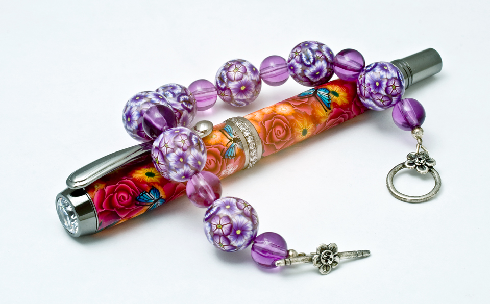

Had to share. This is a bracelet and pen from Toni Ransfield. I should print/mat/frame this shot.
attachment.php
attachment.php
The beads have this amazing color change ability depending on what is next to it. Toni did the red rose blanks for me last year and it's on a black titanium Venus rollerball.
Image stuff:
Each image is a single shot.
Camera settings: Manual mode F20, 1/125, manual focus, ISO 100, Center weight focus indicator.
Lighting was direct with a single light;
Light Direction was left side 135 degrees with head facing me.
First shot head was 45 degrees diag to the image,
Second shot the head was facing me.
wow
Those are both incredible! Always wanted (and will eventually) try one of her creations, but not past the fear aka pucker factor of ruining one of her beautiful creations.:eek:
Very, very nice shots. I was going to guess F-22. You no not mention it but it looks like a Soft box and/or Reflector was used (soft shadows).
Nice work!

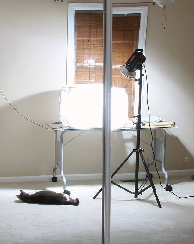

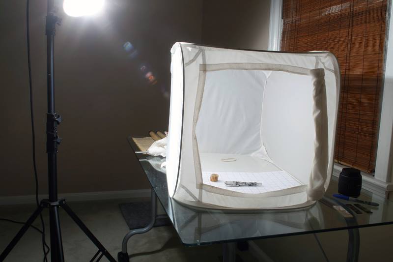

I use a light tent.
attachment.php

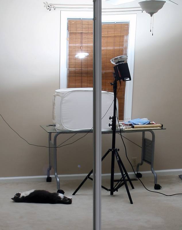

I switch between direct lighting
attachment.php
and bounce lighting
attachment.php
The ceiling makes a wonderful reflector in the room, as does the wall color and carpet color.
Also forgot to mention the background is legal sized printer paper.

It has been one of my goals to capture the beauty, the details and the form that I see when I look at various things. Being 50% colorblind does hinder that process greatly most of the time but it also allows me to see things that has been overlooked, missing or left out, hidden beauty.
Example in this case was the small beads that drastically color change according to surroundings. I was able to capture this chameleon by adding color contrast and a drastic change in lighting angle, most notably in the front 3 small beads this can be seen. The 4 in the back was more gradual which gives that 3D effect to the image. Think MC Escher drawings :)

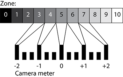

Forcing light reflections to go in set patterns, matching color contrast and expanding zone 1 and 2 to match with 8 and 9 allows you to push the envelope and show much more detail.

In case it was not clear the zones mentioned is Ansel Adam's creation way back in the day. Many have said it only works on b/w film but it still has life today in the digital world. By the chart showing you can get a basic understanding of things.
attachment.php
For more understanding of it read "The Negative" by Ansel Adams.

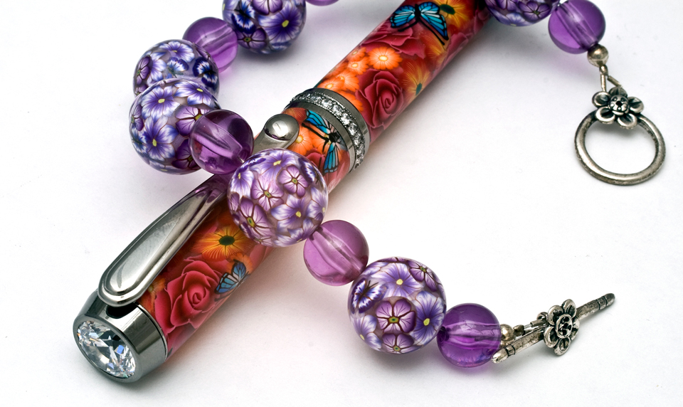

Someone said imitation is the highest form of flattery. So ...
attachment.php
We took 5 Majestic squires and finished some tubes for them, one of them was a red rose. After working out the bugs in the tube (pun intended) I decided to imitate my first shot. In some ways I like this shot better.
Three things I dislike about this shot is the glare on the tube and the reflection on the center band and cap. The glare does degrade the tube quality. Oh in case everyone missed it, the cap is not pushed on fully in this image.

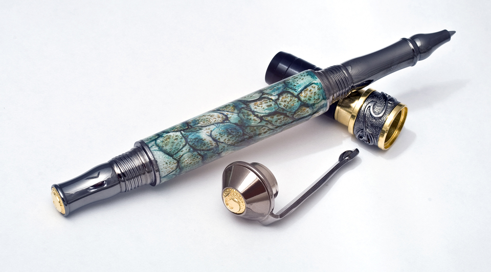

Oh and sneak preview of upcoming stuff.
