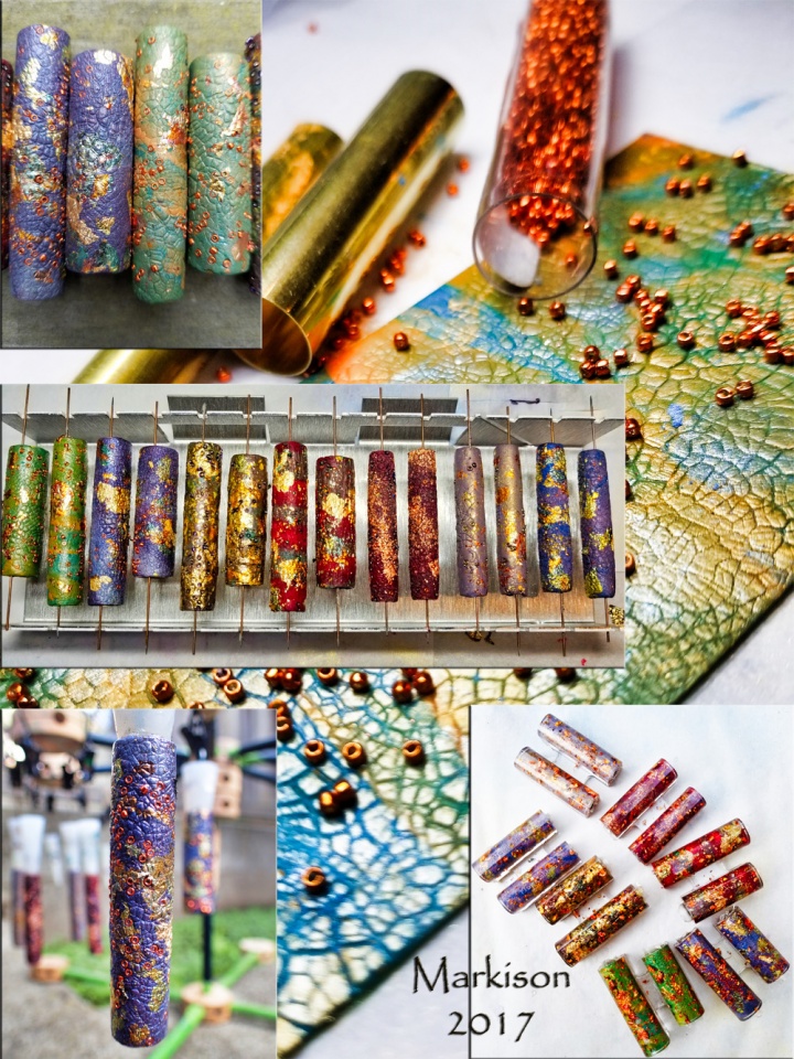

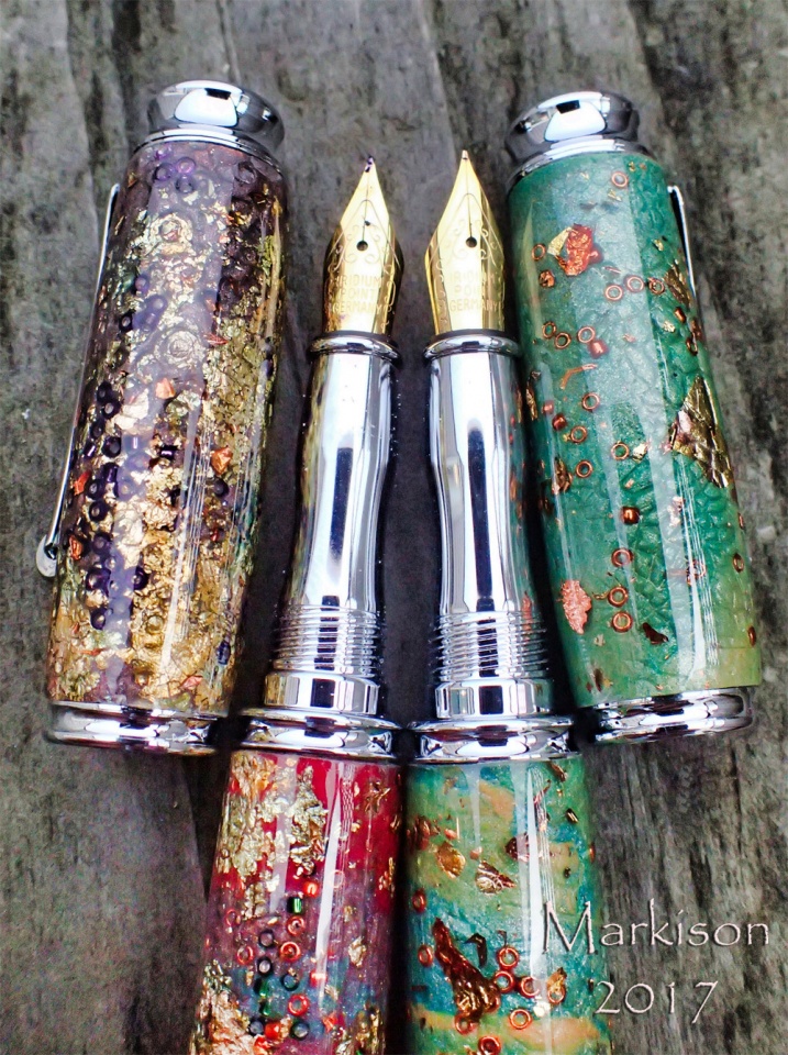

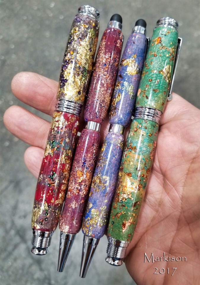

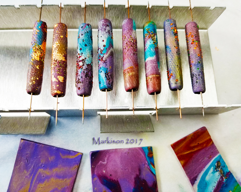

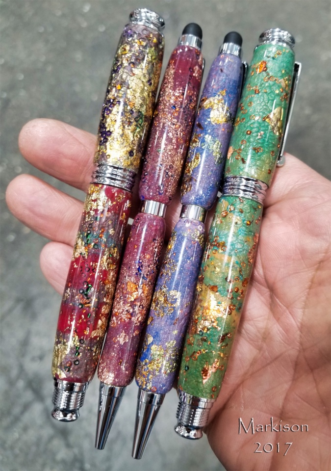

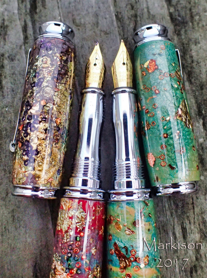

I was chatting with some friends who are members of Northern California's esteemed and creative Pomo Indian Tribe. They carry on the beautiful tribal tradition of beaded basketry, had heard about my pens, and asked if I'd incorporated beads: no, not yet...(minor light bulb moment). They kindly gave me some tiny 15/0 seed beads. I didn't string the little guys, hence the moniker "Unstrung Heroes", but stay tuned for version 2.0.
Steps:
Sculpey Premo polymer clay colors mixed, then rolled out to 3/64" thickness.
Clay then textured with various found and created surfaces (bark, kitchen strainer, cheese cloth, etc.).
Clay rubbed with metal flakes, mica powders, re-textured
Beads inlaid.
Beaded clay surface re-textured.
Clay wrapped around acetone-washed/150 grit sanded tubes and adhered with Sculpey liquid clay.
Clay-wrapped tubes re-textured, trimmed.
Clad tubes baked in a toaster oven at 275 degrees x 25 min., heat diffused by an aluminum foil dome over the rack.
Tubes then glazed with Judikins Diamond Glaze, dried x 48 hours.
Pressure cast tube-in at 50psi using Douglass and Sturges PR mixed with more metal flakes.
Turned as usual.
Barrel ends reinforced with CA glue because there was a very thin PR coating over the far-edges of the clay.
Finished as usual.
The apology: keen eyed forumites will surely note that the children are chunky and wasp wasted. I am loathe to fat-shame them at this delicate phase of their identity development, but I do apologize. They promise to go on low-carb diets after the Holidays.

The pens are beautiful as usual and would do well along any tribal work or as gifts.
I am wondering if a more dominant role for the beads somehow would be more reflective of the beadwork we see from the tribes? As I look closely, I don't believe it is a bead quantity issue, but from the photos they seem to get a little lost among similar/competing colors. Could well be the overall effect you were shooting for, I was expecting more presence from the beads. Just my thoughts. Always blown away by your creativity.

Thanks Mike and Mal!
Mike - Your points are well taken - just getting started with this little set of experiments - lots of possibilities.

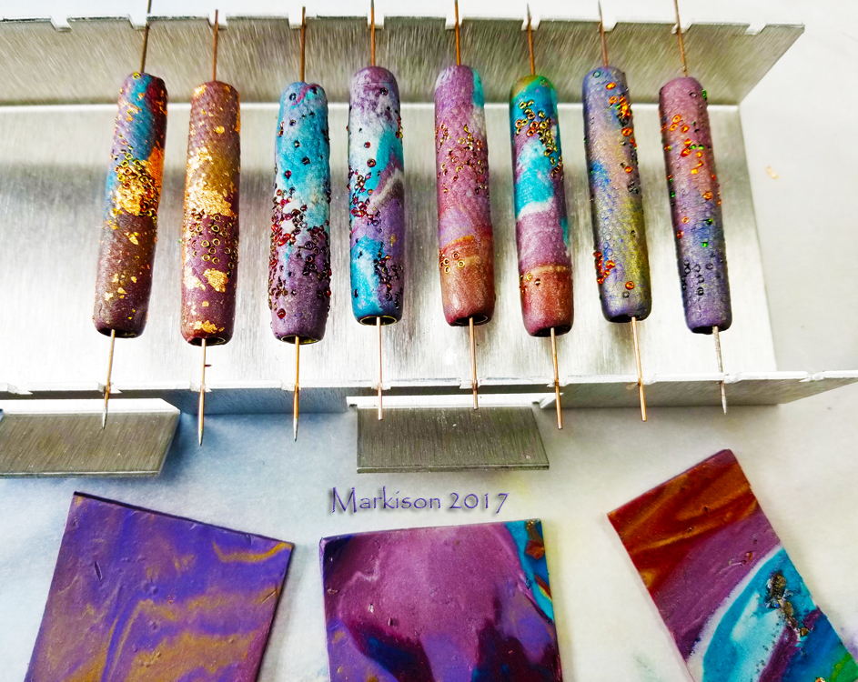

My next brood has simpler backgrounds:

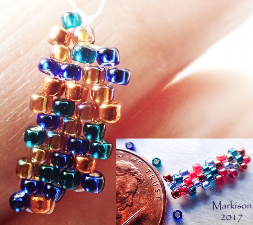

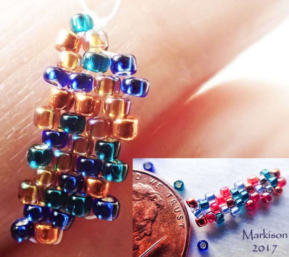

I'm sharpening up my micro-seed-bead-stitching techniques for next-level BeadieBabies - these are some of today's peyote stitched (tiny) 15/0 micro seed beads, stitched with FireLine Crystal .005" bead thread, using a #12 John James brand beading needle (stay tuned):

Pete: "Do you see any issues with bubbles coming out of those little beads when the resin is poured over them?"
No bubble trouble so far - BUT I slowly brush Judikins Diamond Glaze over the beads as an intermediate layer, and let it dry x 2-3 days before tube-in casting in PR at 50psi. I may get bubbles as I venture into more complex surfaces with stitched/woven beads - hoping to get a little more shop time within the busy Holiday Season - stay tuned.
