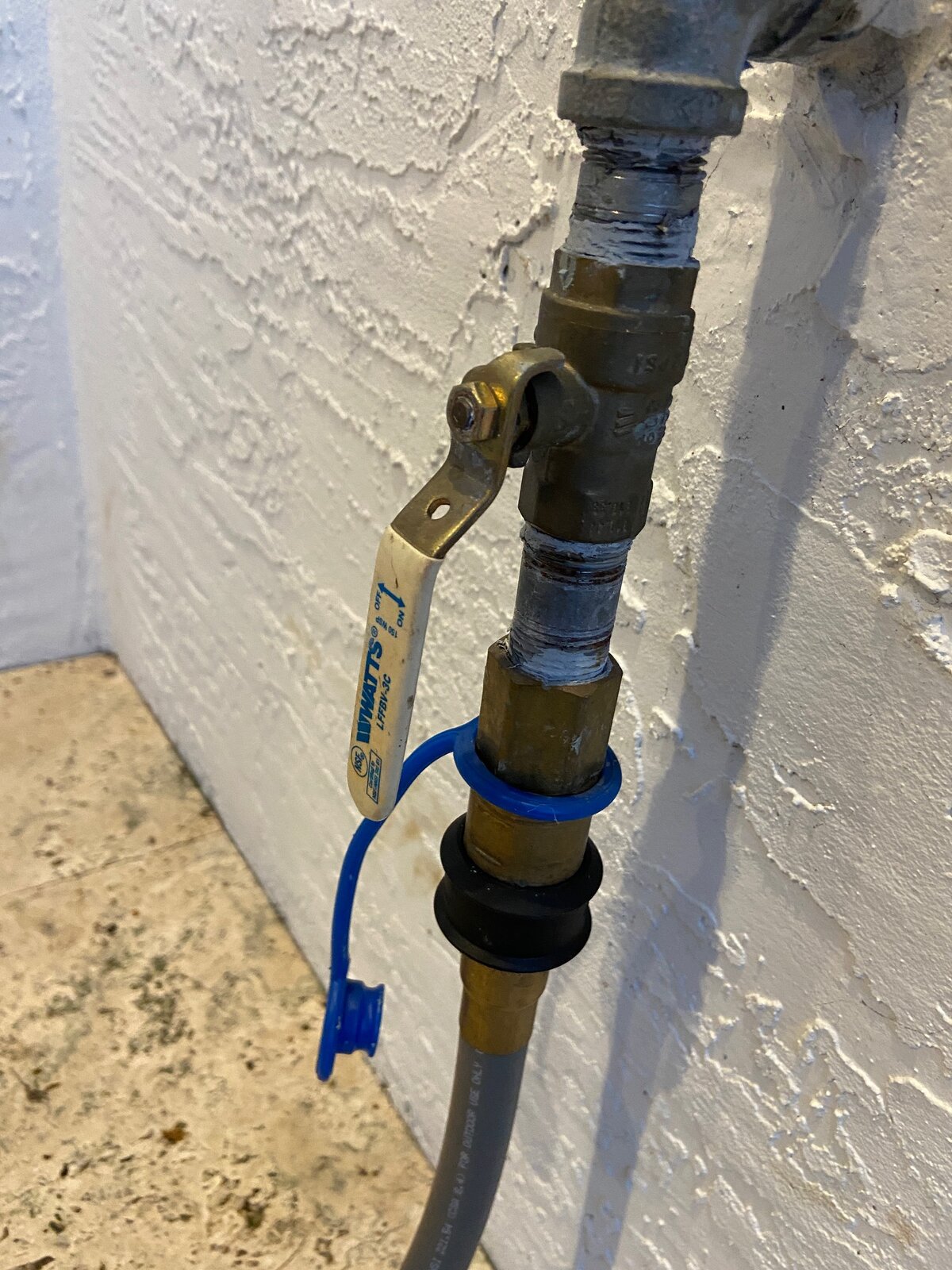

I do not like how the quick connect engages/disengages. I do not feel that good positive click when connecting. And it has to be pressed hard to connect/separate. Can a lube be used on the male and female fittings. If so what gets used. Thank you

I don't have an answer to how the quick connect feels but I can say with certainty that the flared brass connections for gas never require any kind of lube or Teflon tape. If the connector is flared then it seats in kind of a ball and socket configuration, any lubricant can cause a leak.
The older I get - the scarrier I get when it comes to gas and electric. If it were me I would replace it with a new Dozyant or Gaspro or whatever brand I was comfortable with. - Dave
I would call up a barbecue seller that does natural gas installs or a furnace/heating company. Their gas fitters would know what if anything you can use on the quick disconnect fittings. Let us know what you learn. I'm going to be getting a natural gas barbecue this year and everything is ready to go except for the QD fitting on the feed.
Resolved. The 2 pieces that connect/disconnect needed a thin coating of synthetic lube. Thanks for all replies. Will check with gas sniffer later.
