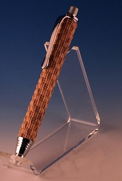

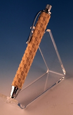

My contribution will be these 2 mini pencils - one from sycamore and one from pear.
attachment.php
attachment.php
these are amazing! how do you do this?! i would love to know!!
Short version - done on a CNC
Long version - there are 60 rows, or 12 groups of 5. each line of pattern in the group of 5 is indexed either up or down. The next set of 5 is indexed lengthwise. The pattern itself is drawn as a graph and the points that generate the pattern are then coordinates that are used to generate the code fed to the CNC. There are tens of thousands of lines of code for this. Each line is cut with a .025" bit. Easy to replicate once the code is written but it took several days just to write the code.
