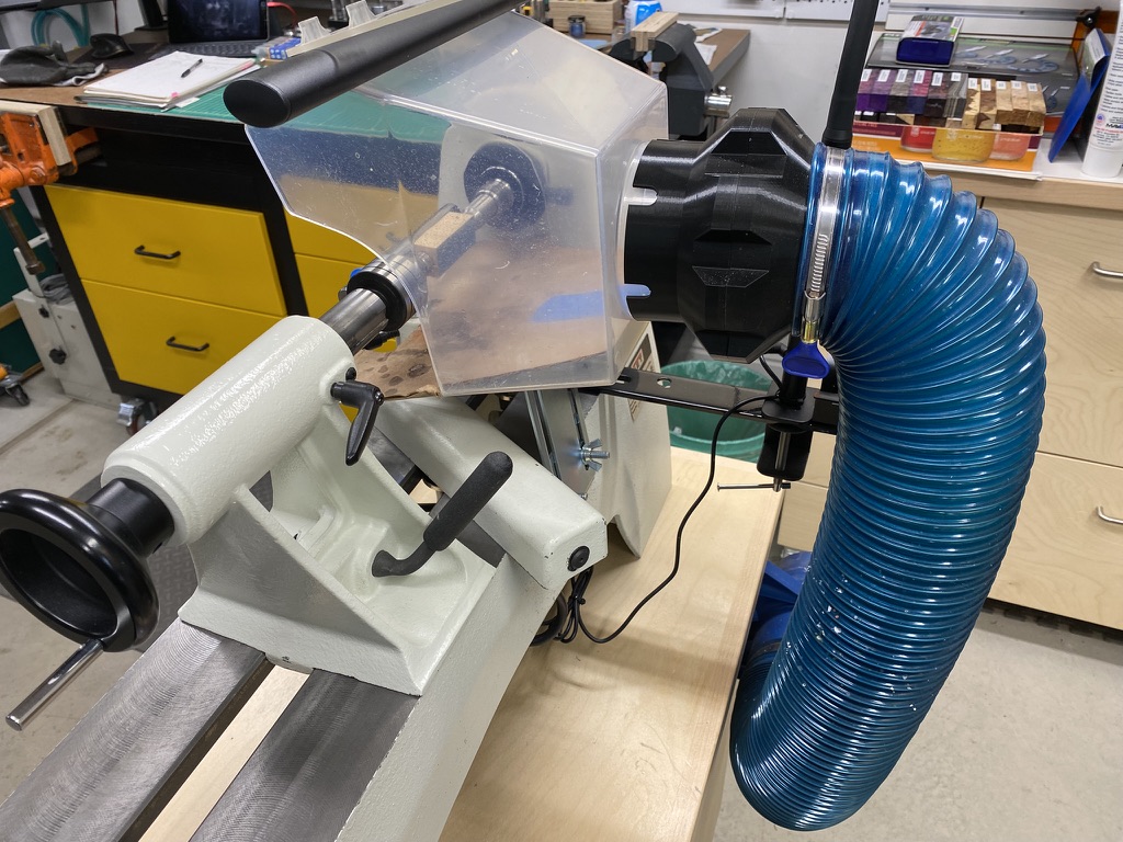

But, I switched to this Clear Lathe Dust Hood with Magnetic Mounting Clamp from Penn State Industries (PSI). It is cheaper and for me, works much better. I do have a dust collector with 4" hose so I'm not sure how well it would work with a shop vac. The big difference is that shop vacs are low volume high pressure and dust collectors are high volume low pressure and just move much more air across the work area.

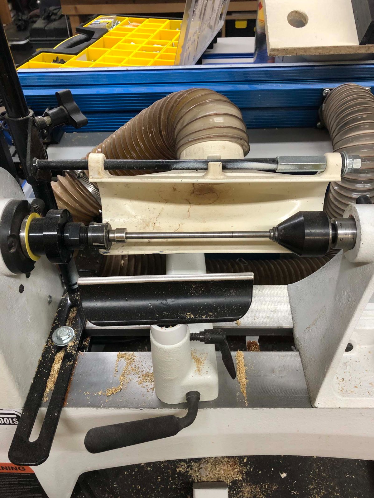

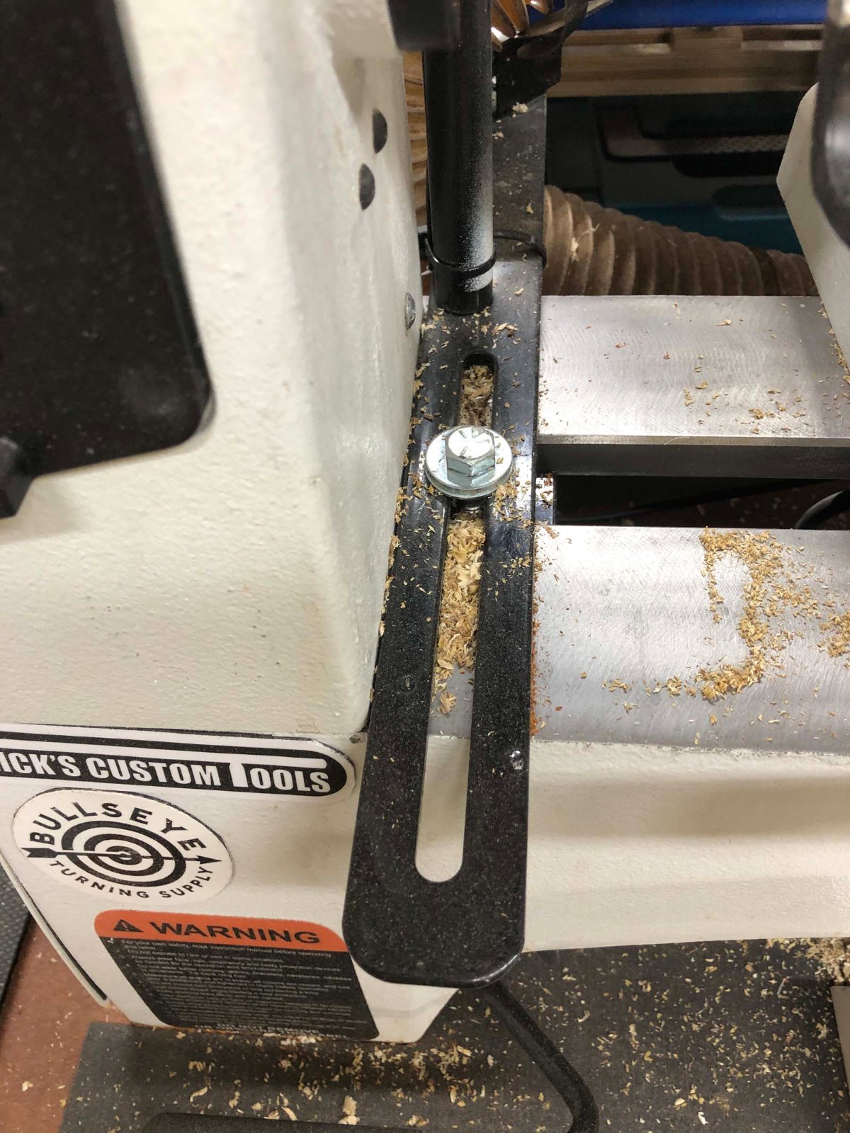

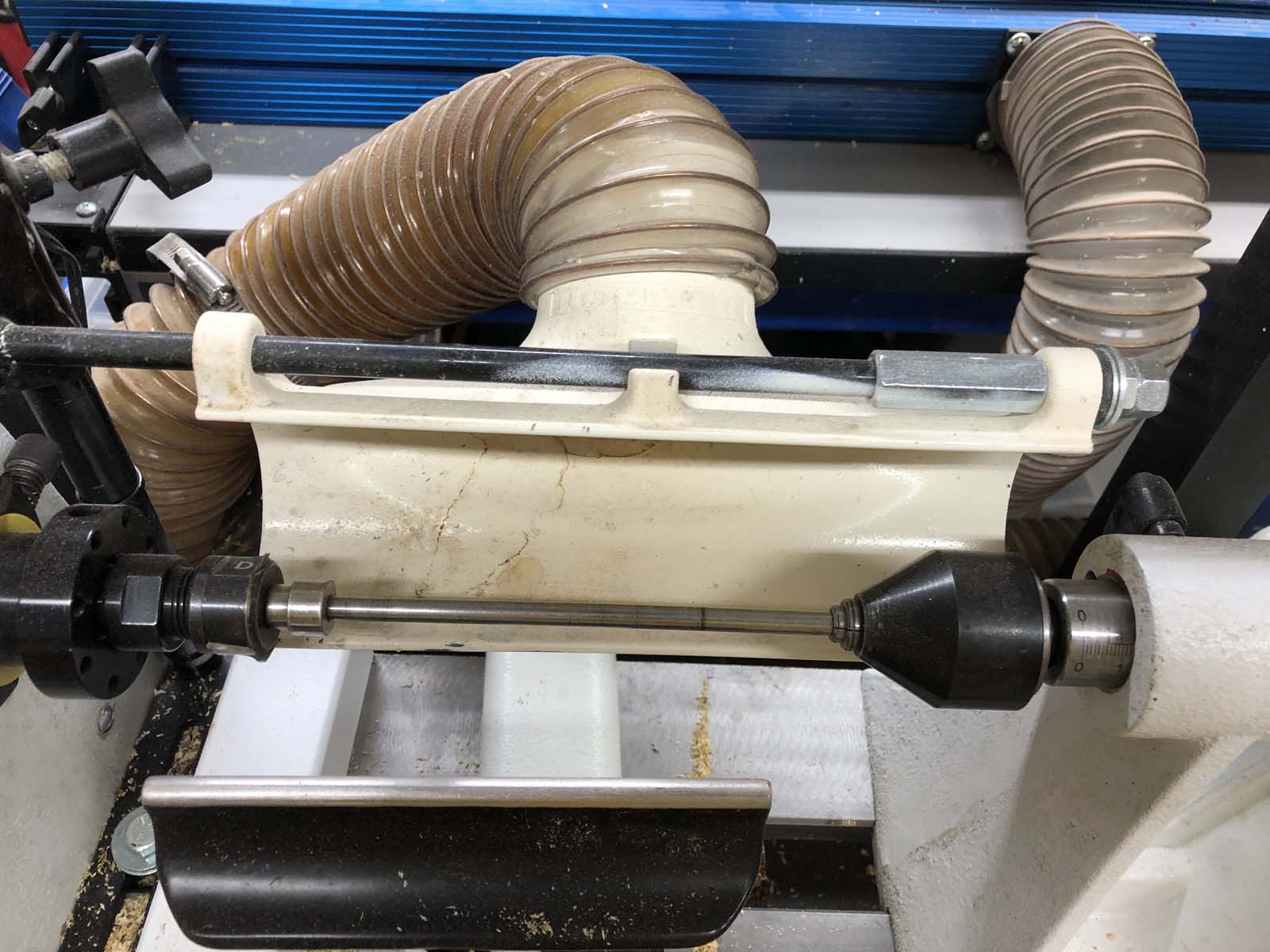

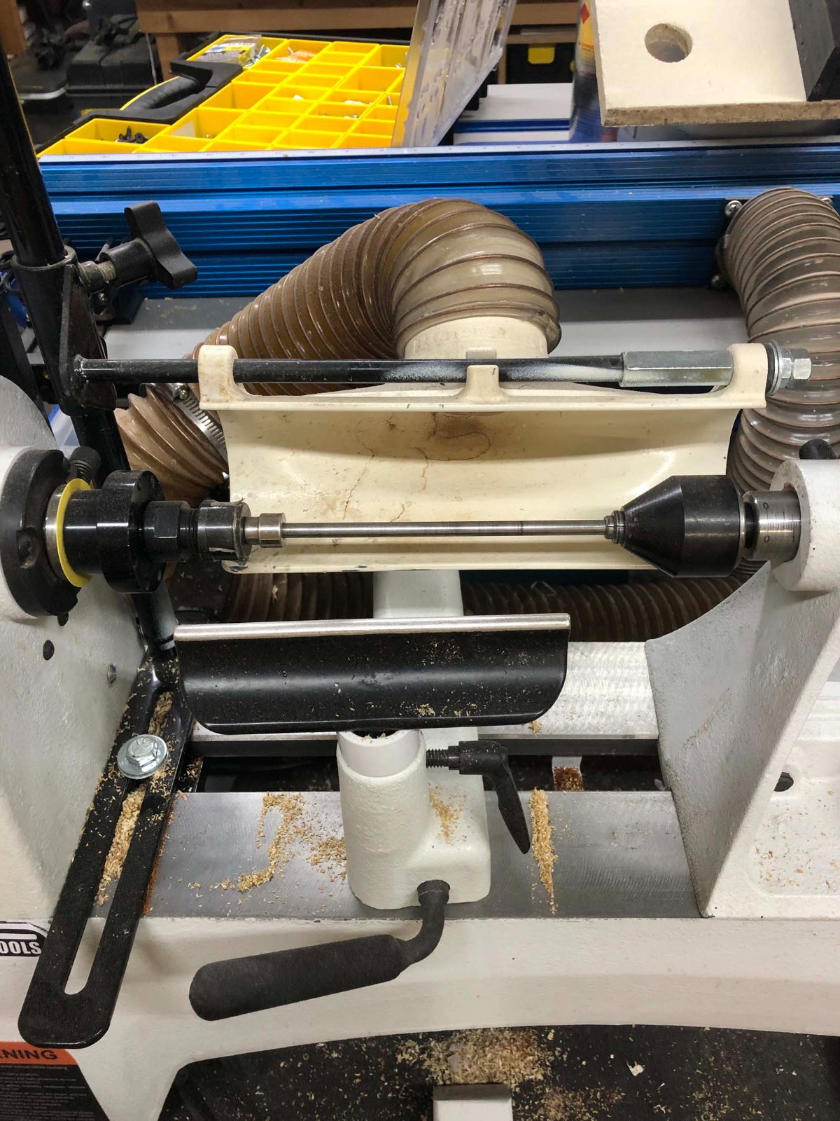

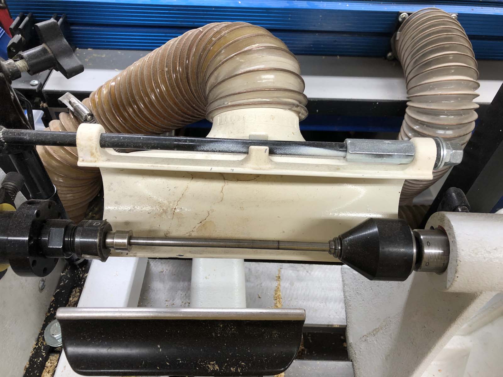

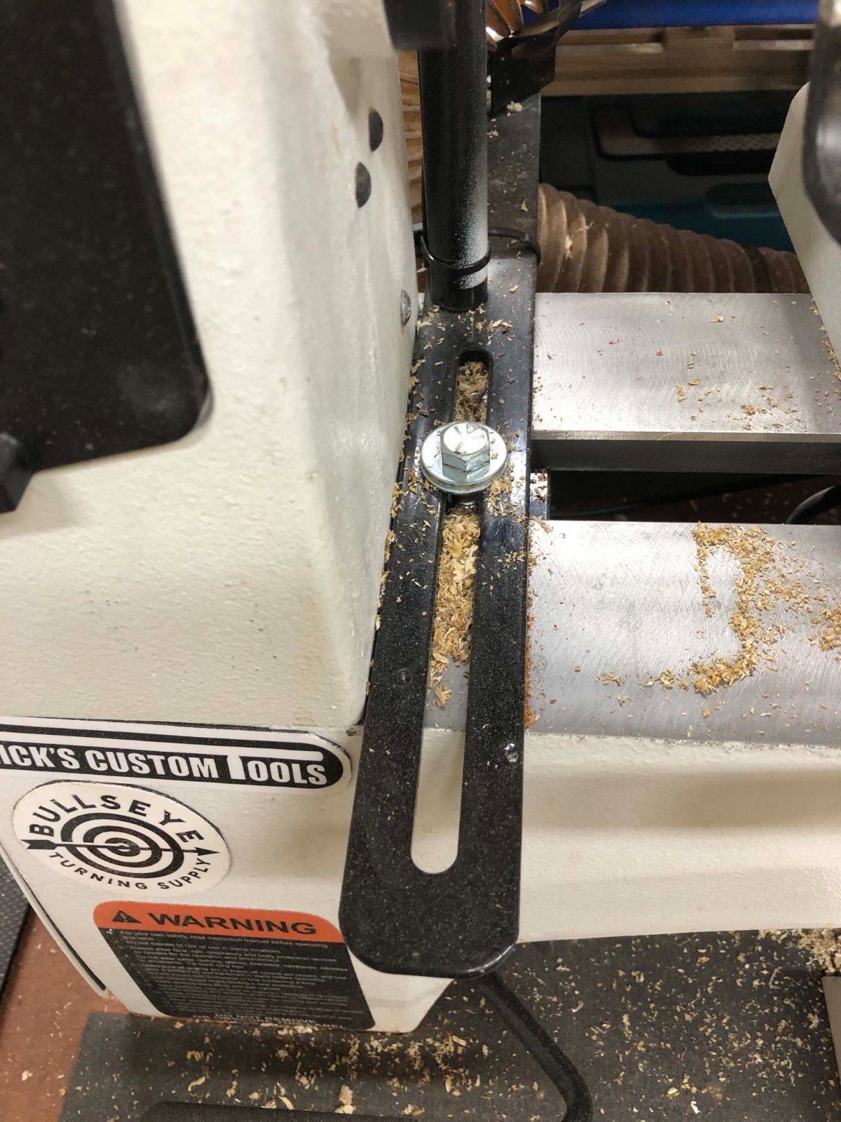

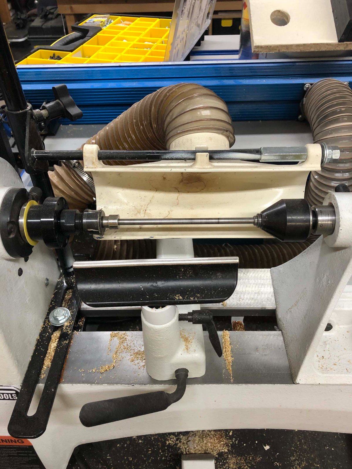

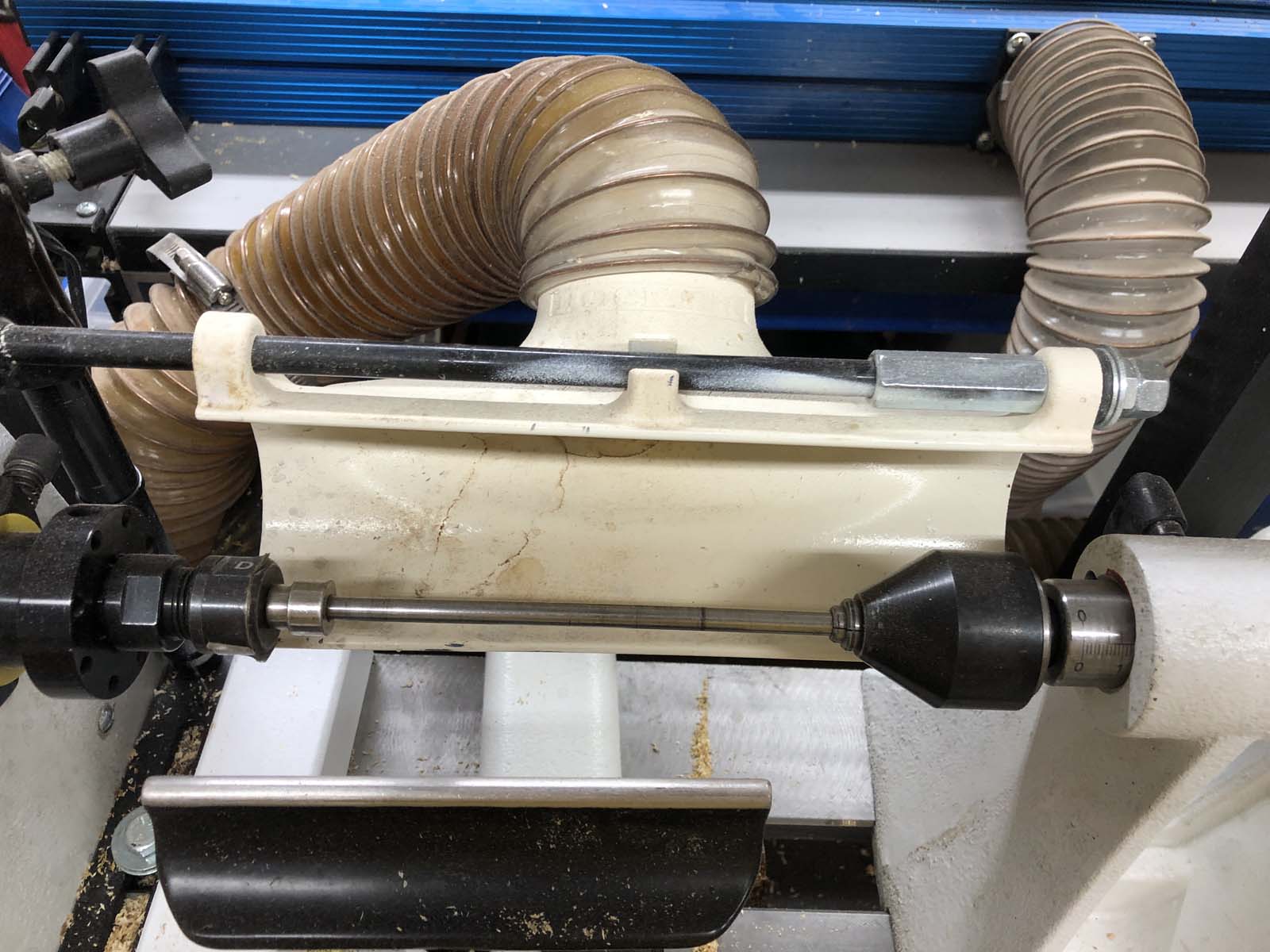

I use the Rockler one that you linked for my JET lathe; however, I used a different locking nut underneath on the ways so I could position the mounting bracket closer to the headstock. I also extended the rod that holds it using a piece of threaded rod and a coupling nut so I could have the "business part" farther away from the headstock. Oh, since I had it apart I also painted it so that it better matched the color of my lathe - and swapped out the hose for a more flexible, clear one. It doesn't resemble the Rockler one much anymore, but it works great for me. - Dave
Here is a picture or two.
PS For a Shop Vac based system, (like mine is), I highly recommend an Onida Dust Deputy Cyclone Separator. I used the deluxe kit that came with the bucket and casters. I also installed a HEPA kit on my Shop-Vac. After three or four years of use I still have a clean filter - between the Dust Deputy and The Vacuum Bag even the fine dust is being captured before it hits the filter. Still on my original collection bag too! - Dave
View attachment 384712 View attachment 384713 View attachment 384714
I typically move my tool rest out of the way near the headstock when I'm sanding/finishing. Does having that attachment piece right on the lathe ever get in the way?

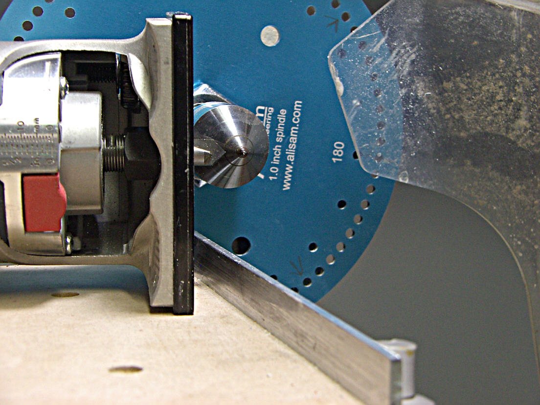

Not at all for me. It is in the back of the lathe. The one thing that is not a big problem but a hinderance sometimes is when I use my router set up on my lathe and need to use the indexing wheel. The locking nut and bolt line up with the edge of the dust collector but I just move it down a little more and it is out of the way. So easy fix.

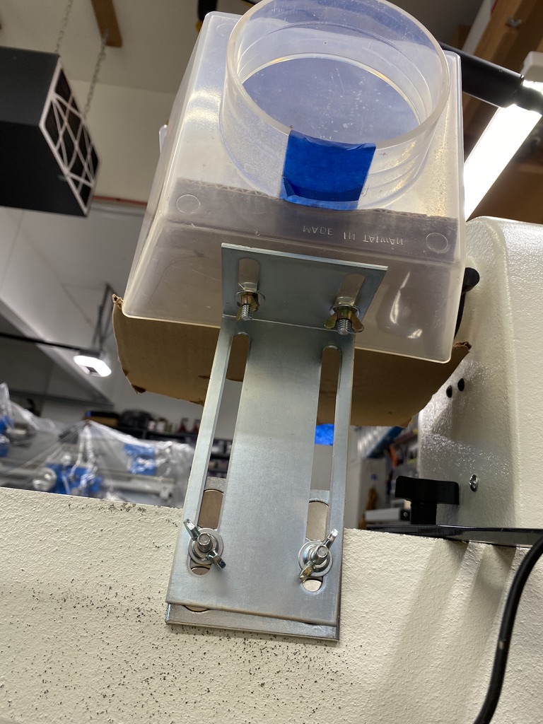

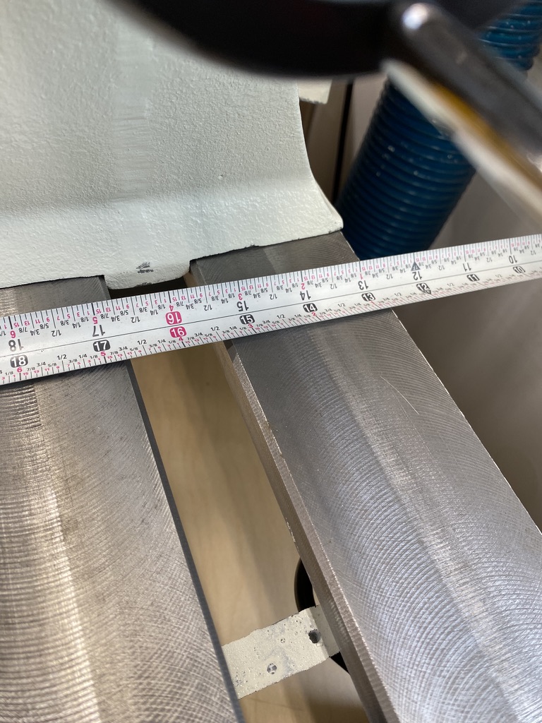

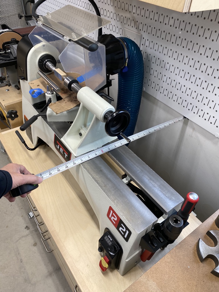

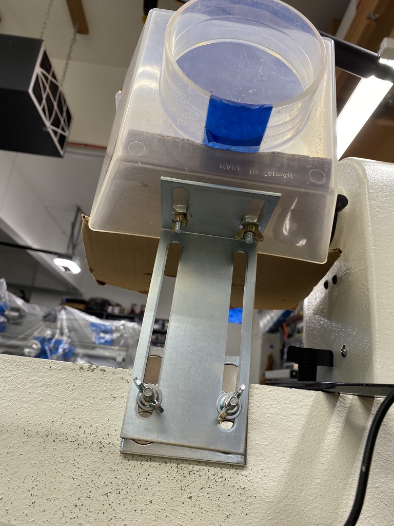

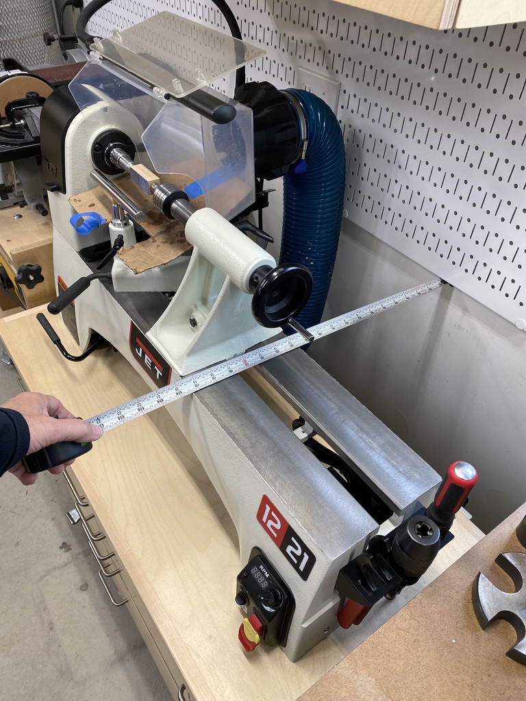

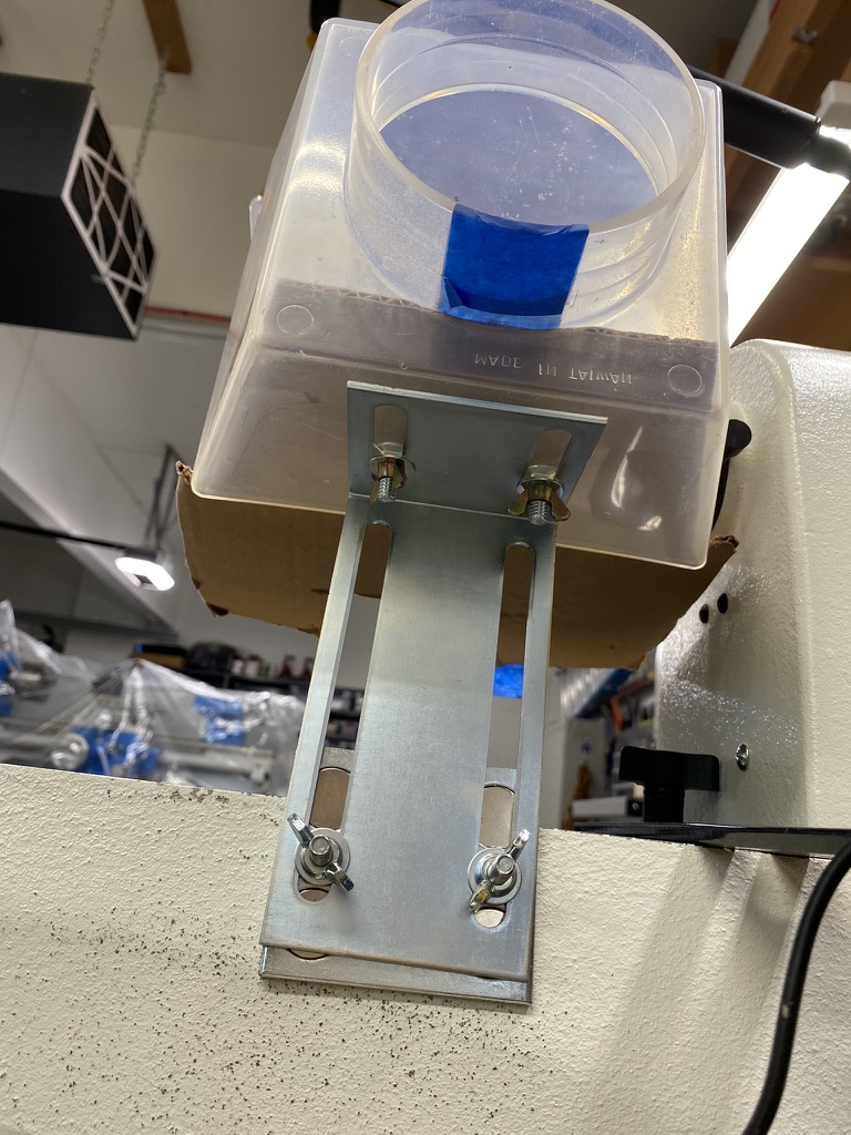

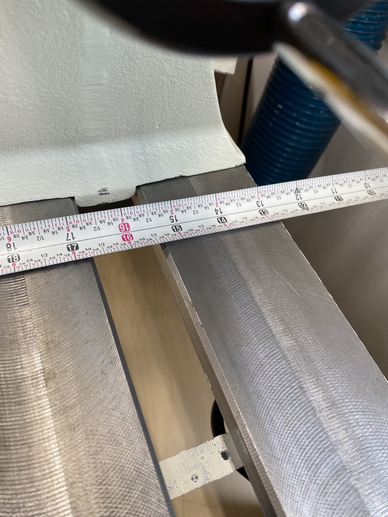

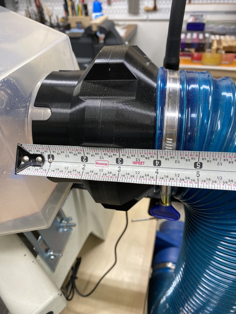

out of curiosity, can you post a photo of how the magnetic looks on the back of your lathe? I'm going to be rearranging things in my shop this summer and my lathe may get moved closer to a wall. Curious to see how yours looks and get a rough idea on clearance that might be needed.
Hello Kent. Yes, I'll take a few photos and post them later today.

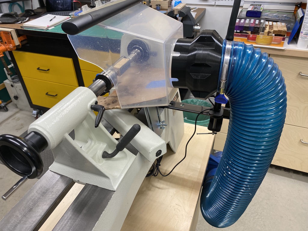

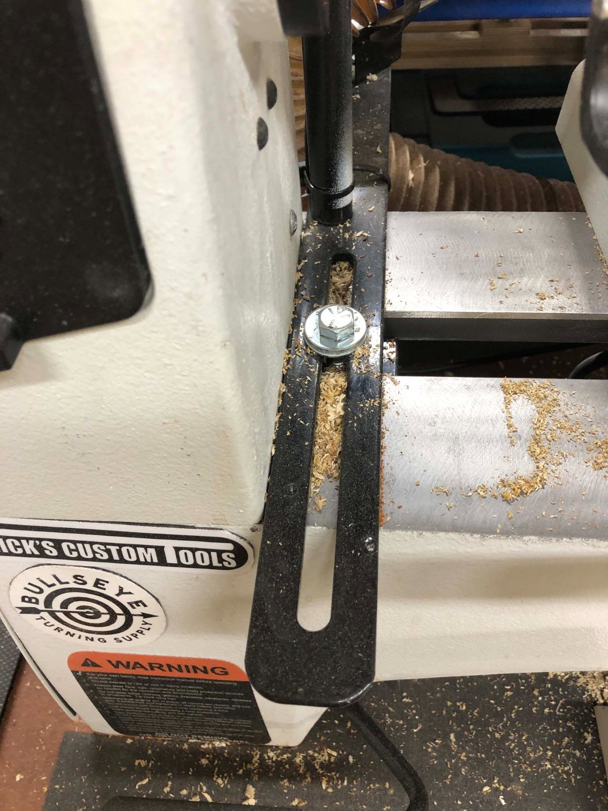

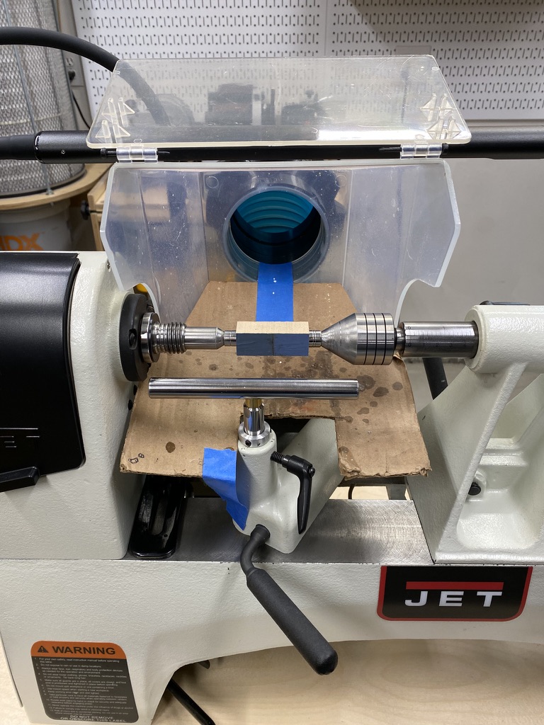

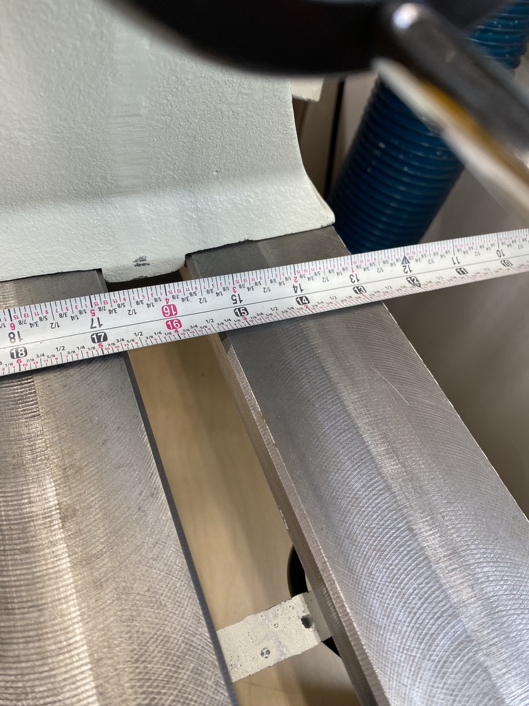

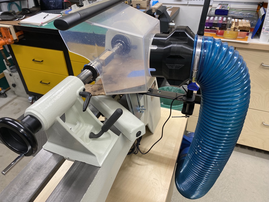

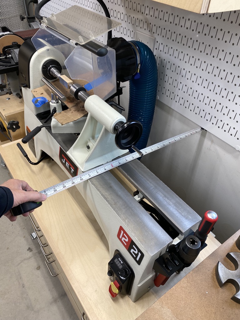

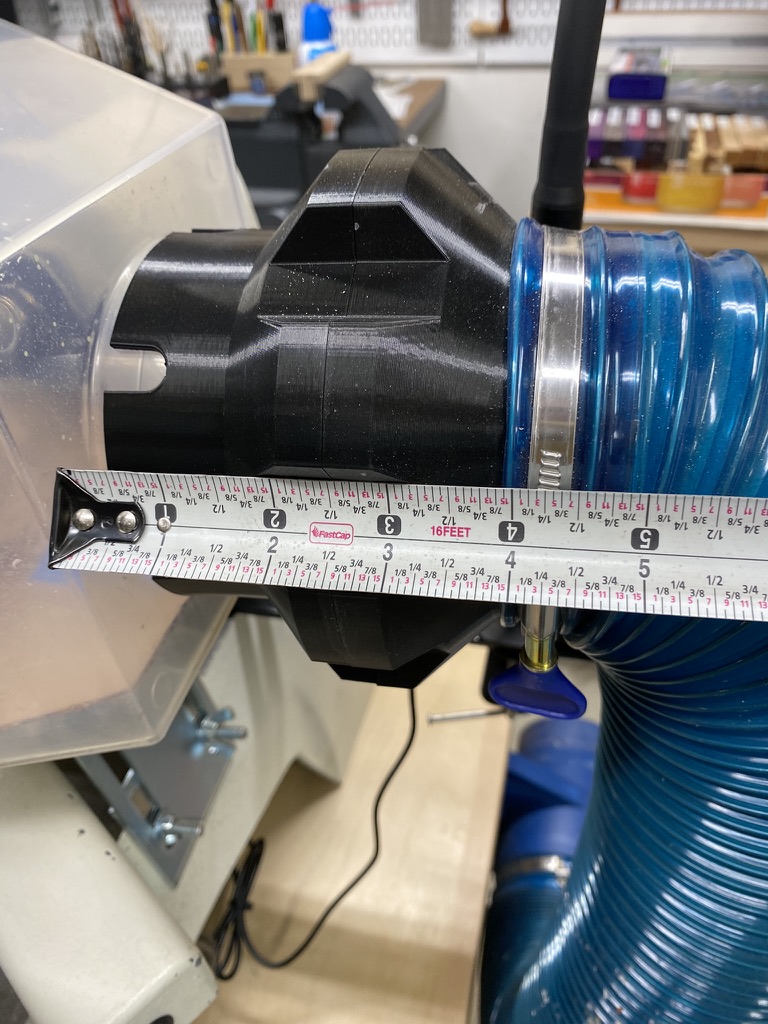

Kent,

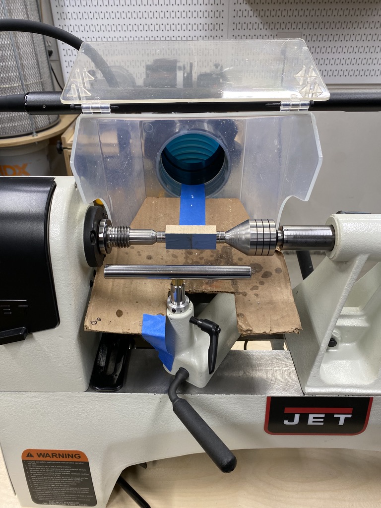

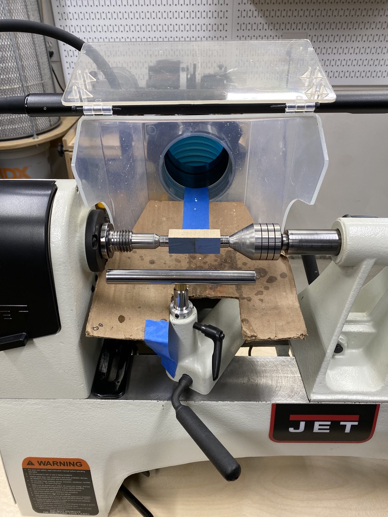

I don't use it up against the wall, but do store it that way, so one photo shows that with the 4" dust collection hose connected the wall is 16" behind the centerline of the lathe. I have another photo that shows my 3D printed magnetic dust collection fittings adding about 4" to the back dimension. I'm not sure that you would get all 4" back, but maybe 3" of it.
The cardboard in the throat of the dust hood is to help direct the air flow across the work. It makes a big difference.
Please let me know if you want a different angle photo or other measurements.
David
C8339AD1-9F09-4708-8385-585FB0088952_1_105_c.jpeg90CF615F-0D61-4F70-924B-8CB5C5C48304_1_105_c.jpeg496E17A9-3C6A-438B-9C10-F1A659C041E4_1_105_c.jpeg
E5BFFC43-E556-4851-8BB6-E596590A09C9_1_105_c.jpegC2B47D3B-EECB-4997-9C2A-AE6244C8EB60_1_105_c.jpeg1332C75F-1689-4E04-8076-632AE350A4A4_1_105_c.jpeg
Kent,
David
View attachment 384789View attachment 384790View attachment 384791
View attachment 384793View attachment 384794View attachment 384792
Thanks so much David! You've even magically chosen the correct lathe to show in the photos! I take it your lathe is mobile in the shop? Care to share photos of the setup? Like I said, still in the design phase here in Chicago.
I had to move my lathe from my work table to do some bandsaw boxes and might try to build my table before moving the lathe again. I'm fully capable of moving it but that sucker is heavy
You are welcome Kent. The Jet JWL-1221VS is a great midi lathe, and yes, it is a heavy little bugger.
My shop is a single bay in our garage and I still use it for my car, so.... EVERYTHING is on heavy duty locking casters. Even the things that I don't move often. It would be nice to have a dedicated space, but that isn't in the cards right now.
When I use my lathe, I pull it out from the wall and put it perpendicular to my main work bench. It takes literally 60 seconds to move it out and connect the dust collection to it. I have workspace and everything I need close, either in the lathe cart/cabinet, workbench/drawers, or wall cabinets over the workbench. When I'm done, I clean up and roll it back.
I'll take some photos and post them later today. I think my comments above will make more sense then.
