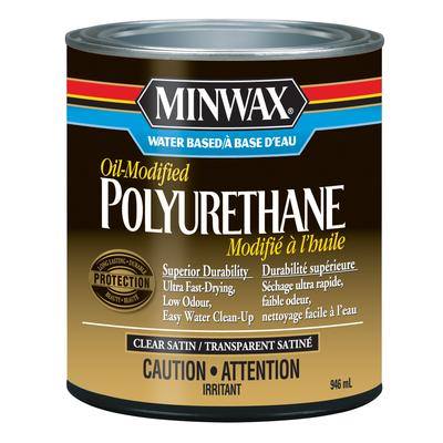

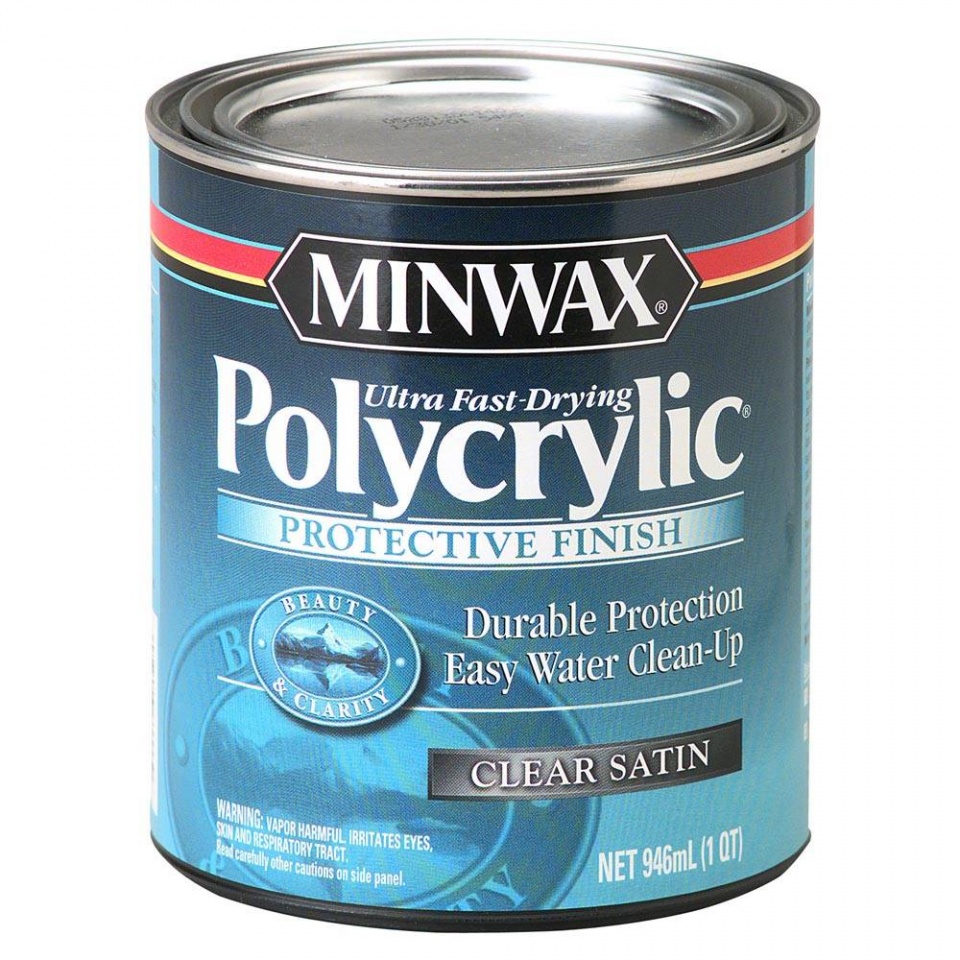

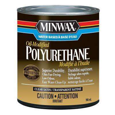

Either of these will give you an easy to apply, hard, durable finish using the Dipping method.
Les
