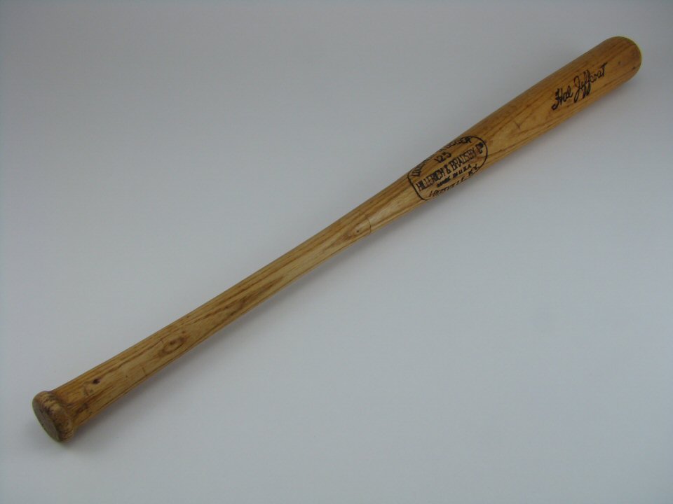

This is a recent project that I had a lot of fun making.
It will probably end up as a gift for a baseball fan relative of mine.
The bat is an antique miniature that I picked up at a garage sale. It's just over 16" in length.
To preserve the "old" look & feel, I gave it a light buffing with a scotchbrite pad, and then rubbed in some True-Oil finish.
The guts are from a Panache kit.
Bill

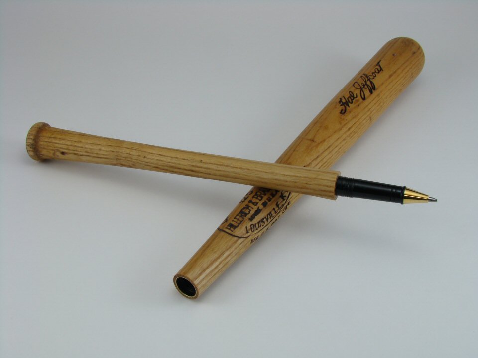

Looks great, did you get one certain pen kit, or did you built it out of multiple kits?
Hi Bill,
All of the parts come from the center section of a "Panache" kit from CSUSA
Artisan Panache Pen Kit | Pen Making | Craft Supplies USA
When the innards are glued in to each half, the small trim ring is left off of the handle end of the bat, and the protruding part on the barrel end is faced off flush so that I could have bare wood mating with bare wood when screwed together, instead of having the black hardware exposed like you see it on the kit pictures in the link.

Awesome, thank you for the link and the knowledge. I was kind of scratching my head trying to figure out how you did it.
Great job! I especially like that the grain lines up when the pen is closed. To me, it's those details that make the end result special.
