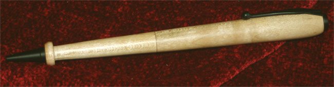

not an expert at this but realy quick explanation for slim line baseball bat pen. Make the lower barrel (writting end the handle) you would turn this like you normally would except for the design. Turn the upper barrel like a solid body I personally have a mandrel that where Knurled nut usually goes on filed an x into the end of it to give me 4 point at the end to help turn the solid bodies. Place body on mandrel bring tail stock up tight so that mandrel turns the body and turn away. The only problem will be getting the upper and lower barrels the same size where they meet. I usually use callipers. Hope this helps.

In my album is one of the ones I have made.
I used a S/L kit and just turn them as one piece (no center bushing). I just turn the handle down to normal s/l diameter and go up from there.
EDIT
I guess I could expand that a bit. I prepared my blanks as any slimline, but when I turned them I used no center bushing. After turning and sanding I replaced the center bushing before finishing as to not glue the blanks together. Then just assemble without a CB. It could easily be modified to turn close ended which may help the scale a little because you could lengthen the bat. But I'm lazy.

Here's one I do with a slimline kit. Use the clip and finial or leave it off. I have some pictures of the closed end baseball bat pens in mu photo album here or at http://www.tinyurl.com
