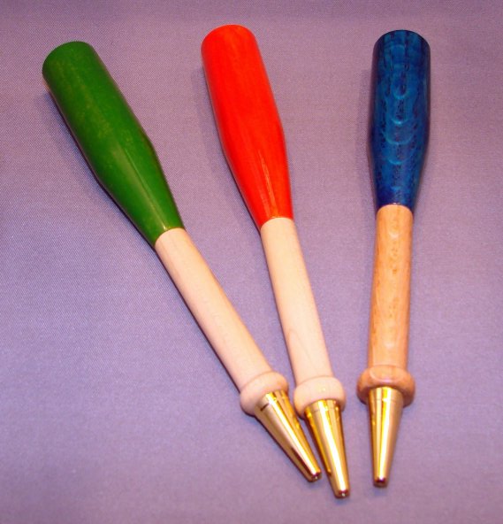

I use slimlines to turn base ball pens. Here's some from a few years ago I turned when my grand daughter and two friends got moved up to varsity softball.

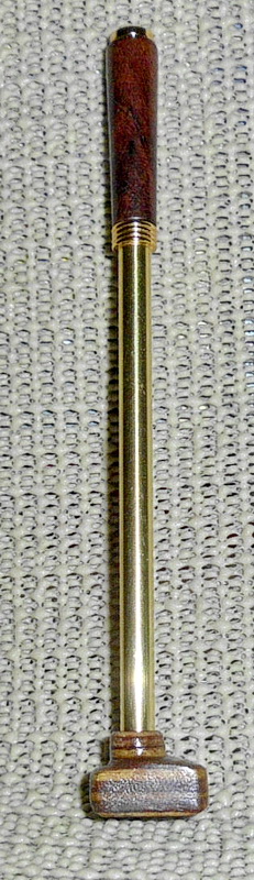

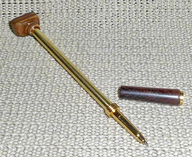

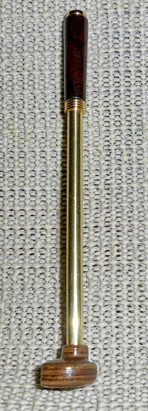

You can buy a baseball kit from Rheising I think thats the spelling :) kits are cheap ,but not the postage as it's all courier delivery. These kits have a 6 mm tube and take a full size cross type refill , I have made quite a few of these as novelty pens , I finished one yesterday made into a golf club ,not my best work but customer liked it hehe, I'd put a link for the kits ,but you have to sign up as a member of the site to get access (Free hehe) , but here's some pretty ordinary pics of the finished product , the grip part pulls off ,and the nib unscrews to change the refill :) cheers ~ John
