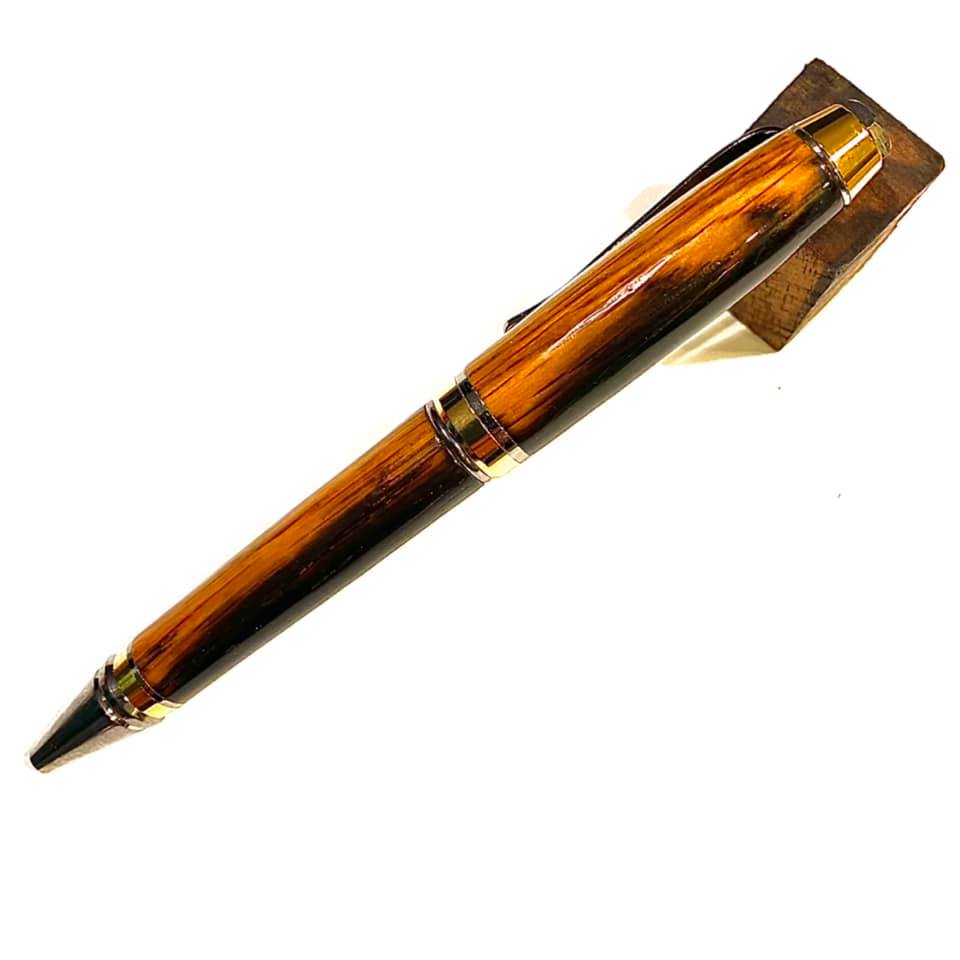

Obviously the smoky black part comes off during turning, unless you cut and re-glue it or something like that. The question I want to ask is:
Does the pen blank retain some reminiscent fragrance of the aged liquor after pen is turned, or is it basically an oak blank with an interesting history and documentation?
So you can retain the char if you do it right. You just have to drill offset a bit so you're right at the char on your finished diameter. I believe Stadium Pen Blanks has a great offset drilling tutorial either on their website or youtube.
Not my photo but this gives you an idea:
As for the smell, you'll ABSOLUTELY smell these when you're turning them. Once you put a finish on it, that smell will be covered up. You could retain a small piece though I suppose to go with it for the smell. We're making these a full 6" long so there's enough for 2 Sierra pens and leftover from a capped pen.
