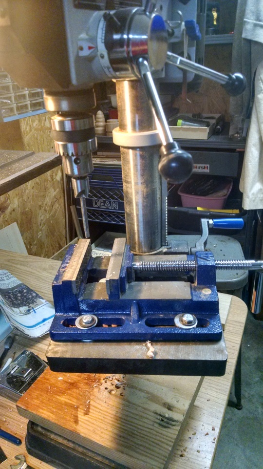

I'm just the opposite. I got tired of setting up the lathe to square a couple of blanks. I have a DP that is pretty much dedicated for penmaking. It only takes a few seconds to change from pen mill to drill bit. It is easy to do one blank or several blanks. Attached is a photo.

Hank, I have seen the pen mill stop or slow down. I have learned to take it slow and use light pressure on the DP. Better to take a few extra seconds than start all over with a new blank.
