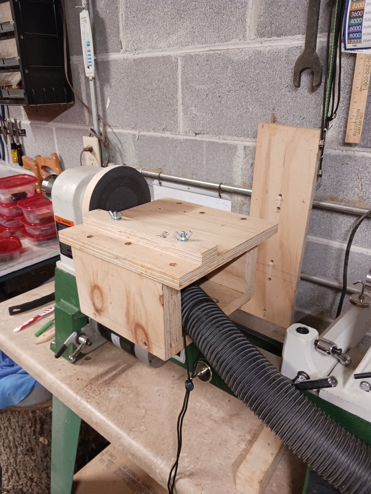

Do away with trimmer and convert to sanding on the lathe. better control. I converted many years ago and glad I did.

Thanks for the reply John. Yes, I also have a setup for using my disc sander to sand blanks instead of using the barrel trimmer.....BUT....I make bullet pens out of real brass cartridges and the carbide barrel trimmer makes short work on trimming up what is needed off the brass shell cartridges. Sanding these would really gum up and where down my sanding discs quick since I do a lot of these. Hope that makes sense and I guess I should have explained exactly what I was cutting in the first place. Appreciate your comment and I may go in and do some revision on my inital post.
Been using the Woodcraft brand trimmer for several years with no problems. I have a sanding setup for the lathe but I would only use it if I have several blanks to square. Too much time for just one or two blanks.
I ditched the barrel trimmer a long time ago for wood and acrylic blanks.
