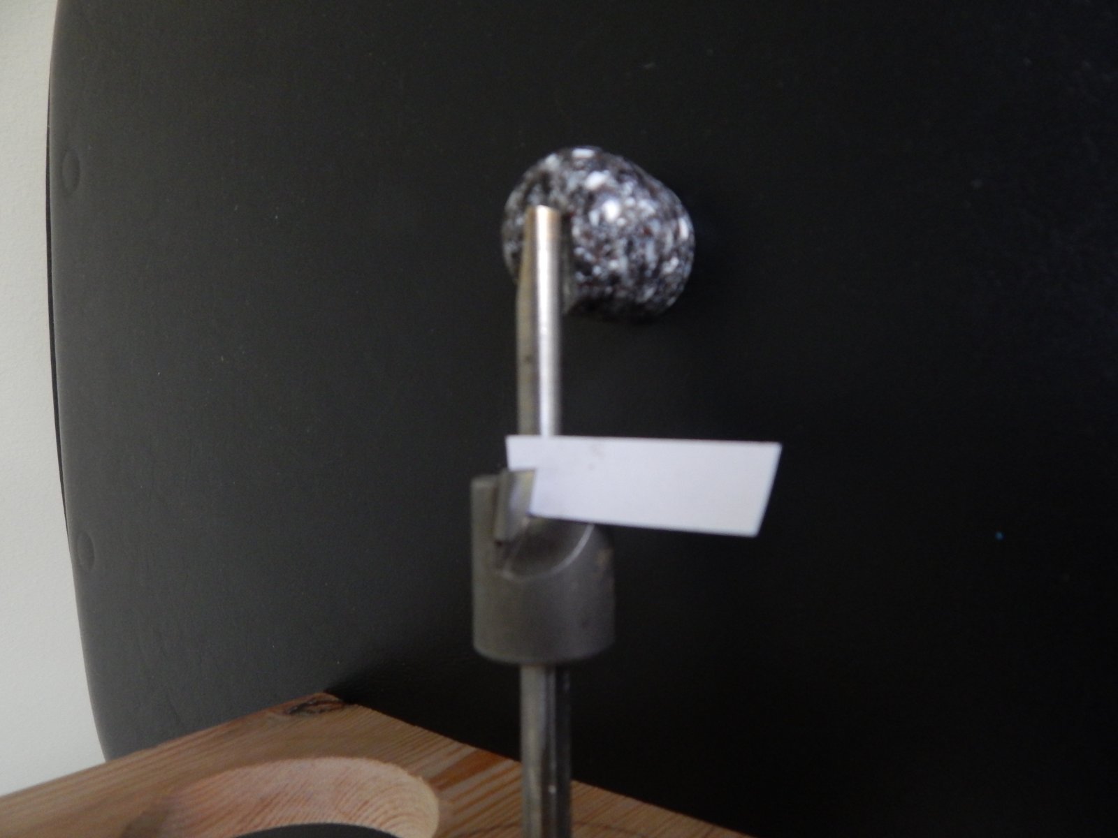

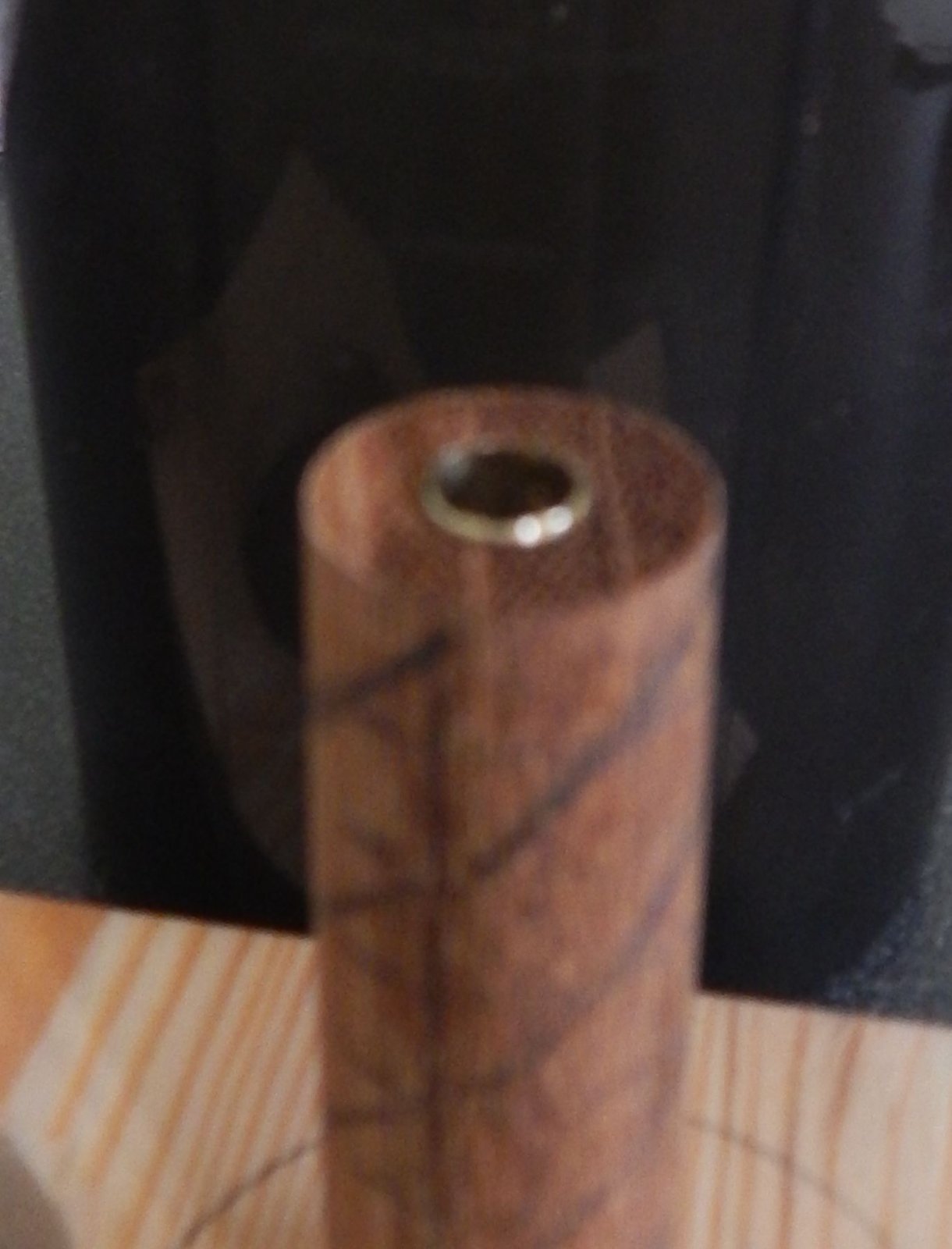

Have a problem in that I think my barrel trimmer is a cheap piece of junk. I'm noticing that when I use my barrel trimmer to square up my blank ends (Tube glued in) the wood itself is squared up but the tube still has a small piece of tube protruding outwards. Upon further inspection of the trimmer I notice a small maybe one to two thousandth gap between the carbide blade trimmers and the shaft of the barrel trimmer. I'm thinking the shaft on the barrel trimmer needs to be exactly a tight butt up to the carbide blades so the it trims the tube also flush along with the wood itself. Am I correct and need a new barrel trimmer or am I missing something that I could solve the problem Carbide blades are silver soldered to the barrel on the trimmer so their no adjustment option of moving them in tight with the trimmer shaft. Would love to hear from others and if I do need a new barrel trimmer, what is a brand that one can depend on to be well made and accurate. I'm sure mine was a Chinese knock off and of poorer quality. See Pictures below. Thanks

I have that problem when doing 7mm tubes. I finally just used a flat file to knock the burr off of the tube. I have tried different brands but they were all the same because of the changeable cutter heads. Only the 7mm tubes gave me problems, all other sizes were fine. I changed to the Rick Herrell sanding jig and never looked back.
Called Penn State Industries today and talked to a fella in tech support. Explained my problem as I did in my post above. He explained to me that the barrel trimmer I had was not damaged or defective, but out of adjustment. We talked about the issue for awhile and he enlighted me on serval things I did not know about the barrel trimmer. Most important was the fact that the 7mm (smallest) shaft had a larger diameter on the bottom half than the top. If ones barrel trimmer sits to high on the shaft one will get the problem of the gap that's happening in mine. He had me loosen the set screw and slide the shaft down a bit. After retightening, the gap disappeared. My problem was the barrel portion was to high on the shaft and this is the narrowest portion. When that happened the gap was created. Trimmer now works great and I go a good education lesson on the proper adjustment of a barrel trimmer.

If the brass tube is protruding slightly then a quick rotate of a hand countersink would remove the burr AND give you a nice soft entry for the transmission or other parts into the barrel , just an observation.
