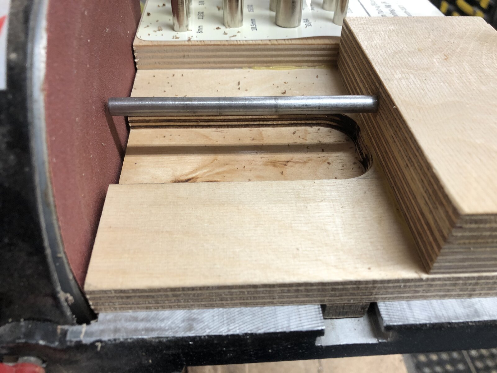

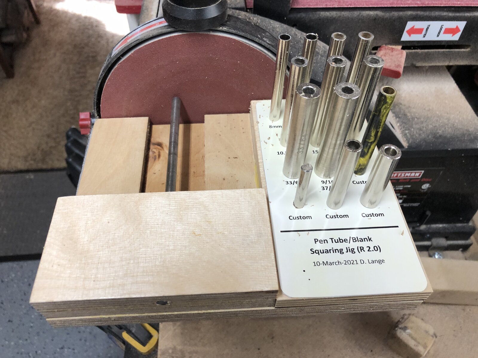

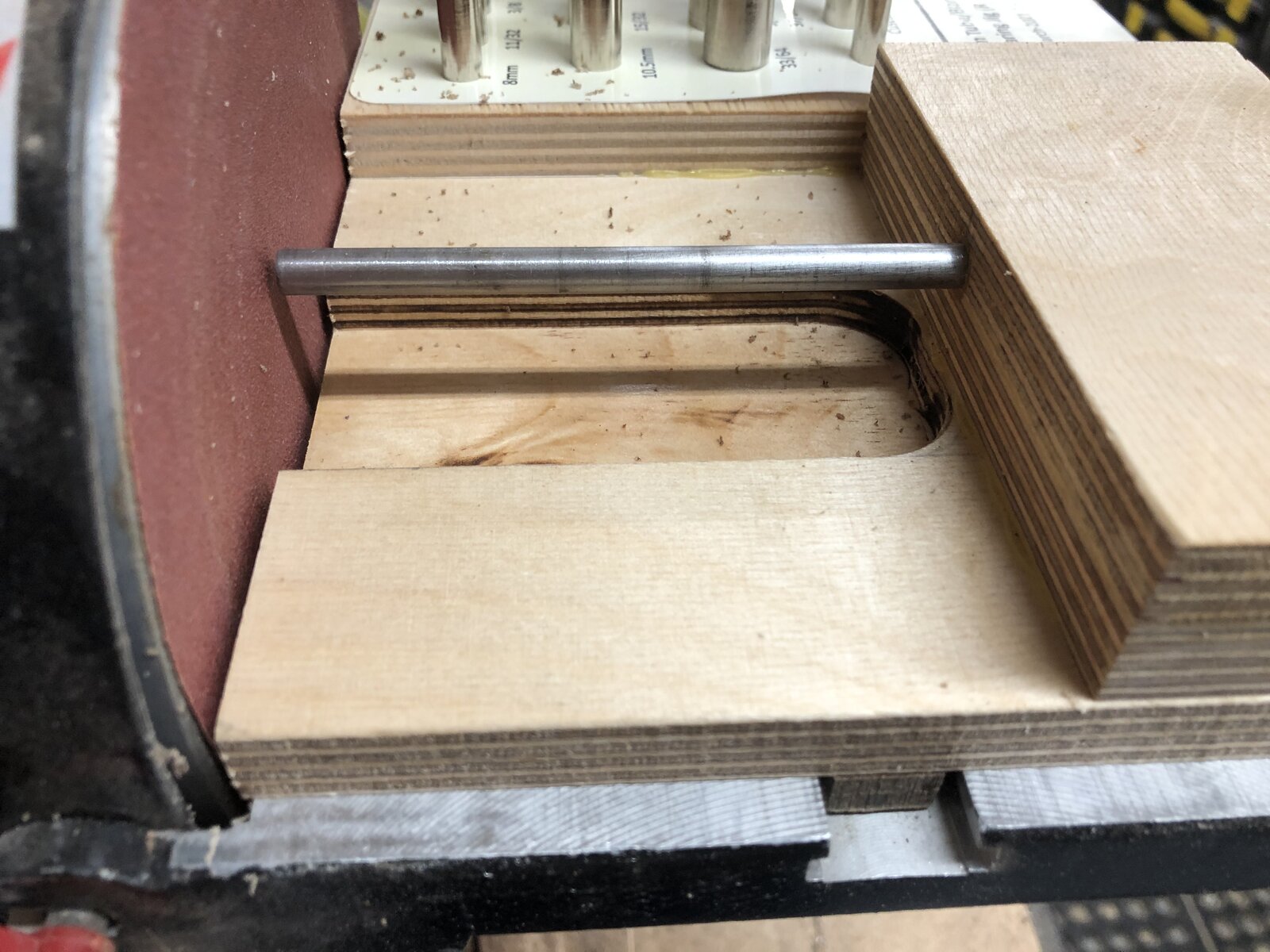

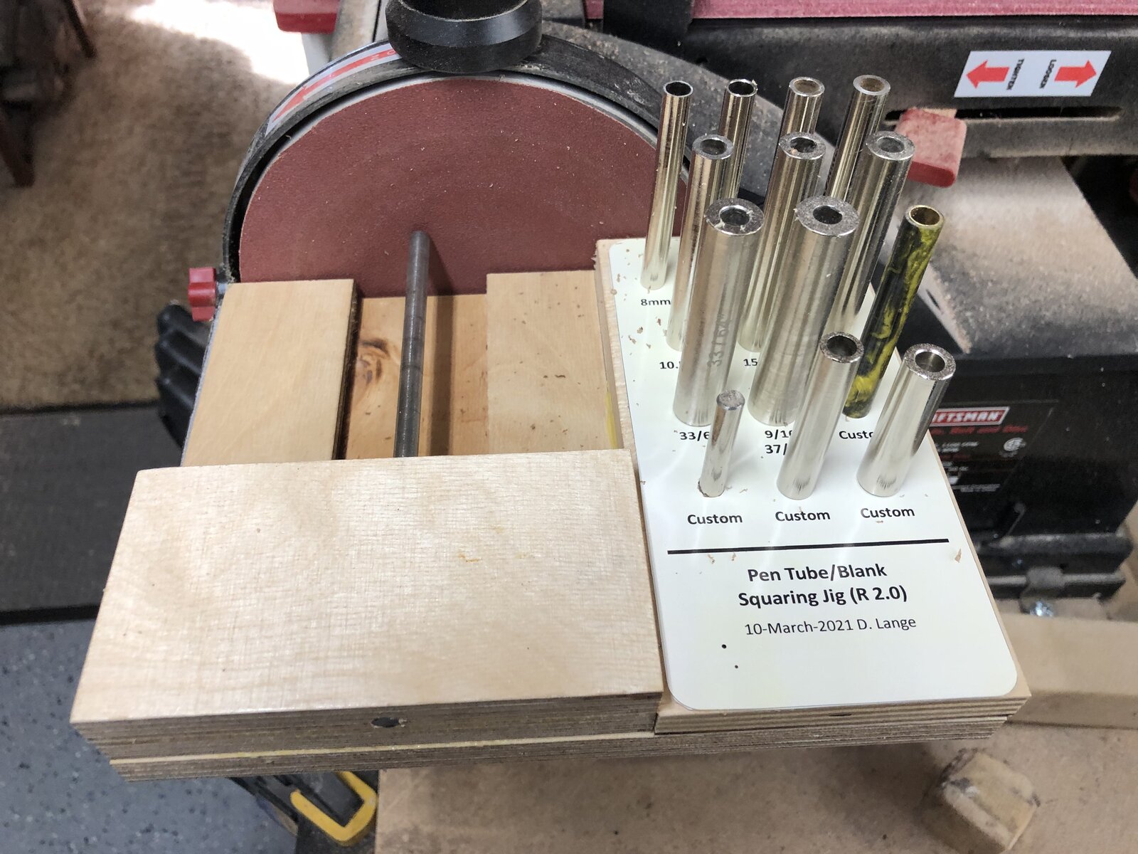

Greetings from Nebraska,
Along with others, I highly recommend using some kind of sanding jig, and especially Rick Herrell's offset Jig, especially if you don't currently have a disc sander. With Rick's jig you use your lathe to square the blank. (Rick makes all sort of pen turning tooling - and his designs and workmanship is top notch!)
Personally, I use a home built sanding jig on my belt and disc sander. As with many of the typical barrel trimmers it uses sleeves to hold the blank on the jig so the surface is square with the sanding disc, perpendicular to the center axis of the tube. (I started with a purchased jig, but it didn't fit as tightly in the miter slot on my sander as I wanted, so I built my own).
I do also have a nice carbide barrel trimmer (pen mill) that fits over various reamers so the tube can be reamed/cleaned at the same time the blank is squared, but I since I started sanding to square the blanks I only use the barrel trimmer on a rare occasion when I need to clean bits of epoxy or CA that got inside the tube and usually I just use the reamer without the barrel trimmer installed. The reamers are 7mm, 8mm, 3/8-in, 10mm, 10.5mm and 12.5mm.
Regards,
Dave
PS I also attached a couple of thumbnail pictures of the squaring jig I use with my belt sander. (Click on them to enlarge them).
