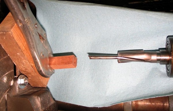

For trimming/squaring rough, unturned blanks to the correct length I use a drill press as shown here. The pic shows a blank without the brass tube - that's what I had at hand for the picture - but this is done after gluing in the tube. The blank is clamped the the visegrip and I hold it by hand. There is almost no tendency for the cutter to grab the blank, and no need for a vise. If you use a vise here, you have a dickens of a time ensuring the trimmer and the blank are in alignment. Before I turn the drill press on, I raise the blank so the guide shaft is about an inch or so into the brass tube. With the shaft in the tube the plane of the cut is automatically aligned perpendicular to the axis (or square.)

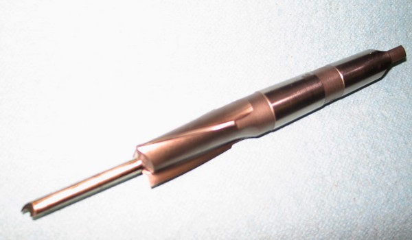

Below is a close up of the tool I use, but most of you will of course be using a barrel trimmer which has the same effect. My tool is a piloted end mill with a #2 morse taper. Since it is high speed steel I have not yet needed to sharpen the cutters. I use home made hollow tubes for shims when using this on larger diameter pen tubes.

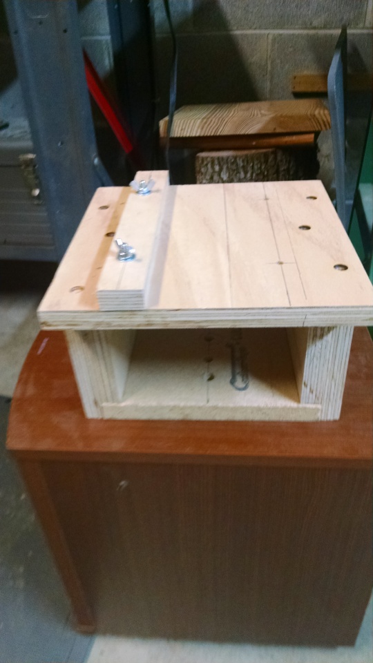

Rick's jig was a real value-add for me. I haven't blown up a blank in the barrel trimmer since I switched over, and the ends wind up properly squared every time !
