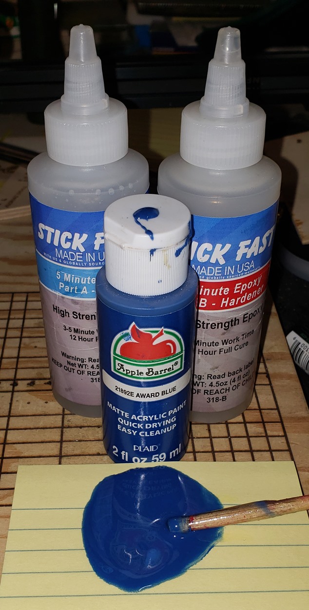

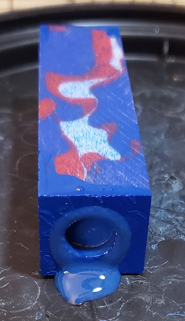

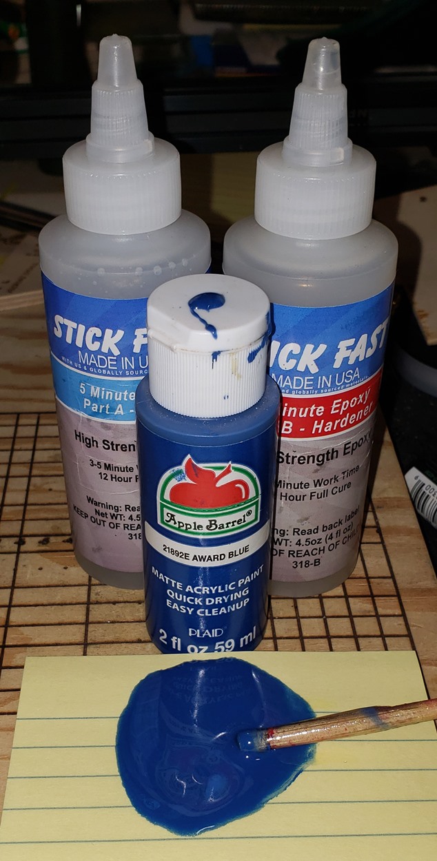

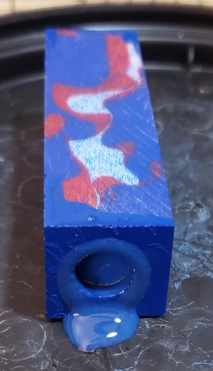

I third Mal and Ken. I NEVER use CA for tubes, ONLY two-part epoxy. Plus with two-part epoxy, you can color it with acrylic paint if necessary.
