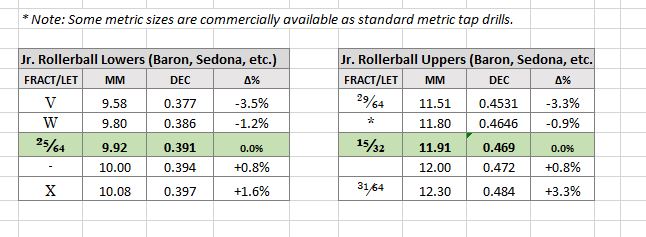

That being said, my process is to measure the tube with calipers, then depending on how resilient the material is, softer woods, harder woods, plastics, stone composites, etc., and whether or not I am planning to paint the inside of the blank, I choose a drill that seems to be appropriate based on the drills that are just slightly larger or smaller than what the tube measured remembering that I can always make the hole a little bigger - but it is problematic to make the hole smaller.
For example, the Baron instructions from Berea specify 25/64 and 15/32 for the body and cap respectively. Note that I typically tried to keep my spread to around +/- 3% on the charts, but there are usually quite a few options in the metric sizes, 11.7mm, 11.6mm, 12.1mm, etc. Here is a snapshot of my chart that would fit your Barons.

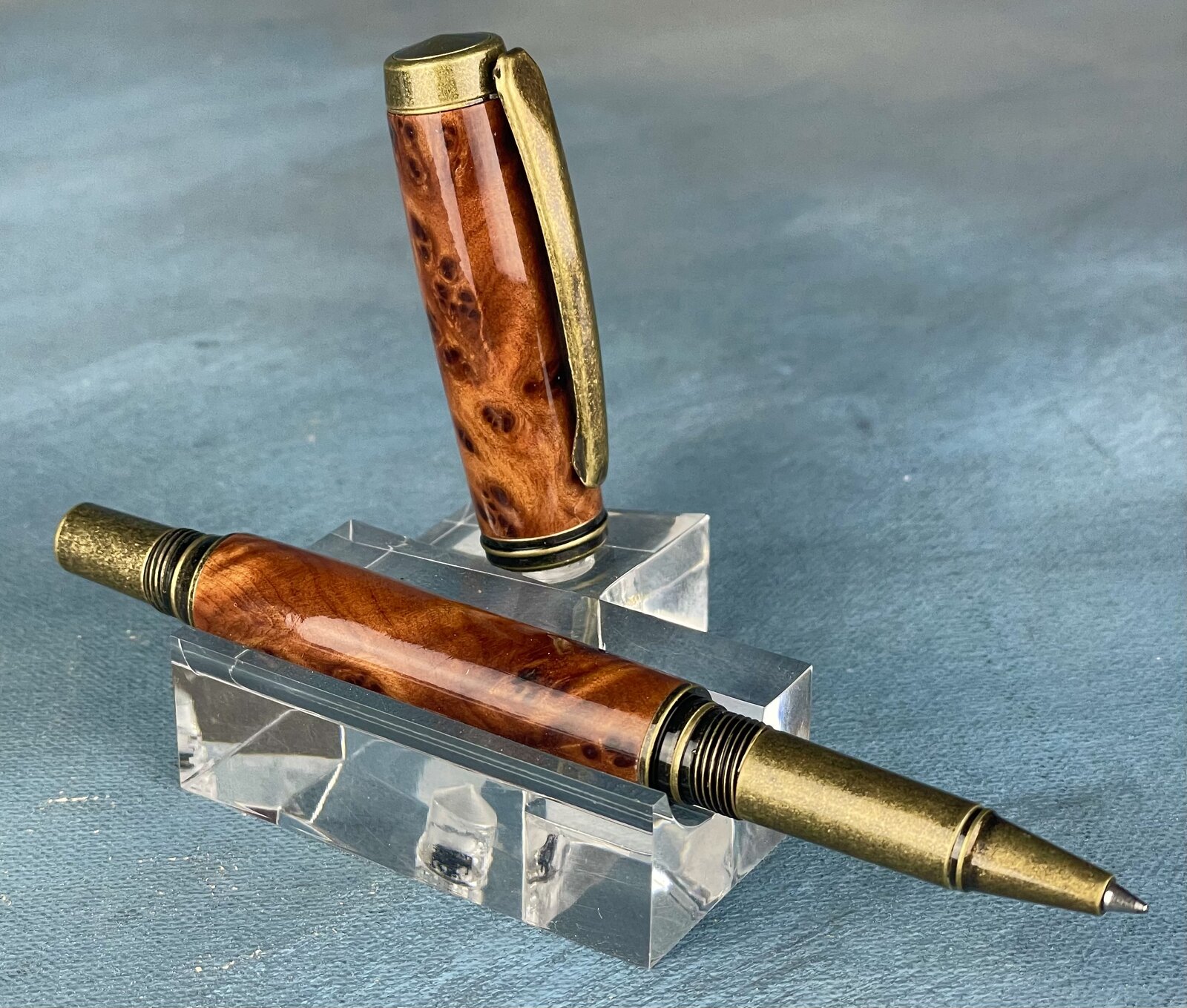

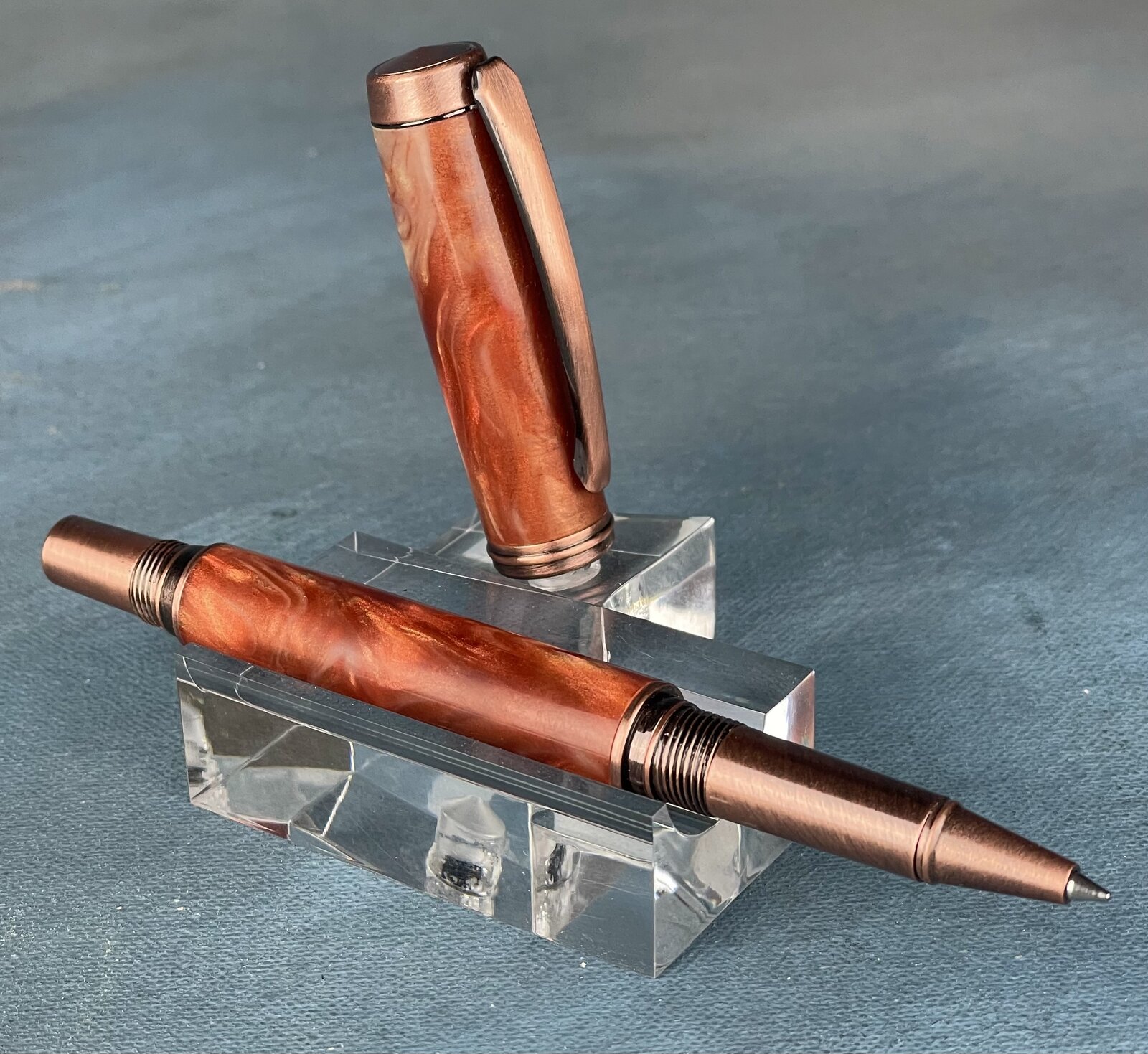

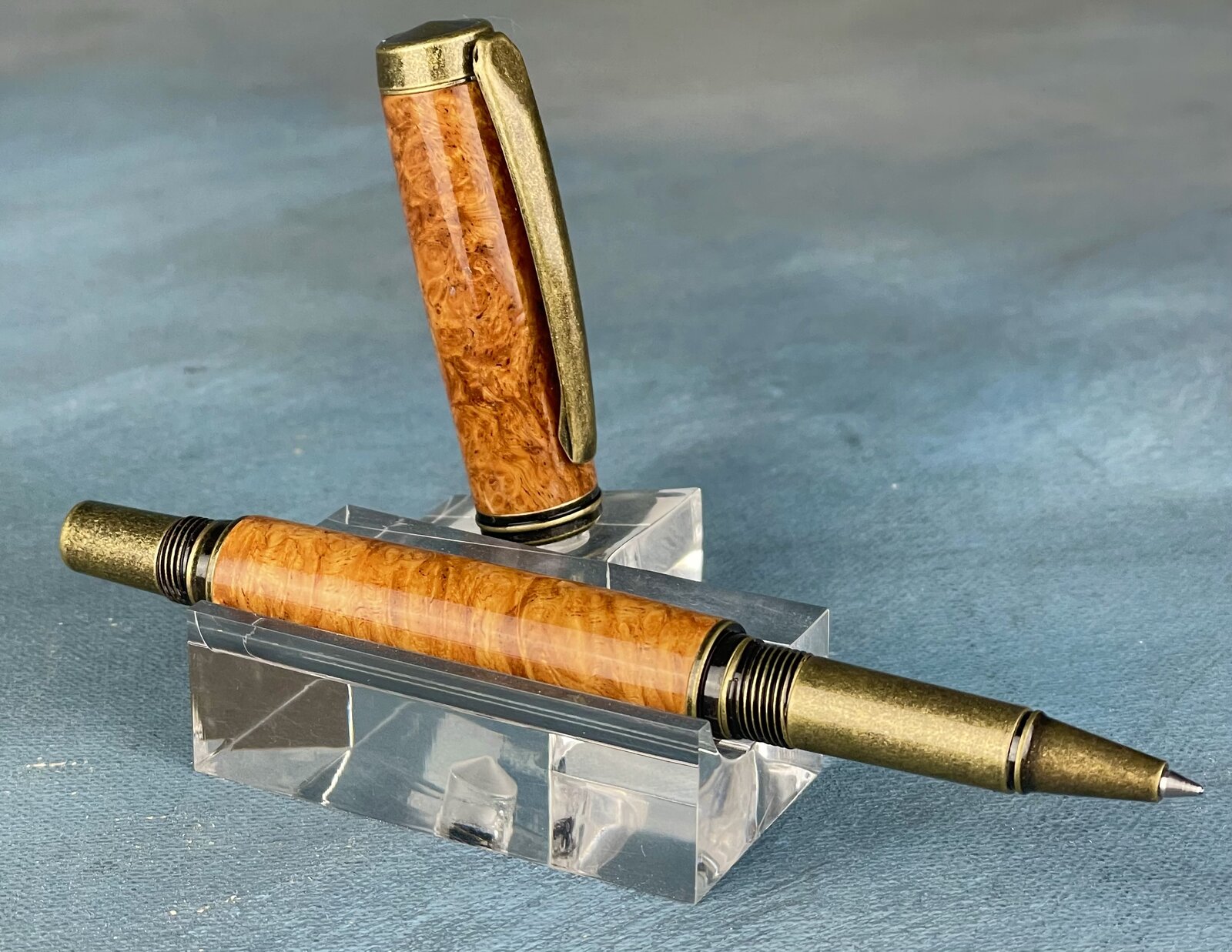

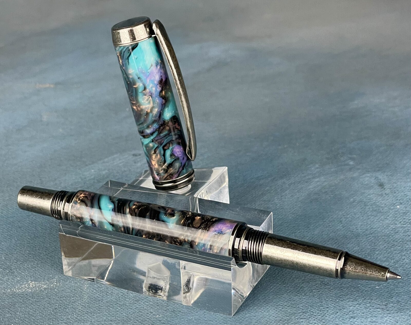

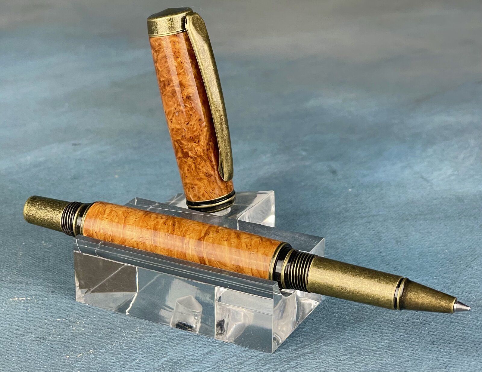

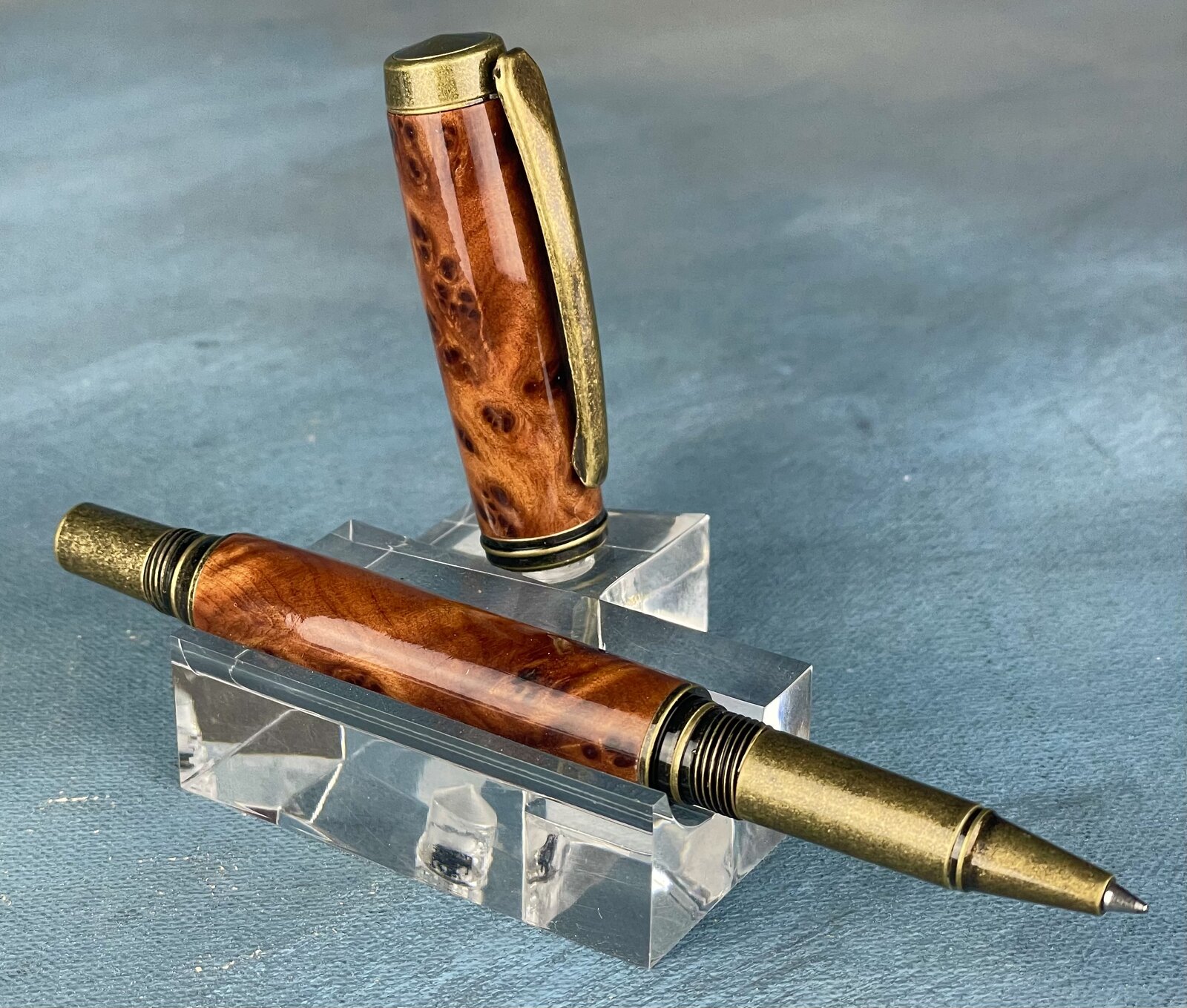

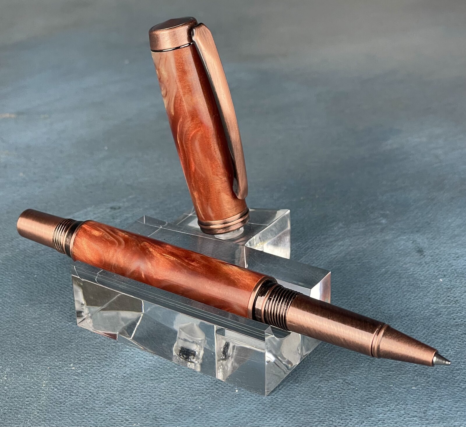

I make lots of Barons. I find the cap is almost always a tad loose and the body is tight. I have Fisch drill bits which flex and will replace them with my new standard Norseman. I strongly doubt that Norseman is anything but spot on for diameter.
Al that said, we sell quite a few and the finished pen is always perfect to the buyer. If there is a slightly larger cap hole, epoxy fills it and the hardware hides it. You'll be proud of any you make.
