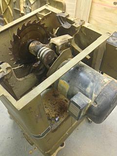

Those saws are bullet proof. PM was US made back then and very highly regarded. Being 5HP / 3 ph, it is almost certainly saw industrial use. I'd check bearings and arbor runout right away and replace anything if needed. That saw is well designed and superbly built. Price was a bargain.

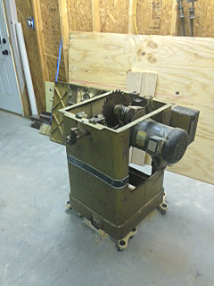

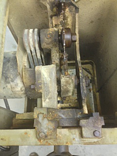

Finally got a chance to do some pics. It was pretty cruddy inside, but it seems to be cleaning up nicely. I can't find any play in the arbor or trunnion, so I think I will just clean it real good and put it back together. The top has some rust, but it is just surface rust. I hope it cleans up as well.

Sounds like you are a candidate for a Variable Frequency Drive to make that 5 Hp 3 Phase run like a champ on a 220 Single Phase power supply.
There are "buszz boxes" that will phase convert more cheaply, and with more noise, but the ability to program the motor speed, start up and slow down rates and other good things like quiet are likely worth the price.
Make sure you have amps for 5HP+ on your wire size and breaker
