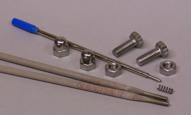

Below is a pic of ALL the parts, in fact 3 bits of these parts won't be used.
There are 2 x 316 Stainless Steel arc welding rods, 2 x 6mm S/S Dome nuts, 2 x S/S 6mm bolts, 2 x S/S 6mm nuts, Slimline refill, 1/2 a spring
The only tools that are used are
1. Drill press
2. Vice
3. Hammer
4. Pliers
5. 6mm tap and wrench
6. Hacksaw
7. Sandpaper
The bits not used will be the bolt heads and the blue plastic part of the refill. The refill will retract.
I'll let your imagination run wild for a bit, then post what I came up with. See if you have the same daft streak in you as me:biggrin:

Neil, there is a powder flux coating that is cracked off.

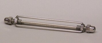

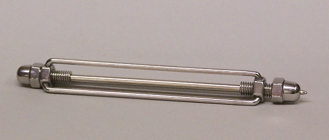

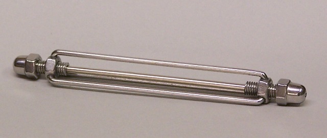

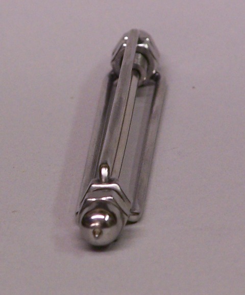

Here's what I came up with....
The 'finial' advances the refill. The front threads are 'fixed' and do nothing but match the back end. The nib unscrews to change the refill:biggrin:
My wife just told me that it was quote; 'One of the most stupid things you've made'
Jeesh, I didn't think it was that bad:redface::biggrin:

Definately ultra tech' that one sort of looks like a pen with an "exo" skeleton :) . My thought was that if you put six rods instead of three it would be a bit more "upmarket" hehe. Did you have to glue the rods into the nuts, or just a tight fit ? In any case it certainly is an inspirational concept ,cheers ~ John :biggrin:

Skippy: I think I know but am not for sure??
Why the need for #5??
LOL, I was wondering if any one would ask that:biggrin:
Once I drilled the holes in the edges (sides?) of the nuts I put a 5mm drill shaft into the nuts and pounded the rod so that it mushroomed a bit onto the drill shaft. I then used the tap to clean up the thread in the nut and at the same time cut threads into the ends of the rods. I did just one at a time. No glue. I was going to try and solder them, but my little soldering wouldn't be up to it.:biggrin:
