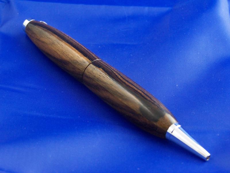

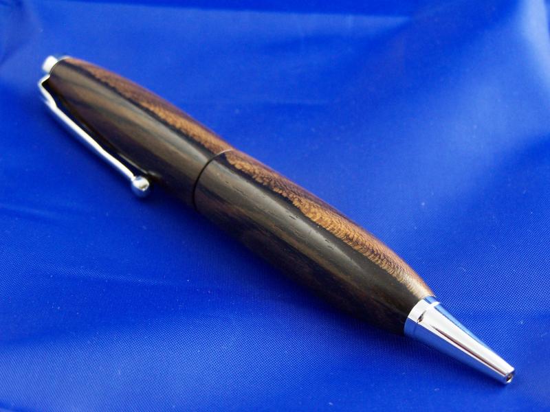

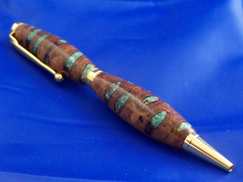

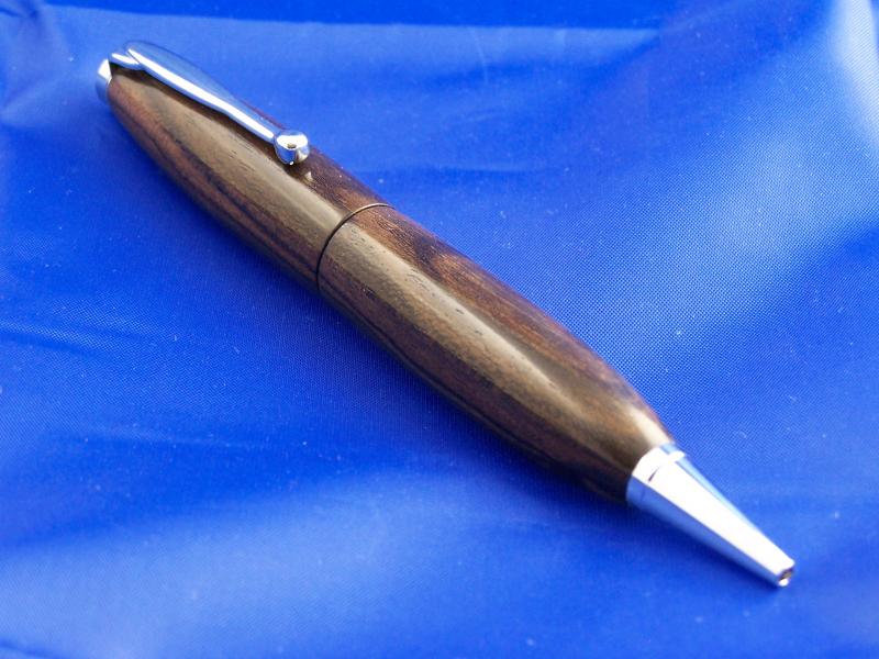

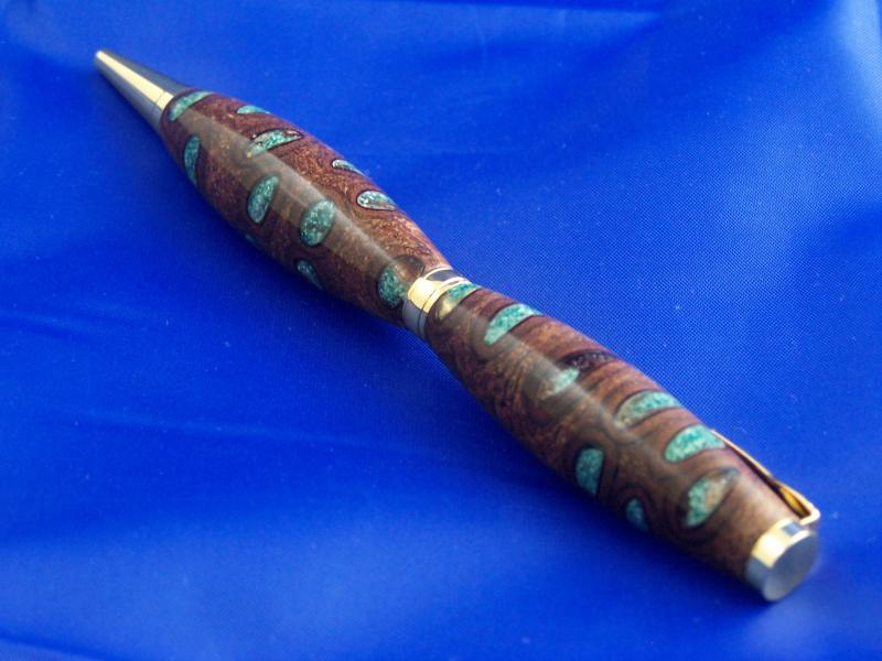

My cousin recently bought me a banksia pod to make pens with and we had schemed about it for a couple weeks after seeing one on the internet. the pen took me about 4-5 hours to make over about a week. I used green inlay and a gallon of superglue to make it work. But it finally turned out just the way i expected. I was happy because the thing didnt blow up on me when drilling,thanks to woodcraft 7mm drill bits, but the inlay came out frequently. The zircote pen was relatively easy, I had saw some fatline pens people had made and decided to try it, but i dont know how to make a center band. I used sanding sealer, high friction polosh and carnauba wax for the finish. ideas can really help me out. all complements and criticisms are welcome.
