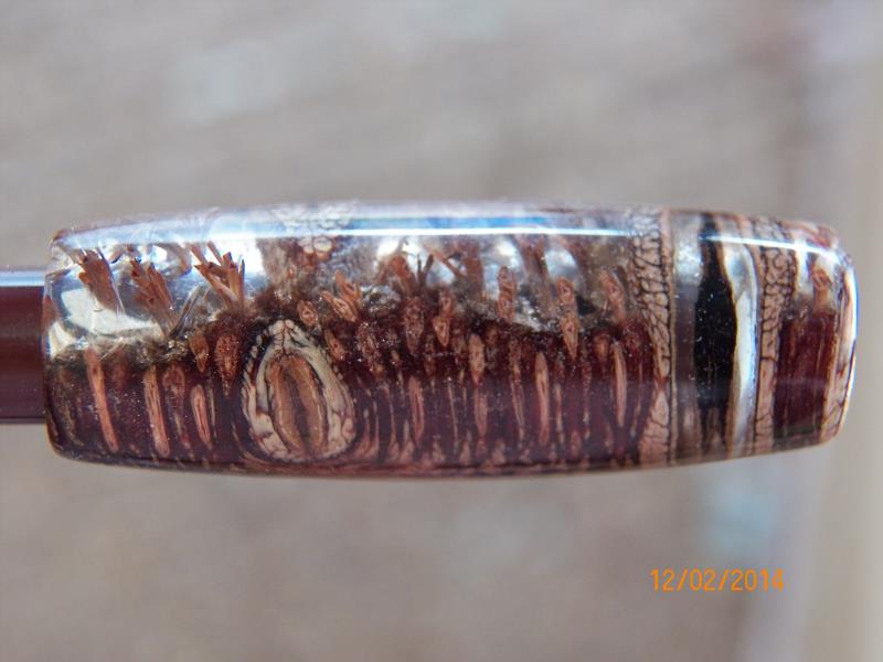

Banksia Porn!

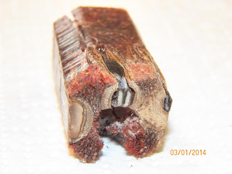

I blew the end out of mine today, i had sharp tools and i went slow, kept adding ca to it. Oh well its going to be a key chain now. Good thing i have 5 more. I really like this blank..
Mike

I always like to see the pics of the damaged/destroyed blanks and see better what happened, sometimes they can be fixed, other times not so much. Being 100% successful is not as easy as one may think, there will be always some lost blanks that in my view are the price to learn and to improve ones skills. Giving up because is difficult, is never the solution and while the bank replacement cost is now a little higher than before, is not the end of the world and not something that will cost you hundreds of dollars to replace so, I still believe that is well worth it when that blanks lets you get to the finished product and allow you to "show-case" a very unique pen, indeed...!
So, you may have lost half of the blank, I'm sure you learn something, huh...???:biggrin:

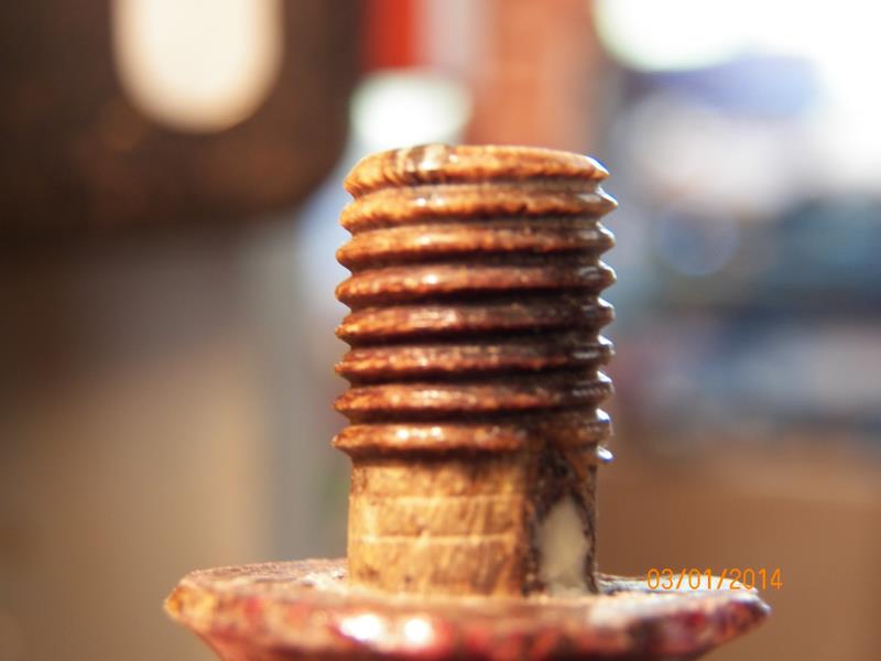

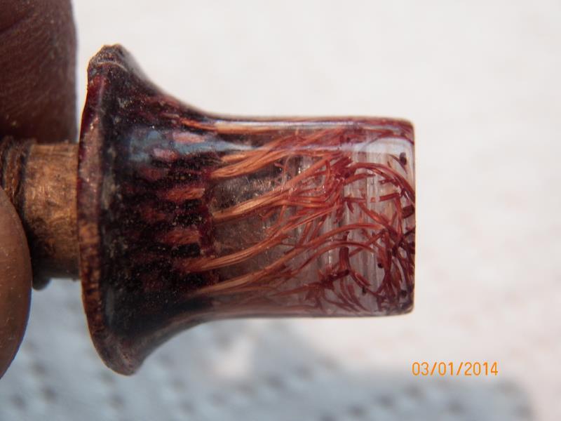

Now, you got me curious about the possibility to make a kitless pen out of these blanks, the exact ones you and everyone else got, the raw pod ones so, I just recently got 9 full blanks and 2 bits of one, returned for a full refund, all the way from the UK. In that box I had what was sent as to what was left from 1 blanks that was worked on. The sizes are a little intriguing so I reckon, someone was trying to make fishing rod handles out of them, that after a provided all the links to all tutorials and so on, I was told that, "was too much work, it wasn't worth it".

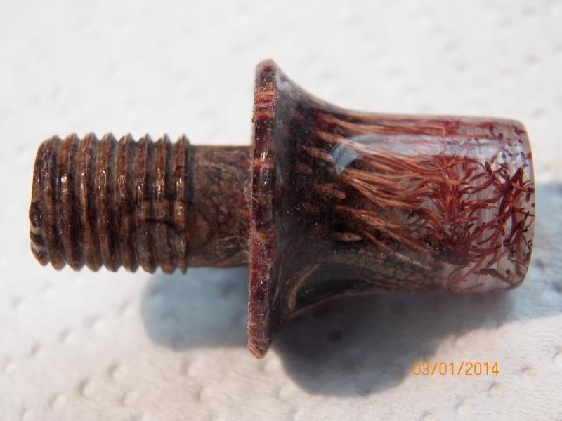

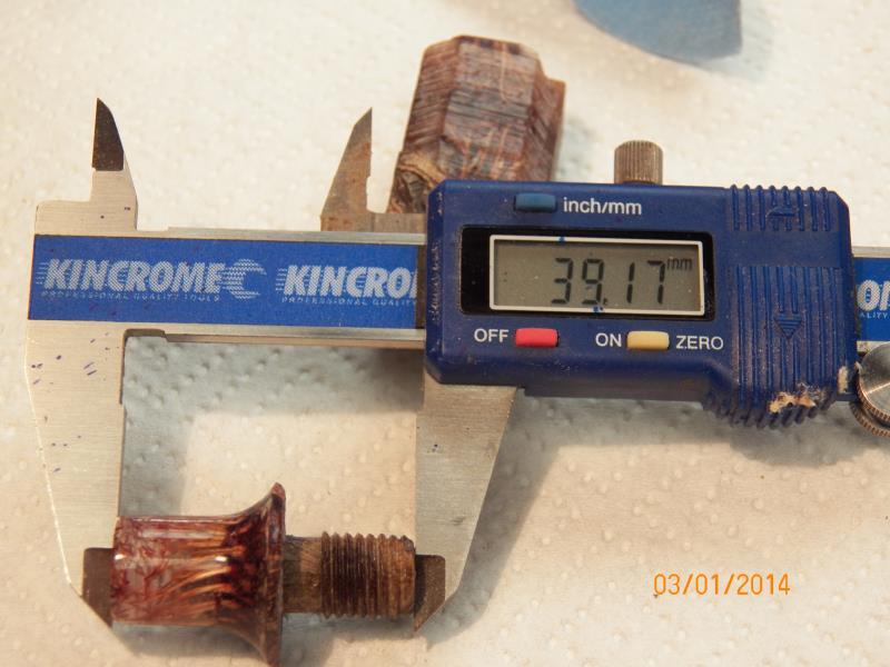

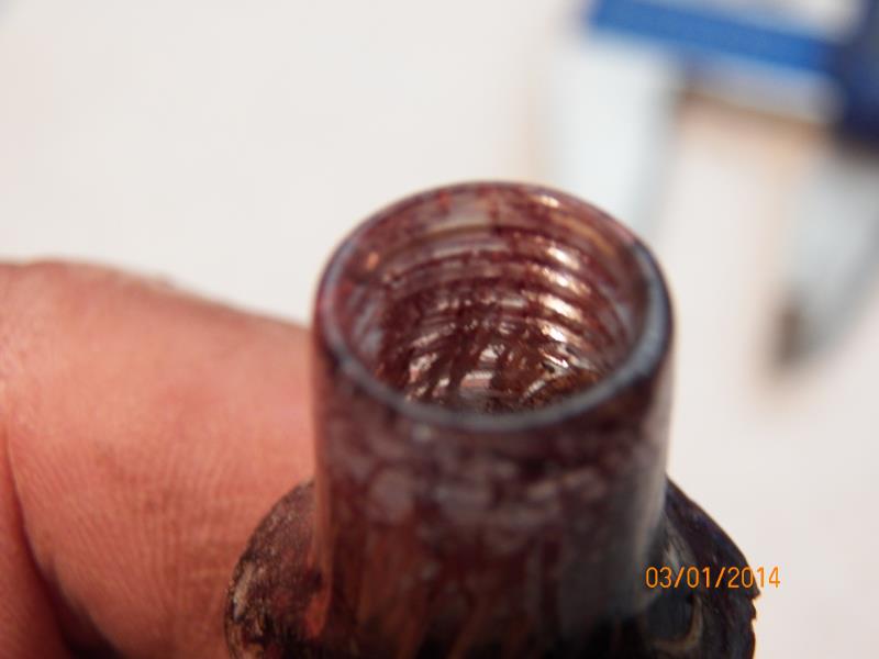

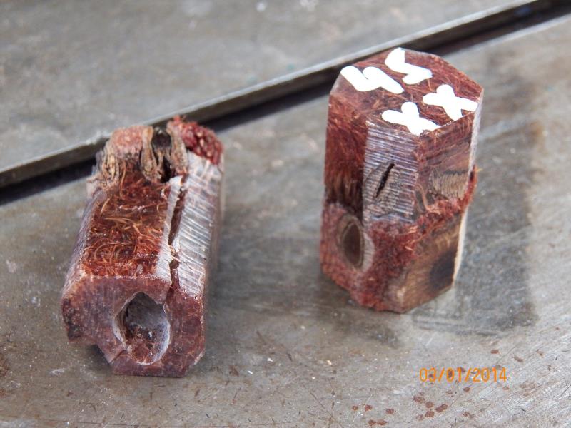

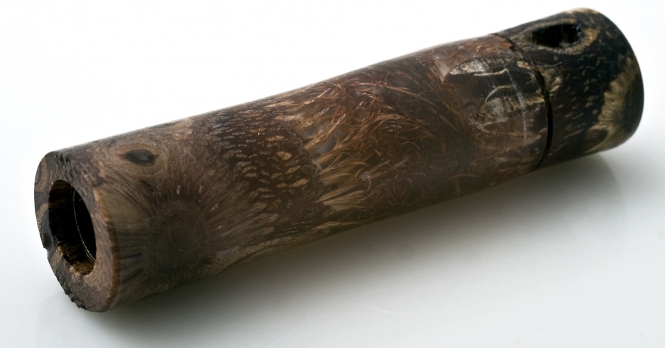

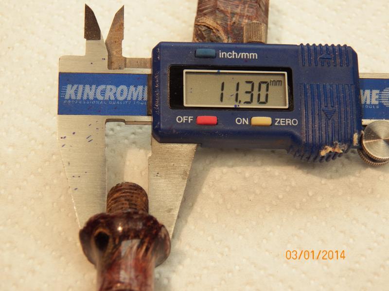

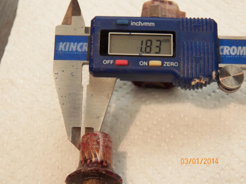

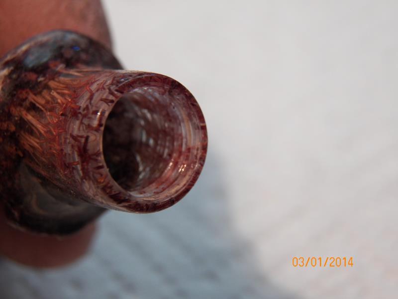

Anyway, I have attached the 2 small pieces I received as requested, one was cut to size (his size) but nor worked on, the other was the piece that he worked on and made him to decided, they were no good...!
Is not really important but, you can see how the poor blank piece was butchered, just to drill a small diameter hole in it, you make your judgements...!
The other piece though, I though is use it to demonstrated that, yes, you can cut threads in these blanks, even if not stabilised, I used the 5 cup CA to replace what the Cactus Juice would do and use it also to maintain the blank strength and integrity, right to the end.
This doesn't mean that the work was a delicate one however, I used only one size drill bit to drill the hole required for a set of 12mmx1.5 taps
I never picked the side for each end, you can see that, one end has the blank's identification which means, half is pod the other half is the pod's hairs and resin so, I could have easily done it the other way around, it wouldn't matter to me...!
The point of this demonstration is that, yes, is possible to cut threads, it is possible to make a full kitless pen out of these and they don't have to be stabilised but it would help however, I don't think these blanks are "ideal" for such way/style of making pens...!
I had done many tests with these blanks, I never though in cutting threads on them but, I have only used that small piece that was returned as no good, with its twin half not looking that good at all, I wasn't going to waste a full blank for this test but, I have many samples that I rounded that I could easily use if I didn't have this small bit.
The only thing I didn't have was the end tap to cut the inner thread right to the bottom, my sets only comes with the start taps, no intermedium no bottom taps so, I wasn't able to cut the threads properly on the female piece/end...!
I was going to separated both ends and screw them together, as I know they would work perfectly but, I was running out of blank to do much more, separating the 2 pieces would probably spoil the whole thing so, I left in as one piece, that is more than sufficient for what I have to say...!
Enjoy and reflect...!:wink::biggrin:
PS: I apologise for some of the quality of the pics, I didn't realise they weren't right only after I downloaded them into my computer.
Cheers
George

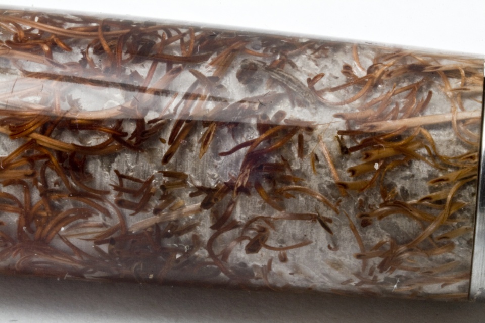

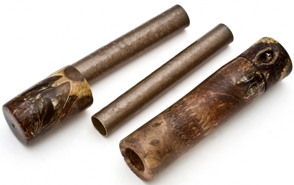

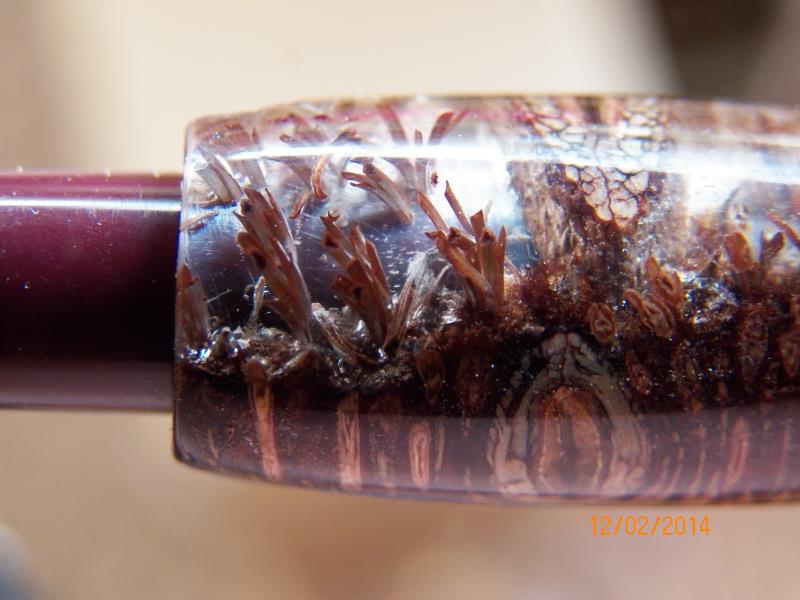

About half the tube is highly transparent so I figured the hammered look would work good. That's the darkest I could find. I did put it on very thin and no need to bore out the hole any for that as it fits in there fine with the 2 layers.
A tube develops from epoxy. Anyone want to guess which kit this is going onto? :)
What do you mean with "a tube develops from epoxy"...???
I need to experiment on these blanks gluing a brass tube the has been roughed out and then covered with 5 minute epoxy and some Pearlex dark brown colour (there have various), I reckon I can do all those steps in one single step and have a good colour coverage.
I also, when I want to achieve a sharp a clear colour coming from the painted tube, I polish the hole inside with wet & dry sand paper, just a very different effect from colour coming through unpolished resin...!
These are simply options, some people do them others don't and that is all fine by me...!
I can see the hammered paint colour showing in parts of that blank but, what I can't work out is why that blank seem to have had and extension added on the left end size, why is it a lot darker and has that groove in between the 2 colours...???
Cheers
George
The length of the tube is way longer than needed. The cut line indicates where it will be chopped then trimmed to size. The white marks is more closer to where it be.
The hammered effect did clear the opening with minimal effort. I used my E-120HP epoxy on the tube which means that tube is not coming out, period.
Also the epoxy is not dry and the tube was moved after the shot was taken.
Perhaps this is more like what you were expecting?
I trimmed the ends and did some clean up on the outside. Sanded some but not that much, the shop is -11C right now and the propane heater that I use ran dry.

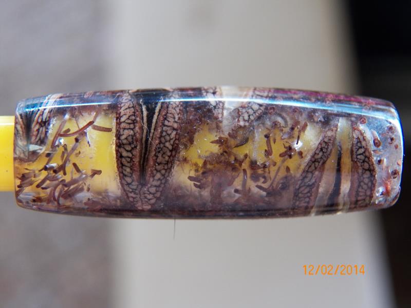

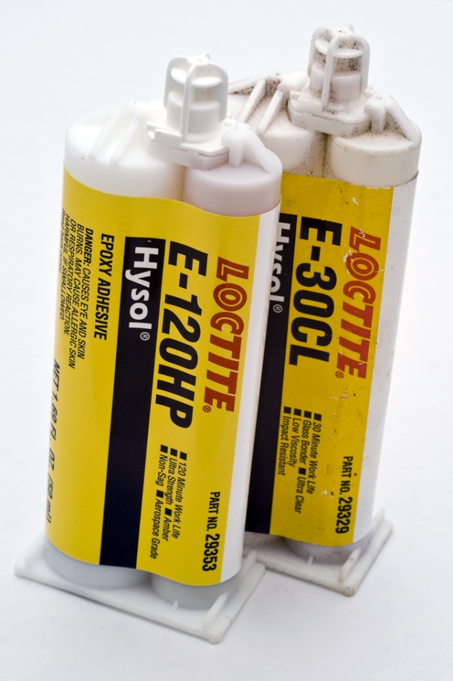

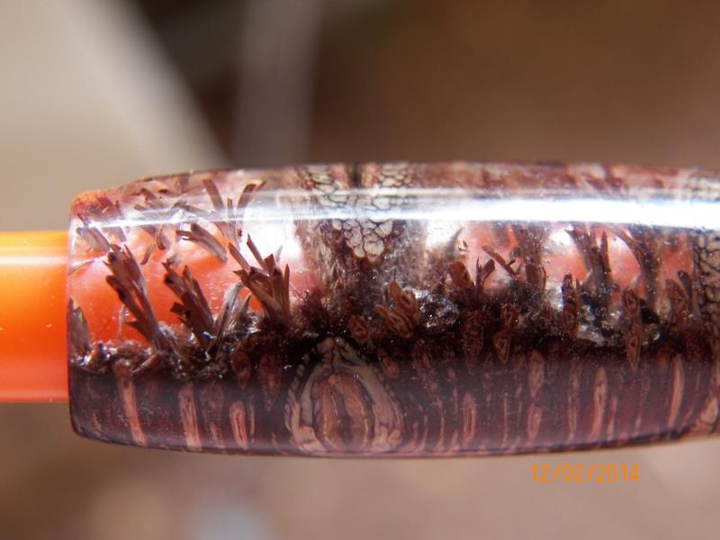

One thing of note. I used the wrong bottle of epoxy when I put in the tube. I should have used CL instead I grabbed the HP. CL dries clear while HP is a cream color.
attachment.php
See the difference in the bottle? Yea, learn to look better next time :)

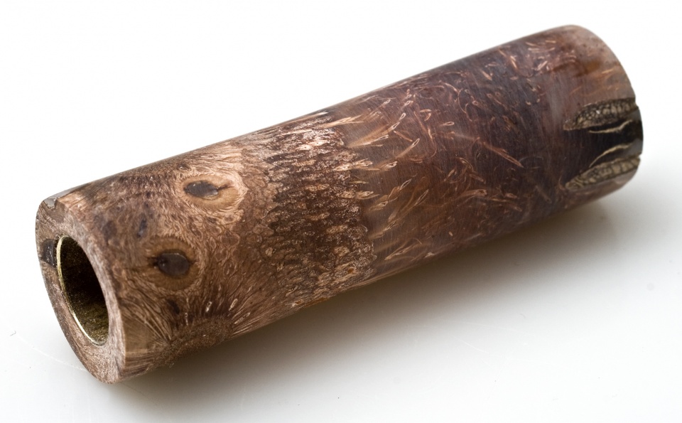

Tho not terrible it does present a good option to evaluate how my tube insertion method holds up under contrast. The tube is painted and the epoxy is a contrasting color.
attachment.php
attachment.php
attachment.php
attachment.php
We can see some spots where the epoxy is thin and others it's thick. This happens to be a gap filling epoxy.
Also goes to show that yes it is very viable and possible to color the epoxy and not paint the tube or the blank, some type of pigment based or even food coloring perhaps.
Overall I think this has been a good test and a good visual show as to what these blanks are like and how best to work them. Perhaps this would reduce problems and avoid mistakes for others as we have documented a good range of topics on this thread :)

Hum Ed, that is just horrible...! that epoxy did certainly spoil everything for a tube that was painted brown, sorry...!
It would be good to use kits that do have some "meat" left on the barrel, that would be a benefit for sure and as I mentioned, a dark brown powder colour in the clear epoxy may just be sufficient however, in cases where I want the colour I painted the tube or on reverse painting, to show sharp/clear through the clear resin, I drill the hole 1mm smaller and then polish the hole inside with wet and dry sand paper, going through the grits until you see crystal clear, that is when paints such as the hammered paints do a phenomenal job.
I may have to do one myself to exemplify and demonstrate the differences...!
Sure, every piece of information provided on this thread, can only be a help to those thinking and work with these blanks, out tests show only a few details/examples of the possibilities, there are many more...!

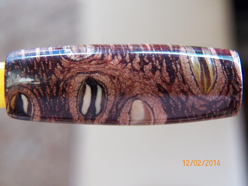

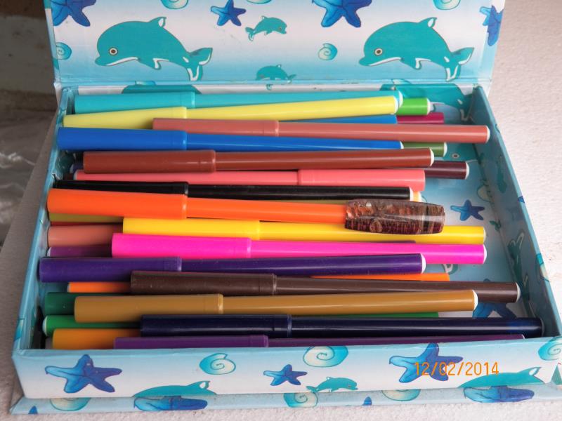

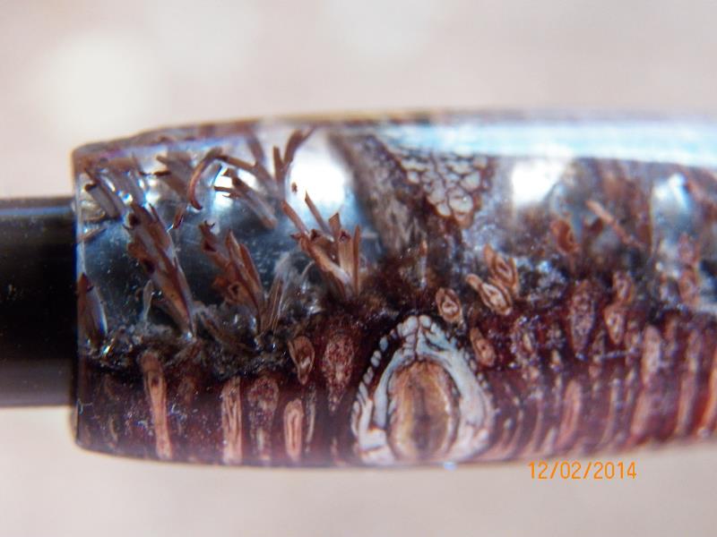

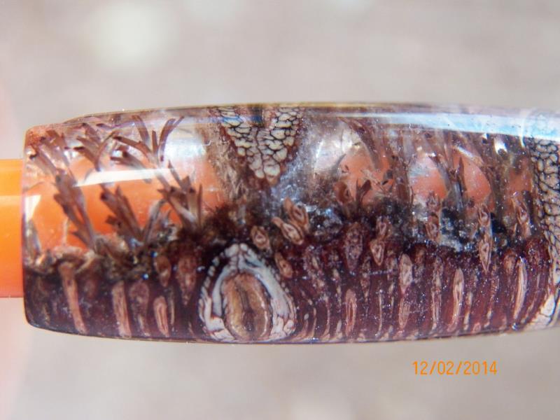

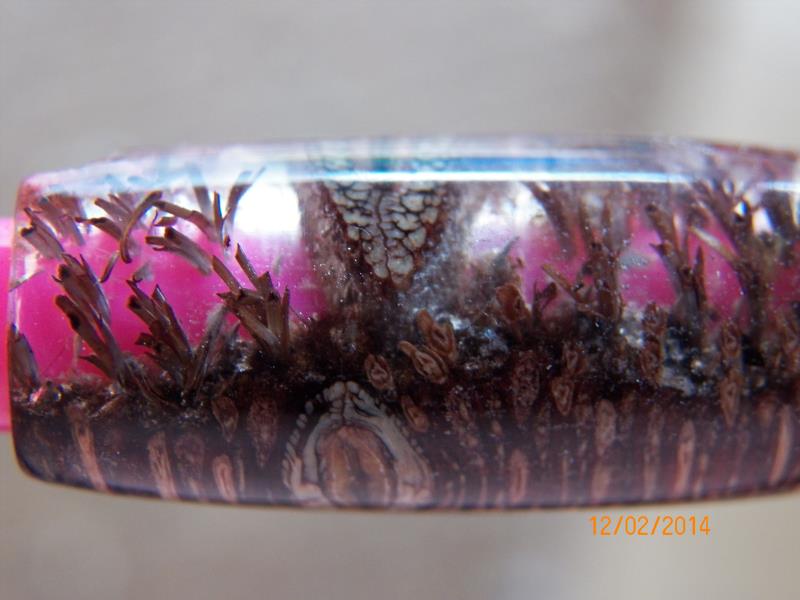

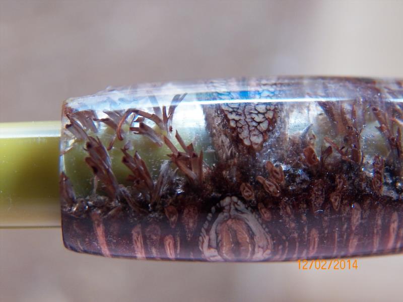

Selecting the colour for tube painting...!
Hi peoples,
I have had these pics and samples taken weeks ago, that I got convinced I had already posted it here but obviously, I should have done it all on my sleep and while in Gaga land, or something...!
Anyway, what I wanted to show you all, is a system that I worked out, helps to decide what colour to paint a tube with or reverse paint the blank, depending on what you are working on that you known, will be too transparent.
In this cases and because the main issue in this thread is the Banksia Hairy pod Resifill blanks, I use a off cut I had to demonstrate what the system is about.
There is no point is saying much more as anyone can see that I use for colours, these are cheap and anyone with kids will have a good supply of empty or dry of these markers, no doubt...!
Just a thought...!
Cheers
George

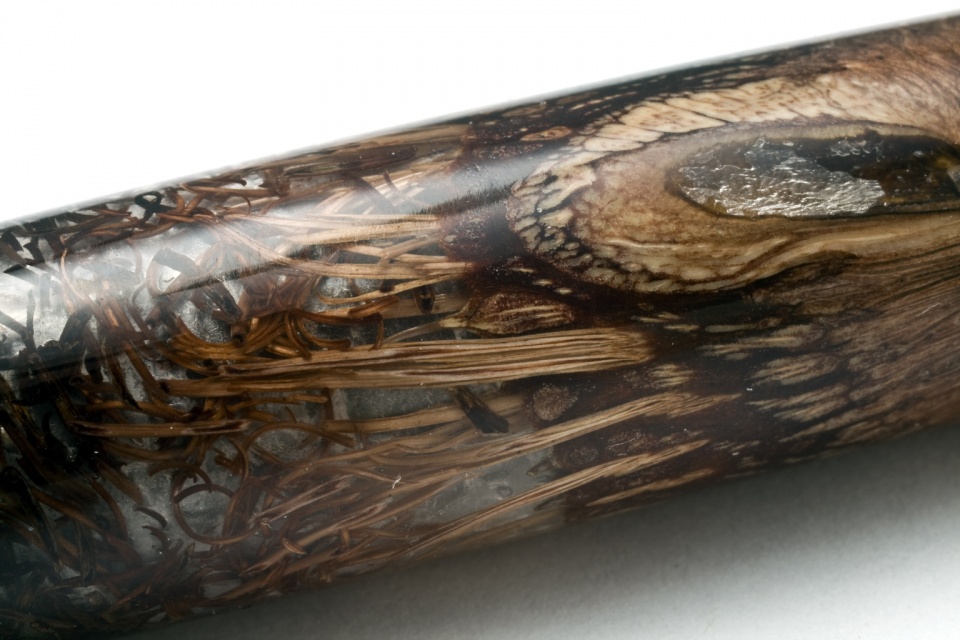

Can we say snow globe?
Sure Ed, you can call it that, I never though of it but, its the same principle as is clear casting with only one different, snow globes can move, swirls and offer many other effects while clear casting, everything is a still, as a "door nail", as we say here...!:biggrin:
Interestingly I was looking for examples of snow globes and I found one that I didn't expect, its funny and smart so, don't get all offended with it, its only a joke, right...??? here
PS: Hey, that only a snow globe, huh...???:wink::smile:
