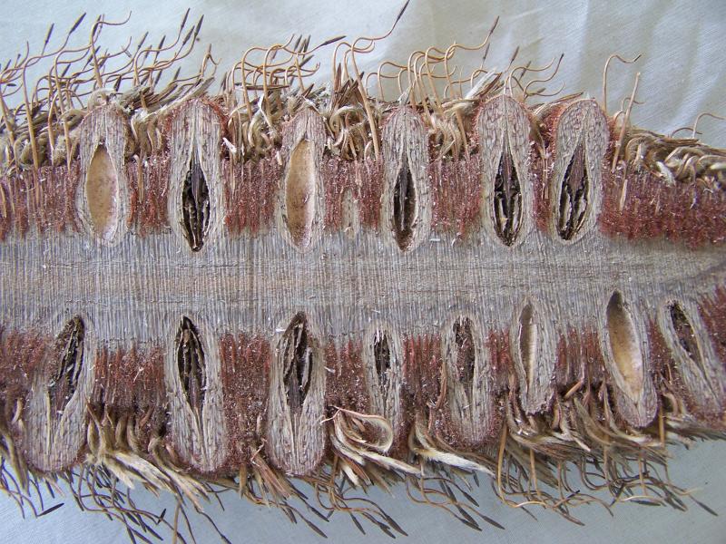

Hi,
I don't mean to step on anyones toes but the seed holes do not always go right through the cone.
This one is called Banksia Sceptrum and clearly the seed holes only go part the way through.
The cone is 9in long and 3.25in across the seed pod extremities.
FYI.
Bob.

To add to Bob's... if you select smaller pods, the seed holes are likely to reach the core closely enough to be useful for inlay once you drill it for the brass.

You are right Bob, they don't go all the way, but it is proportional to the banksia nut's size. On your giant banksia the gap is large, but you don't make a pen out of a whole Banksia grandis seed pod, they are usually made from segments of those pods. With the smaller sized ones I use to make pens out of, the holes go almost all the way to the centre, or at least the gap is small enough such that it is drilled out for the tube.
