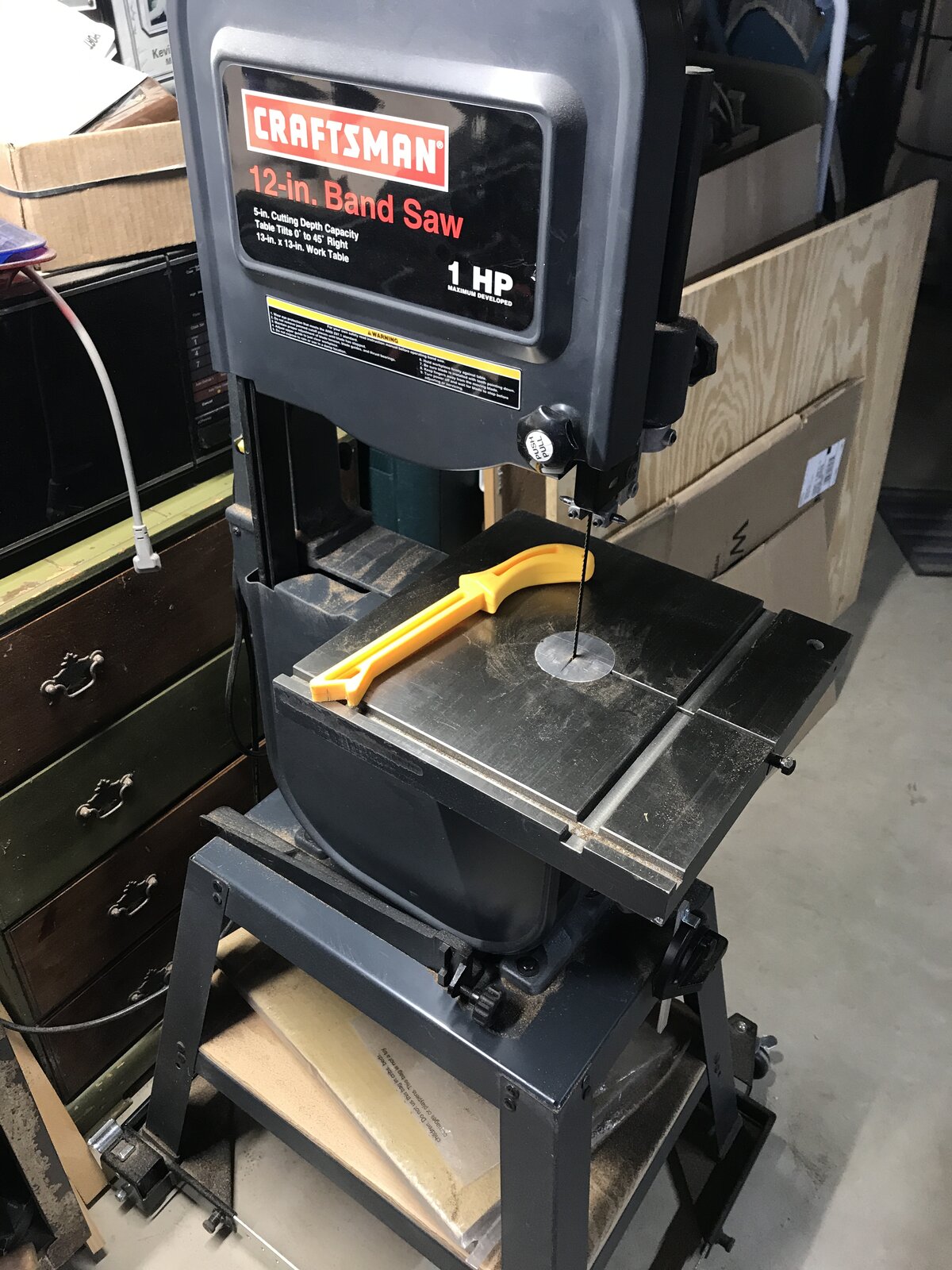

I have owned several bandsaws, and none of them really did well for me, for a variety of reasons. I had an older Powermatic 14", but it was so big and heavy, it took up too much space in my small shop (even when I had it on wheels.).
Next, I had a Grizzly 14", which was much smaller than the Powermatic, but it just felt cheap. The doors rattled when it ran. I have numerous other Grizzly tools (table saw, drill press, sander, Air cleaner, etc), so I like the Grizzly brand, but the saw just bugged me. Even though it was smaller than the Powermatic, it still seemed too big. I did not want to go to a 10" Benchtop bandsaw, because I wanted the option to work with larger stock.
I finally got my "forever" bandsaw - a gently used 12" Craftsman bandsaw. I put new tires on it, and a new blade, and it is excellent. It is large enough for anything I have needed (so far), but easily rolls out of the way when I am not using it.
I was never crazy about the "Square" Craftsman bandsaws, so when I saw this more traditional "C" shape saw, and the condition it was in, I snatched it up. It was only $200, and I have had it for about 5 years now, and use it almost every day.
I guess my point (I do have to get to the point, right?) is don't disregard a good used tool. Check craigslist, Facebook, maybe even eBay.
oh, and I'm pretty sure Shop Fox is a Grizzly brand.

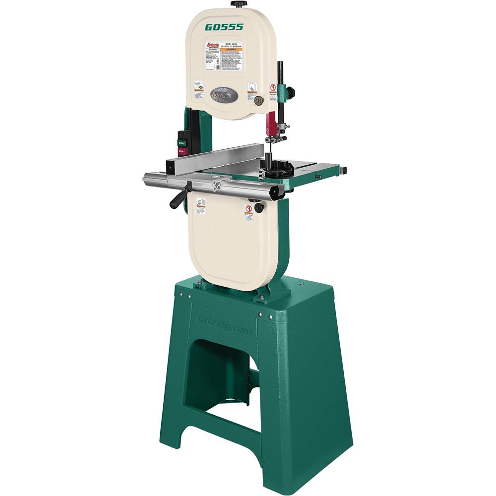

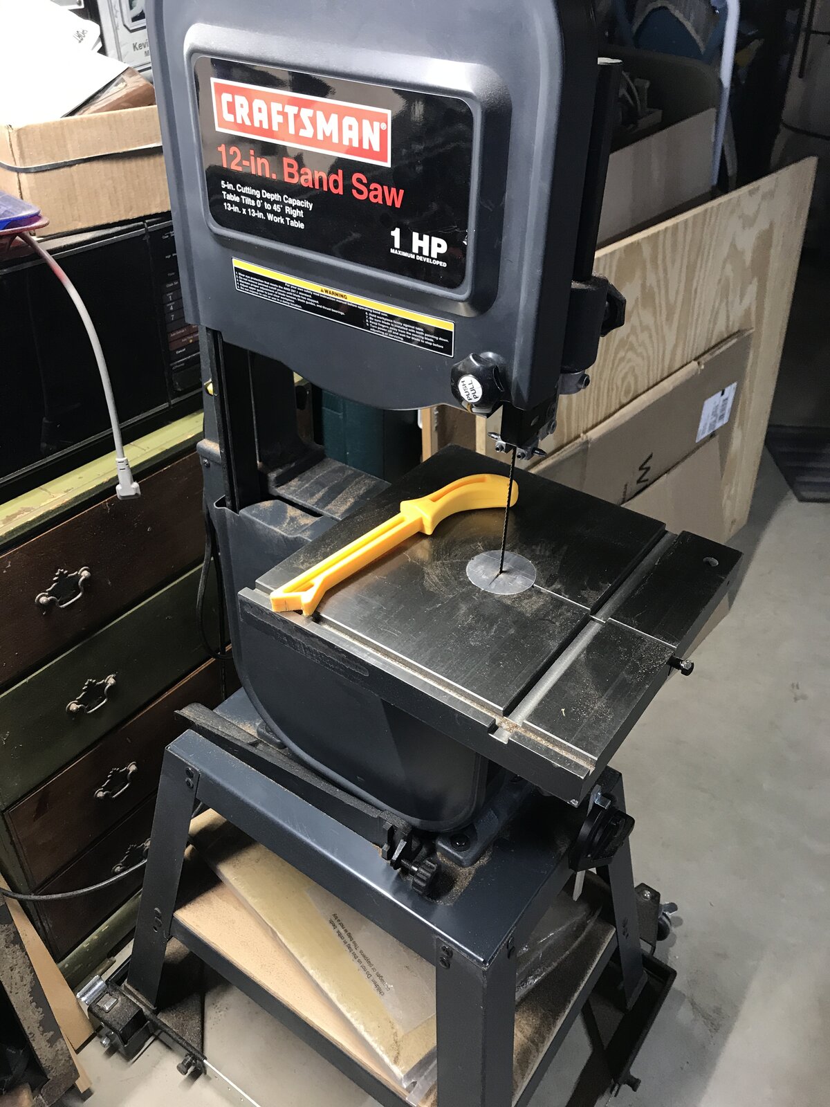

I've had my Grizzly G0555 for 17 years and couldn't be happier with it. I've done several mods to it to make it better but it was pretty good right out of the box.
I like the specs of that Rick. A little more than I wanted to spend...but not much. It would give my capacity to do other wood working stuff also. I'll look closer at that one. Also need to talk to you about a tool rest :)
