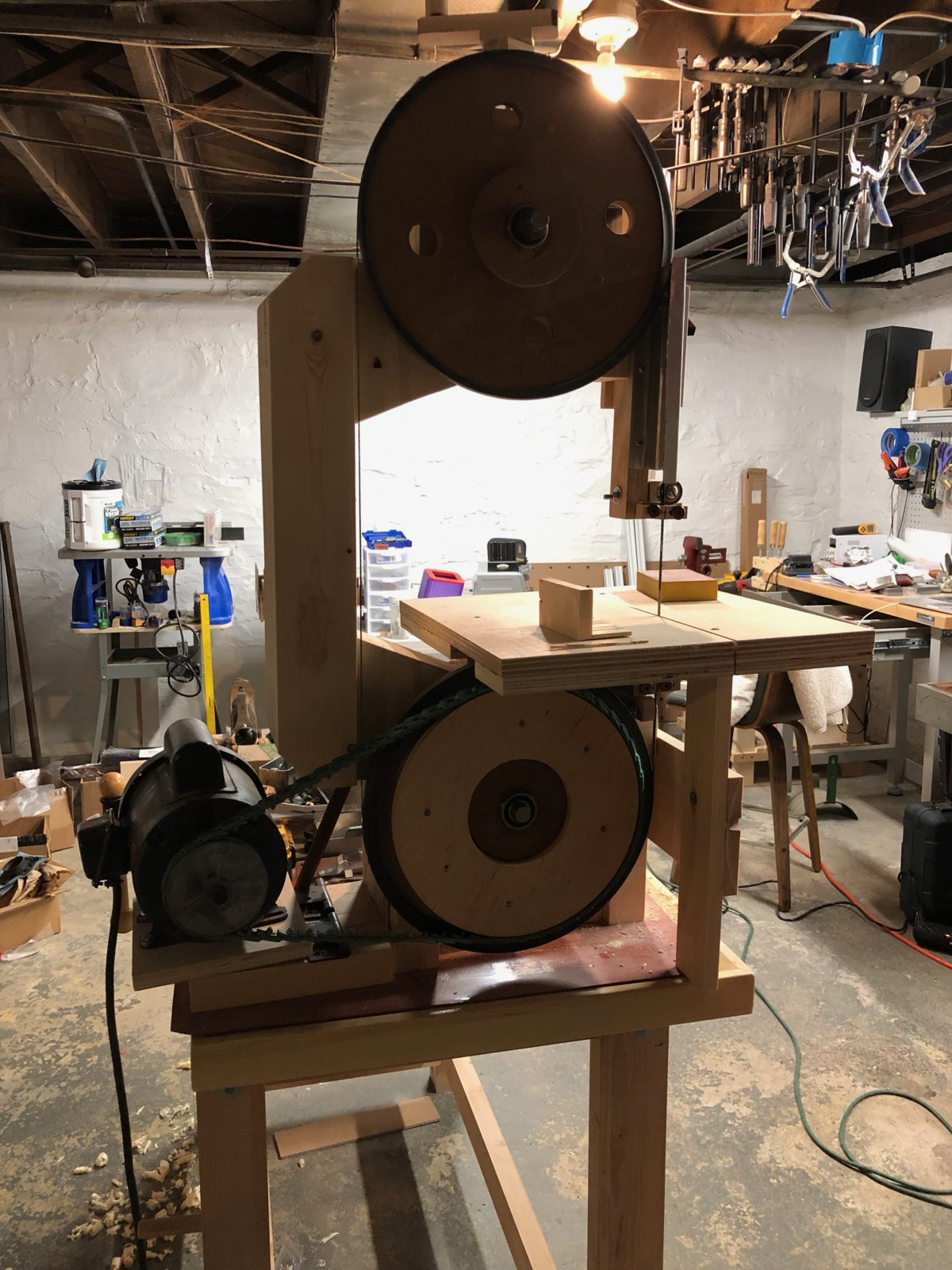

I recommend this one: (I realize this doesn't really address your question, but building your own is a great learning experience and will get you more capacity for the dollar than can be had buying new. This is a 14 inch that cuts pen blanks, prepares larger pieces for turning, and can do some resawing as well. Takes time to build but depending on how well you can scavenge a motor and a few other parts, this was pretty cheap (less than the Wen saw). The frame is build from cheap scavenged lumber too (no hardwood required for most of it).
