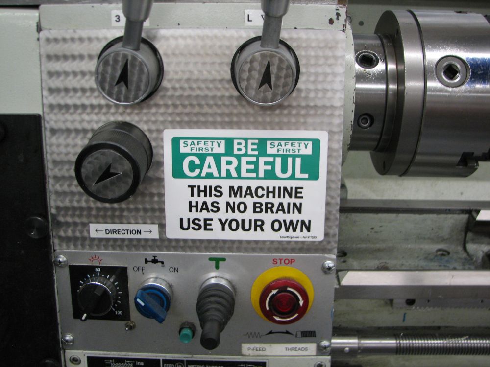

I've never had a bandsaw that cut straight, it's up to the operator. You can adjust the fence at a slight angle to make up for the blade drift but a bandsaw is really not made for straight cuts...IMO.

Here's a warning label I have on my machines... :) :) :)
Love the jeweled panel/knobs behind it... did it come that way, or did you do it yourself?

Or, in the case of my bandsaw (a Taiwanese Delta 14 knockoff), the fence is the source of the problem. The damn thing's a degree or two off from the blade & miter slot, and it's not adjustable. I keep meaning to fab up some sort of sled to get around the issue, but somehow it hasn't quite happened yet.
I made them myself. All I had was aluminum and I'm not happy with how it turned out, aluminum is too soft for engine turning IMO. I'm going to replace them with stainless steel so it will SHINE!!
