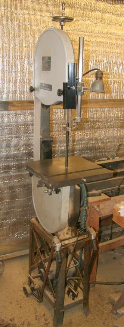

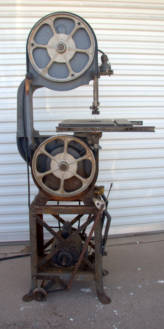

This is what it looked like when I got it. I put a riser kit on it, found covers for it on ebay, put cool blocks, ceramic thrust bearings, a big spinner on the tensioner, etc. My dad got it from my grandfather when he died, and I got it when my dad died. My brother found the original covers for it about a year after I got it, and I have those on it now. The guys on old woodworking machines (OWWM.ORG) were a great help. They were who told me about Iturra Designs.
The only thing I have never been able to find is a cover for the belt.
