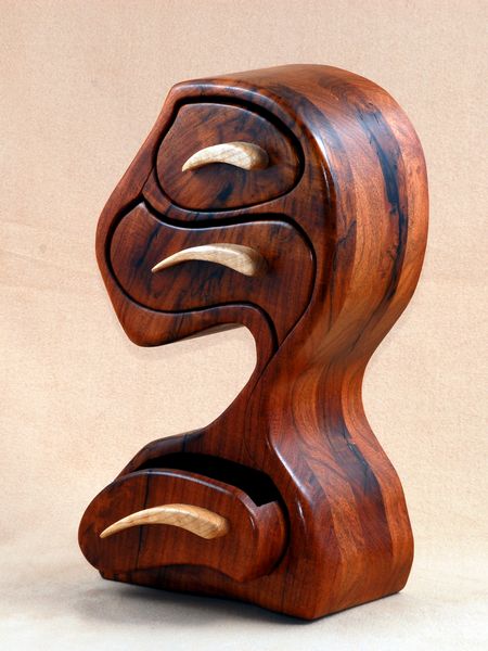

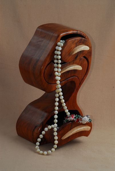

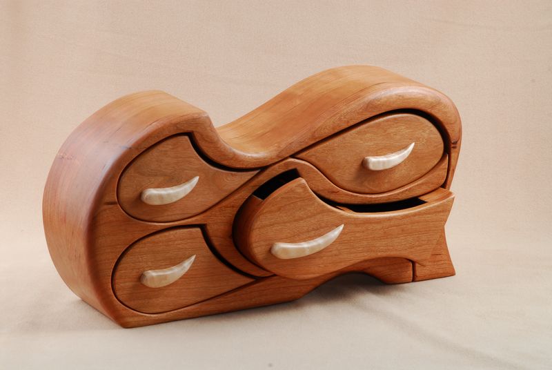

These are great fun for a change of pace from furniture making and pen making. The taller is made from some very old mesquite wood; it took a lot of sanding, epoxy, filler and more sanding to fill some of the character is this board, thus allowing its transformation into this box; and the shorter one is made of cherry. The drawer handles are figured maple.

Do you have a picture of the inside of one of the drawers? I'm curious about how the drawers are made while preserving the drawer face.
I'll post one later - but the front and back are actually cut off (1/4" to 1/2" thick depending on design and preference) the drawer's inside is then cut out with a band saw, the front and back are then re-attached to the drawer (after the drawer inside has been sanded).
Makes perfect sense. Thanks a lot. Something new to try.
