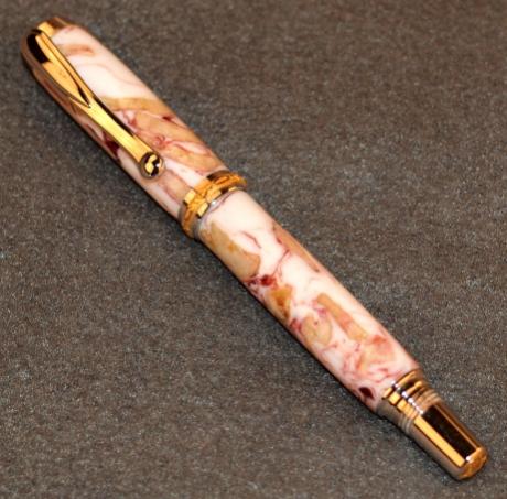

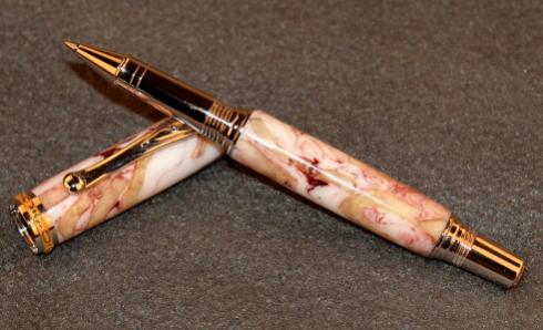

This is Banana chips cast in a vanilla/strawberry mix. Not the most difficult turn I ever did, but not far from it. I am so used to turning fast, but these can not be turned fast, so the first blank I blew to pieces. They had to be spun down, then thin CA soaked in to the bananas, then spin some more then glue some more and that along with a very sharp chisel and very light cuts gave me a really cool pen! I was rather surprised at the blanks I made. I pulled them out of the pot and they looked pretty normal and cured just fine. I had them sitting on the work bench. The next day the work bench was all wet under the blanks. I wiped it up wondering what was up. Then when I cut a blank in half, the end of the blank, oil started pouring out of the bananas. When I drilled it, that was no problem but the blank was full of oil inside. Had to run a paper towel through the blank before glueing it. All that oil had me nervous about making the pen in the first place, but it was no issue with applying a CA finish over it. I have a theory that the banana compressed into the center of the banana pieces and then when un-pressurized, the bananas that were exposed released the pent up oil. When cut, same thing. Very bizarre. I had planned on making some extra's for Dawn, but being a difficult blank to spin, I am not sure if I should. It's not as difficult as turning chip board, but certainly comparable to turning pasta blanks.

Unusual for sure!! Its really pretty....I wonder if you will scratch your head or pick fleas like a monkey if you use that pen continually .... hahahahaaa....Love the colors!!

I'd use that pen for a while, Jeff. See if the banana pieces hold up in daily handling, or if the PR between them crumbles, for lack of support (even though you have a CA finish, I would have some concerns). IF all goes well, certainly we would like to make it available to other turners-----through some mechanism---don't want to say anything that turns into "marketing", :eek::eek::eek:you know???:mad::mad:
It IS a cool look!!!!
