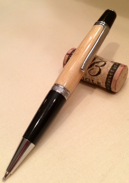

Hi everyone, I've been turning for a little over six months and this is the first pen I post. I post it because I find it interesting being made out of Bamboo. I acquired a piece of Bamboo and glued 4 slices together and came up with a 3/4 square blank. Anyway, below is a picture and I hope you enjoy it. If you look closely there are some reddish tone in the middle. It's a Wall Street with CA finish.
Of course C&C are greatly appreciated.
Thanks all for contributing to the forum. This forum is the reason why we create what we do.

Nice work for being so new. I've just ordered my first bamboo blanks. How was it to turn?
Wasn't that bad. The bamboo I used was soft and I was affraid that it would splinter toward the end. I left it a bit strong and sanded to measurement. I have another peice in which I will segment and break the plain white space. I'm also not too fond of the wall street kit. This would probably look better on a Gent where more Bamboo would show. We'll see. Trial and error; that's the fun part.
The bamboo is fairly porous. You might try coating with a little thin CA every now and then while you're turning. It fills the pores and hardens the blank helping to prevent splitting. It also stabilizes the glue-up on your segmenting if there are any little gaps that might come apart while turning. Nice job!
I purchased a large cutoff of 3/4" bamboo flooring from a local lumber dealer for a very reasonable price. I've turned several pens plus lots of other turning projects from it.
